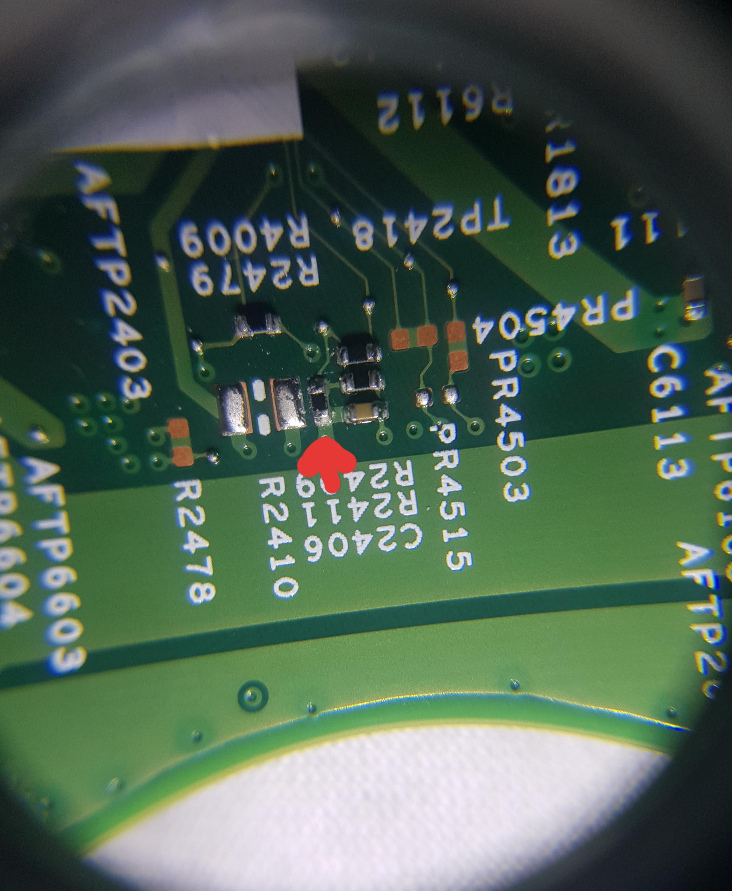

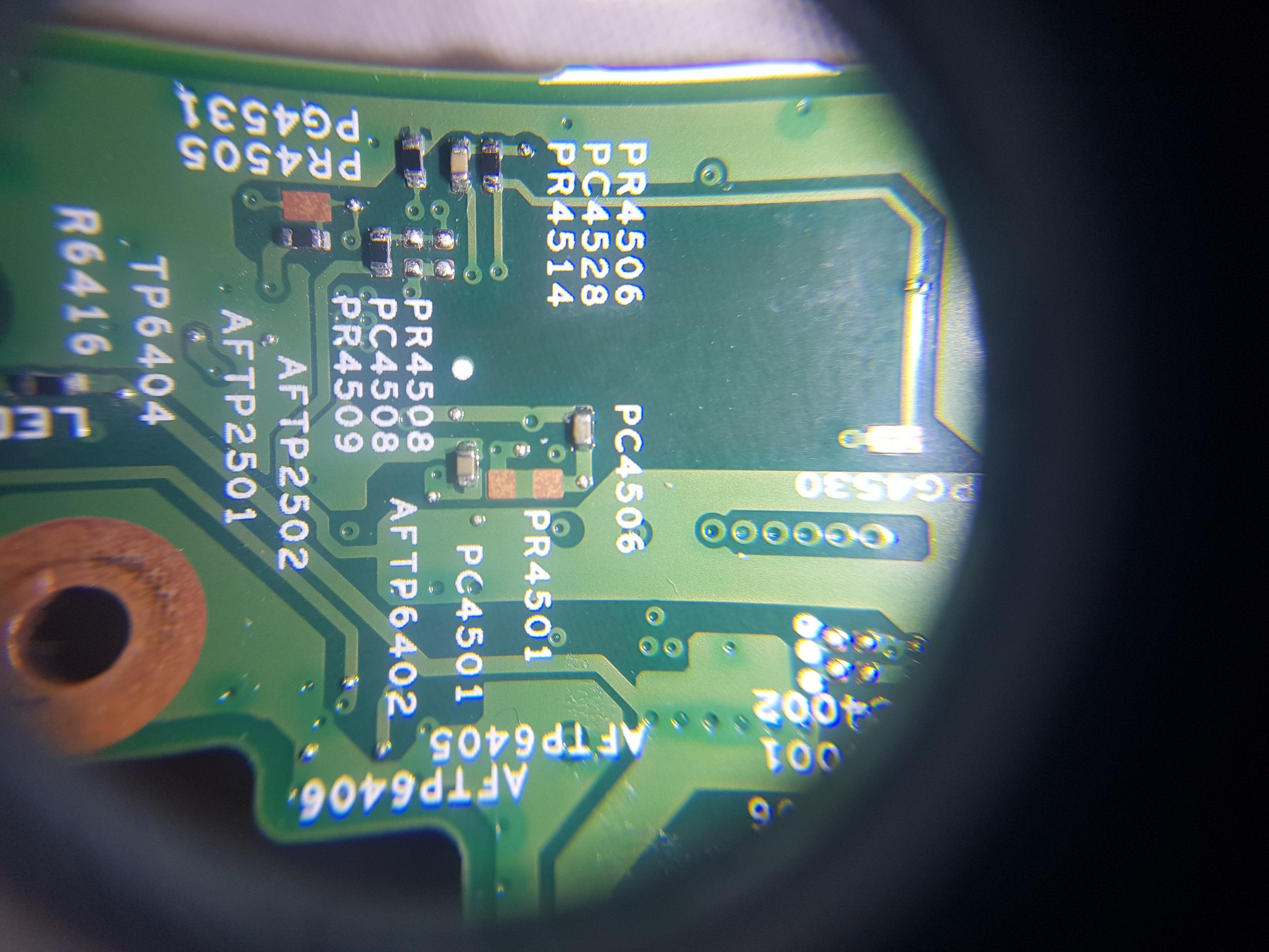

    Hi
    Lenovo ideapad 710s-13isk i can see 5vALW but cannot see 3.3VALW
    i can see that EN1 present but EN2 is not
    Can you please help find fault ?
    attached schematics abd photo of board en2 area

    Re: Lenovo ideapad 710s-13isk no power
    Please onfirm whether 5V_EN is indeed present or not
        But at PU4501 Pin11 (3V_EN) is missing? Weird, but can't be hard to solve since it comes the missing enable comes from 5V_EN via PR4515. So find PR4515 and check voltage at both sides.
        Do you have a short to GND at 3V_EN by any chance?
          I think i made mistake in the problem description
          Please let me try again
          on PU4501 pin11 (EN2) is present 20v
          on pin12 (EN1) not present 0V
          I think I found PR4515 it has 3.3v on on side, its resistance is 0.33M ohm
          attached photo
          • Sephir0th
            • Oct 2020
            • 1260
            I think I did a mistake too. So it seems like PR4515 is missing by factory and 3V_EN will be pulled up from S5_ENABLE, so probably only AFTER power button press and for this reason no issue at this point.
            Check whether S5_ENABLE is indeed not present, whether you have 3.3V at the power button and whether the power button itself works as supposed to be.
