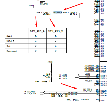

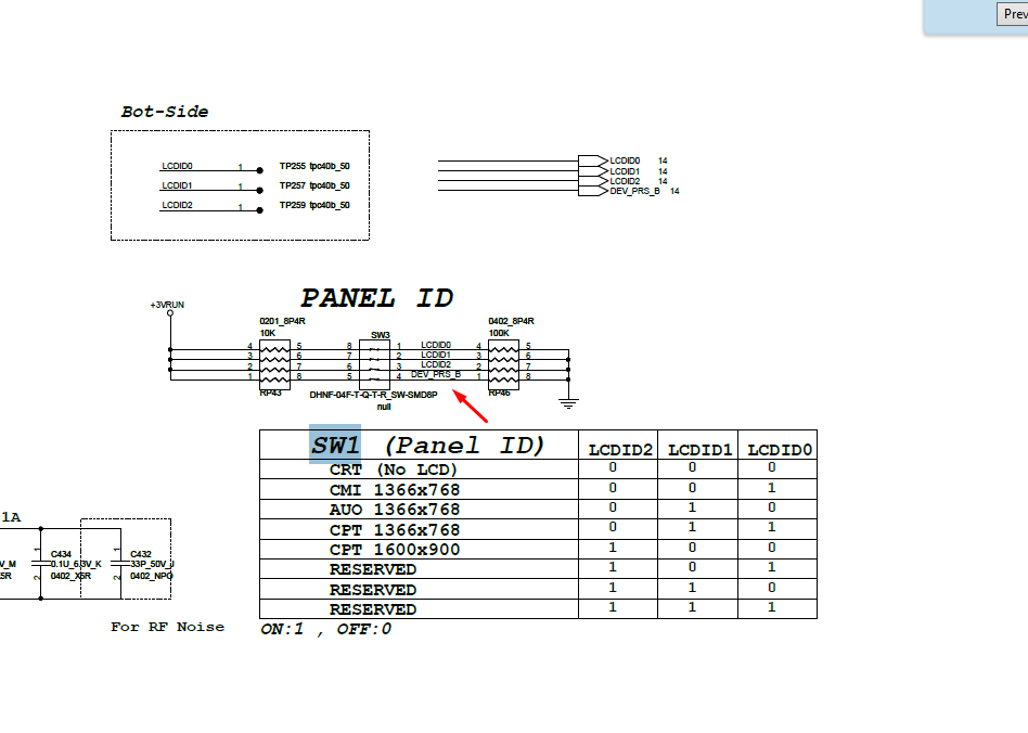

    Hi
    there is a sony vpcsb (mbx-237 rev 1.3)
    As soon as it turns on The fan speed goes up.
    i heat gpu and flash clear bios But the problem was not solved.
    can any body help?
    Indeed, it can be related to the panel ID switch ?
    Thanks.
