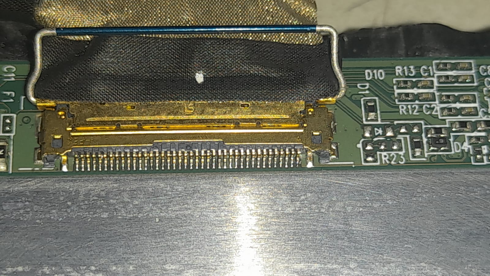

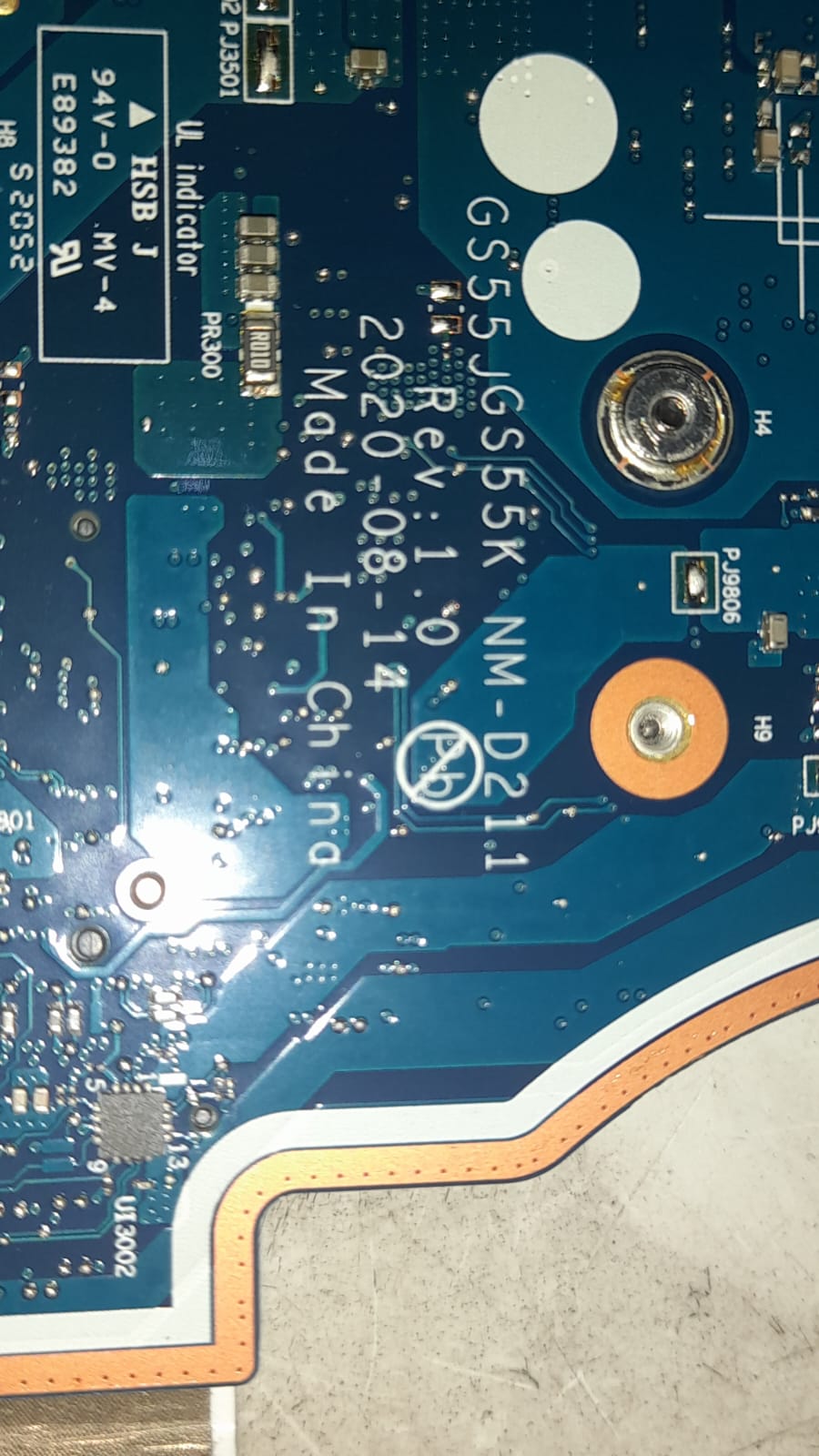

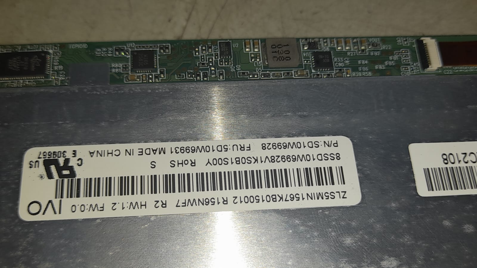

    I have a Lenovo Ideapad 5 15ITL05 laptop. It turns on with a video signal on the screen but without lighting. I tried a new screen but it gave the same problem.
    This computer uses the GS55J GS55K NM-D211 REV 1.0 2020-08-14 motherboard but I can't find a schematic, it also uses a r156nwf7 touch screen and I can't find where to test to verify if I'm missing any signal or voltage.

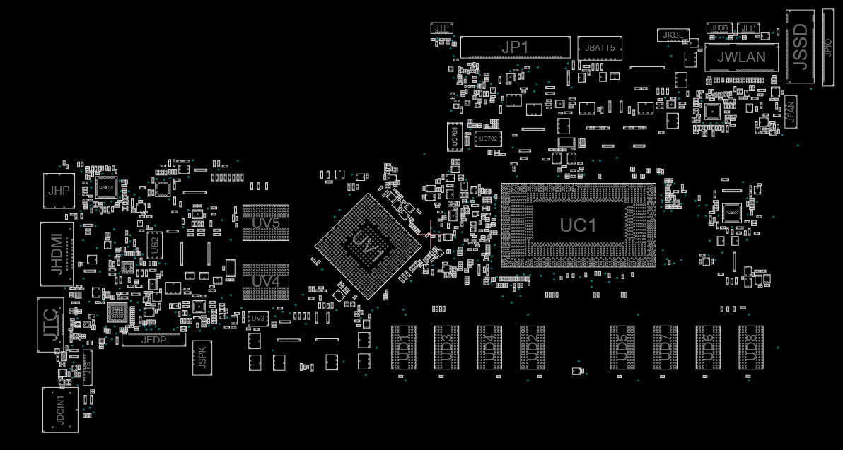

    Re: Lenovo Ideapad 5 15ITL05 without back ligth, Help
    Attached is the boardview file.
    Boardview ---> https://www.badcaps.net/forum/showth...03#post1217003

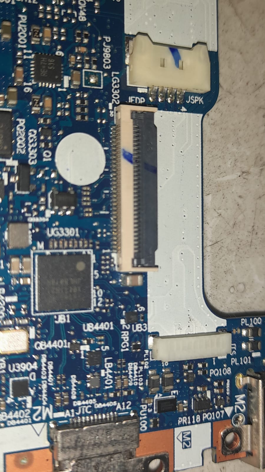

    check pins 1,2,3,9 of edp conector for voltage
        Thanks for your help, on pins 1, 2, 3 I have 0.4v on pin 9 I have 0v. I think the problem is the pwm signal. I'll keep checking, any advice is welcome.
          Hello, following the pwm signal, it seems to me that it comes from pch. I don't know what else I can do to verify because I don't have pwm
            as first u r missing backlight power on pins 1.2.3
              I have replaced the fuse fg3301 now I have 9V on pins 1 2 3 but still no backlight.
              In RG3317 on the side where PCH_EDP_PWM comes I have a short to ground

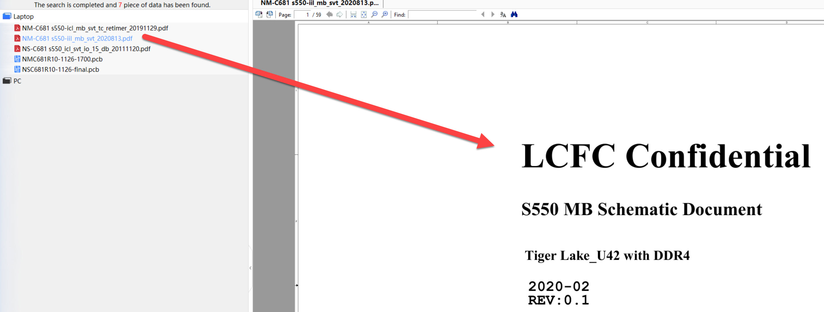

                      Looks like this one?
                      US $325.00 | For Lenovo ideapad 5-15IIL05 laptop motherboard GS557 GS558 NM-C681 motherboard with CPU I5-1035G1 RAM 8G UMA 100% test send
                      https://a.aliexpress.com/_mrKVgJk
                      • trepachka
                        • Oct 2022
                        • 429
                        Yes, exactly like that one.
                        • mon2
                          • Dec 2019
                          • 14239
                          See attached screen grab.
