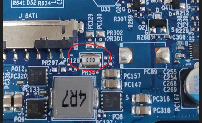

    board smd marking code 020?
    hi~
    board prs4
    0.02 register 0612 size?

    Re: board smd marking code 020?
    That's the current sense resistor of the battery rail. Never heard about one failing so far. So if it isn't missing from the board you should really think again about how to troubleshoot the issue.
      Regards
      The 19-volt line has the same 020
      Mega ohms at measurement, after r020 replacement and smd capacitor
