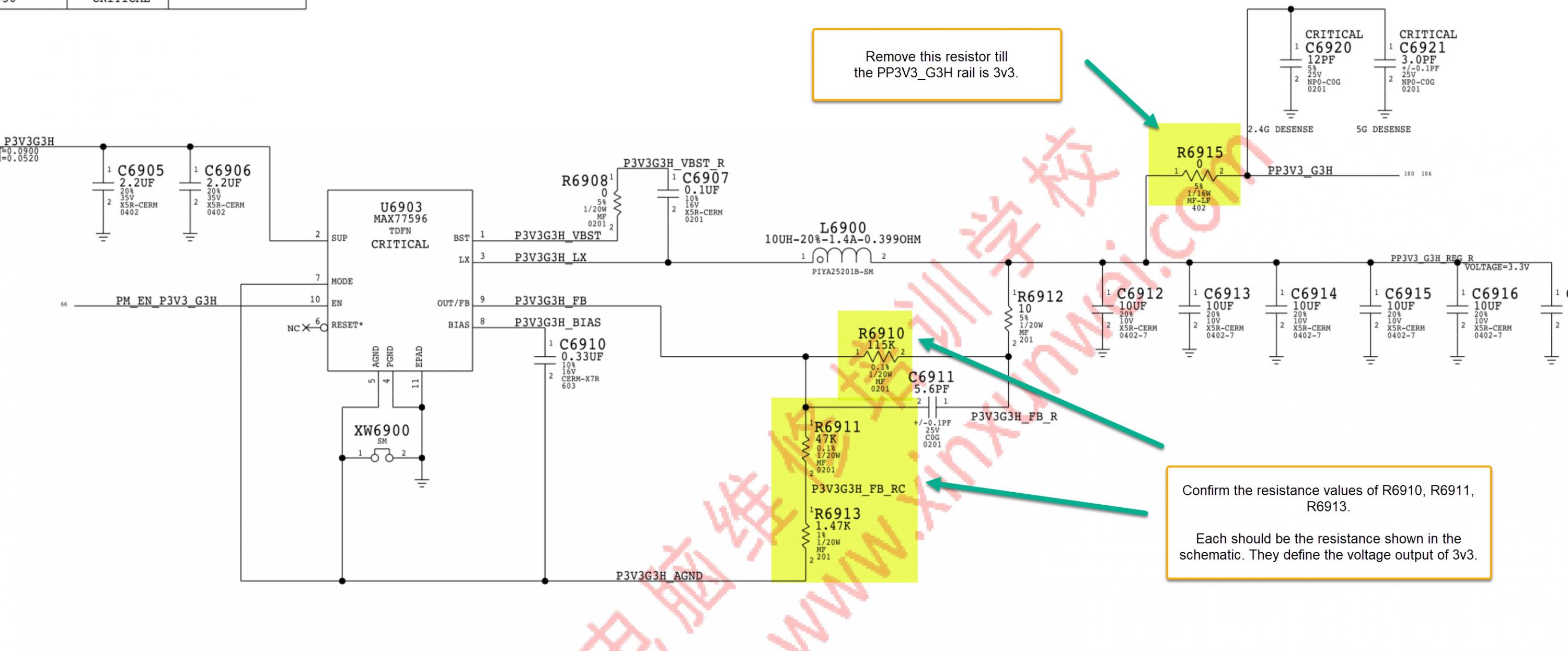

                    Thank you for your kind words. Lots of office work ahead.
                    See attached. The 3v7 on PP3v3_G3H is too high. It should be 3v3. Suspecting that the feedback resistors may be at fault.
                    Remove the resistor @ R6915 (do not lose it).
                    Then power up again and confirm the voltage is still 3v7. Then with NO power, review the feedback resistors noted in the partial schematic. These values must be the same as the official schematic to dial up the 3v3 voltage. Only after this voltage is normal, then place back R6915. Rossmann forum notes this rail should be 3v3.
                      #70
                      Re: Macbook A1706 EMC3071 (2017 Touchbar)
                      I hope you are well today despite your situation..
                      So, i remove the R6915 and i have 3.40V on L6900.
                      For the resistors, here are the measurements :
                      R6910 : 110kohm
                      R6911 : 110kohm
                      R6913: 47hohm (?!)
                      Strangely, the R6910 look like a capacitor. It's a white spare, not black as usual for resistor.
                      What do you think ?
                      Thank you

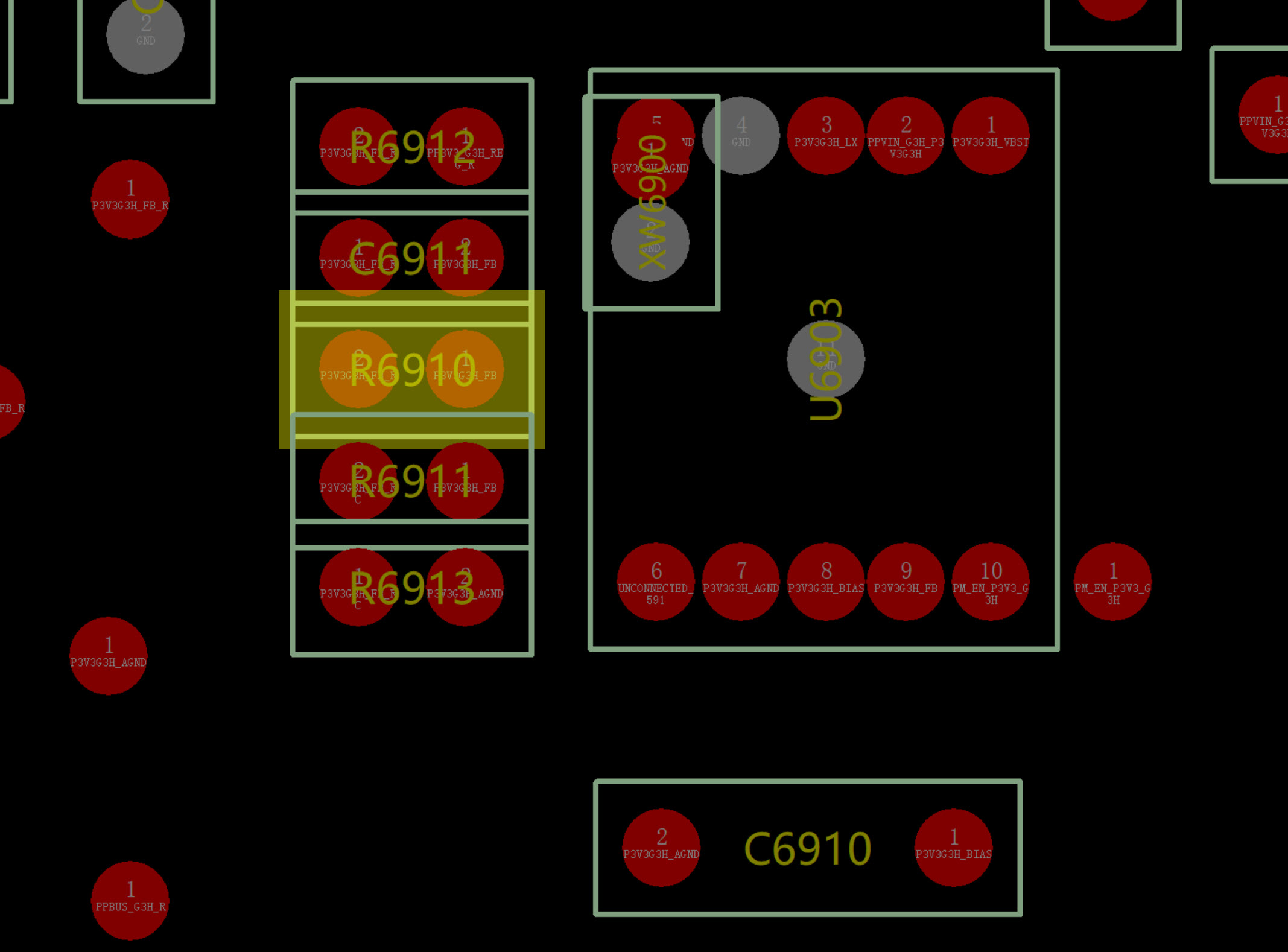

                        #71
                        Attached is the layout I see in the database for this logic board.
                        Can you confirm that yours is the same?
                        Are you using fresh batteries for your meter? It is recommended so that we can rule out the tool as a fault of the values.
                          #72
                          It's exactly the same as the layout. It have Resistor / Condensator / Resistor / Resistor.
                          I do a fresh mesurement :
                          R6912 : 12.2ohm
                          R6910 : 54kohm
                          R6911 : 12.95kohm
                          R6913 : 1.45kohm
                          Stranges values no ?

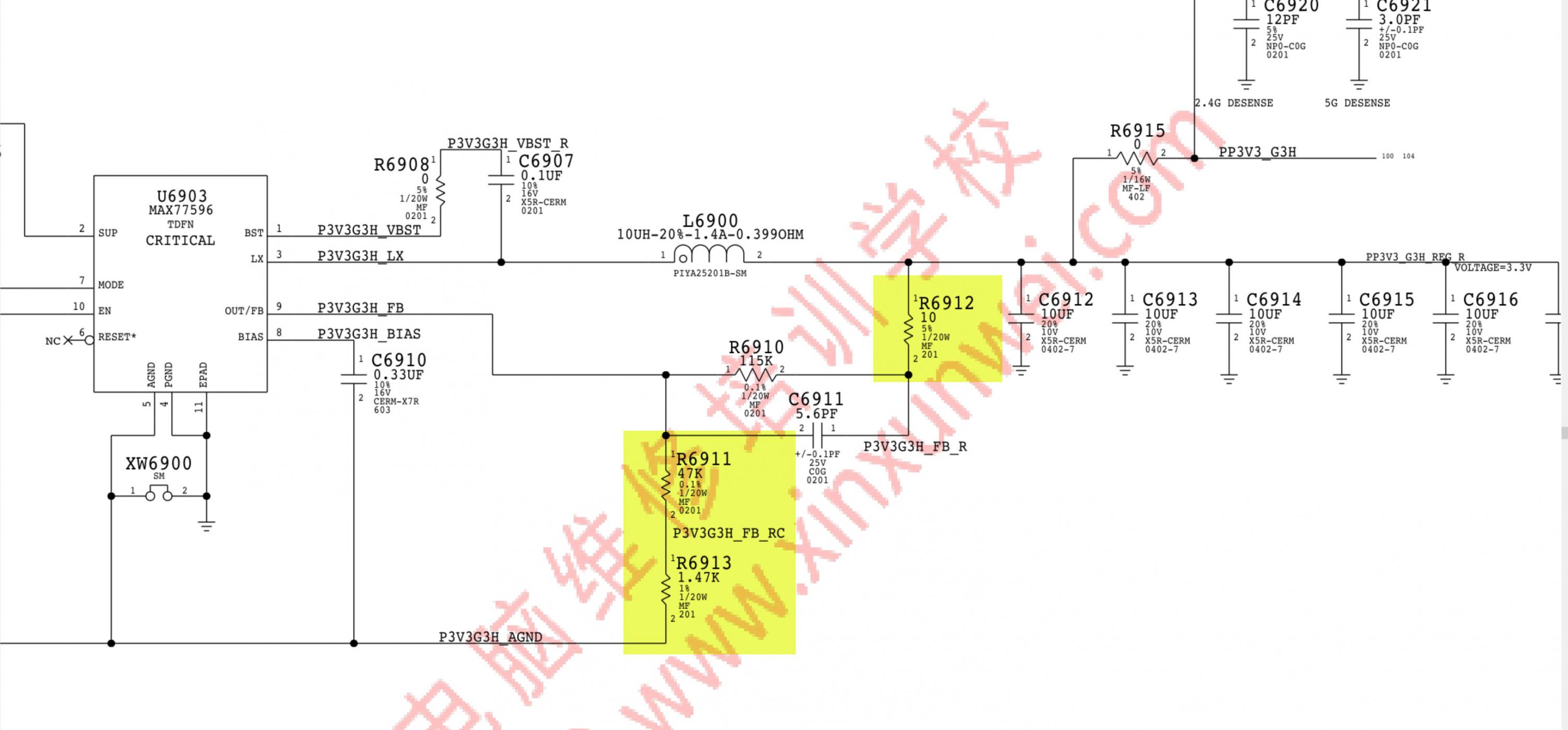

                            #73
                            Yes, only some of the values match.
                            With care, flux and remove R6910 & R6911 off the board. Check their values when the parts are off the board and on your table.
                            Will assume that the values in the schematic are correct.
                            So R6910 should be 115k (1% is recommended).
                            R6911 should be 47K (1% is recommended).
                            Other 2 resistors are fine. If you do not read these values after the resistors are removed, consider to replace them and measure again.

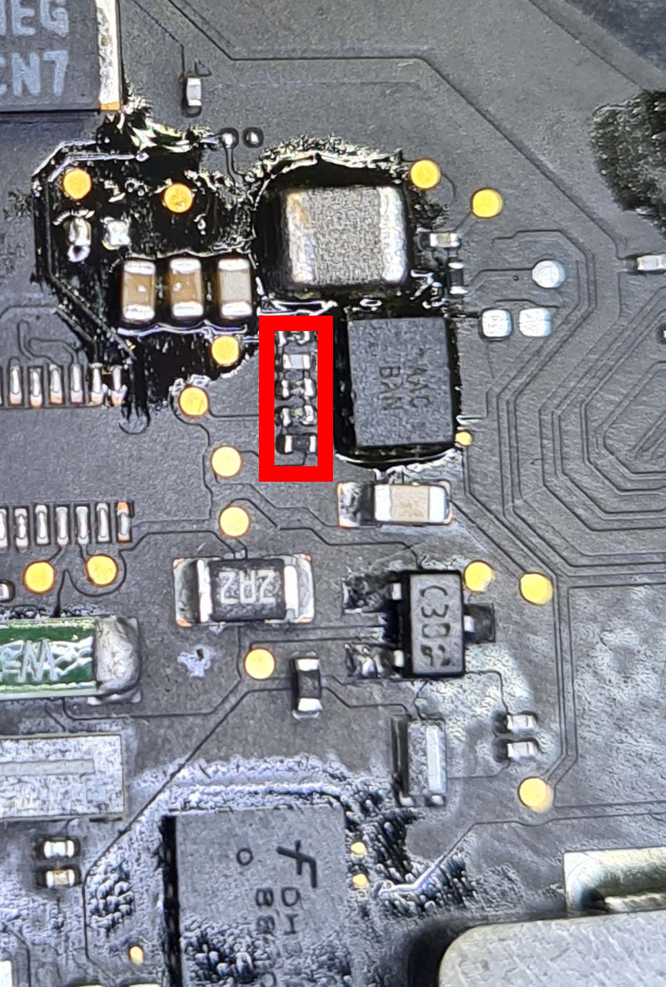

                              #74
                              I remove the resistors and out of circuit, they have goods values. If i replace them on board, the values return to my last measurements...
