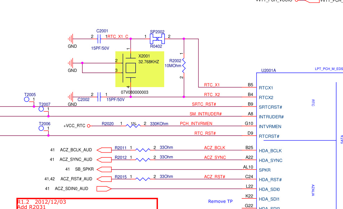

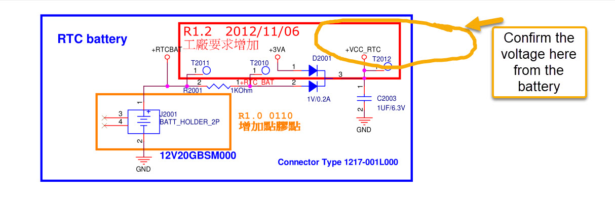

    See attached.
    Confirm that the battery voltage is reaching the RTC circuit.
    If the battery is confirmed to be ok - review the RTC crystal @ X2001 = 32.768khz.
    If available, swap from a donor board or source from a reseller. Be sure to source the same footprint / physical size for this crystal.

      RTC is 3V
      i'm hobbyist, i don't have equipment to measure freq. of the crystal. :\

              I do not think your rtc crystal is working. The crystal is very inexpensive and should be less than $1 usd on the market. You can share pics from your board but will be available on AliExpress.

                  Replaced the crystal, and it works like a champ.
                  Thank you guys!
