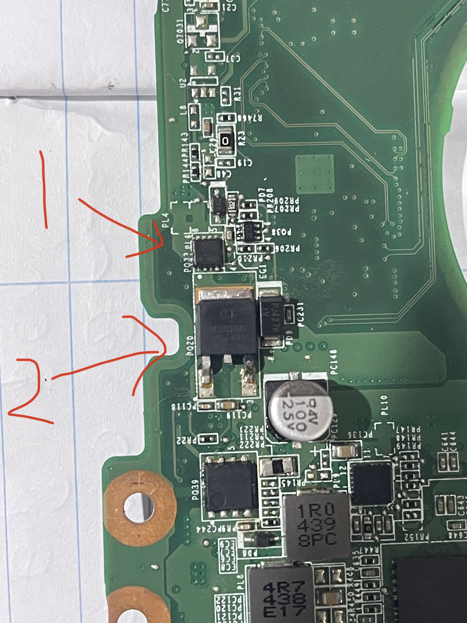

                      1st Mosfet = Source to Drain -----> 8.8kohm
                      2nd Mosfet (it only has 4 pins) = Source to Drain -------> 1.5ohm
                      see the attached photo also please

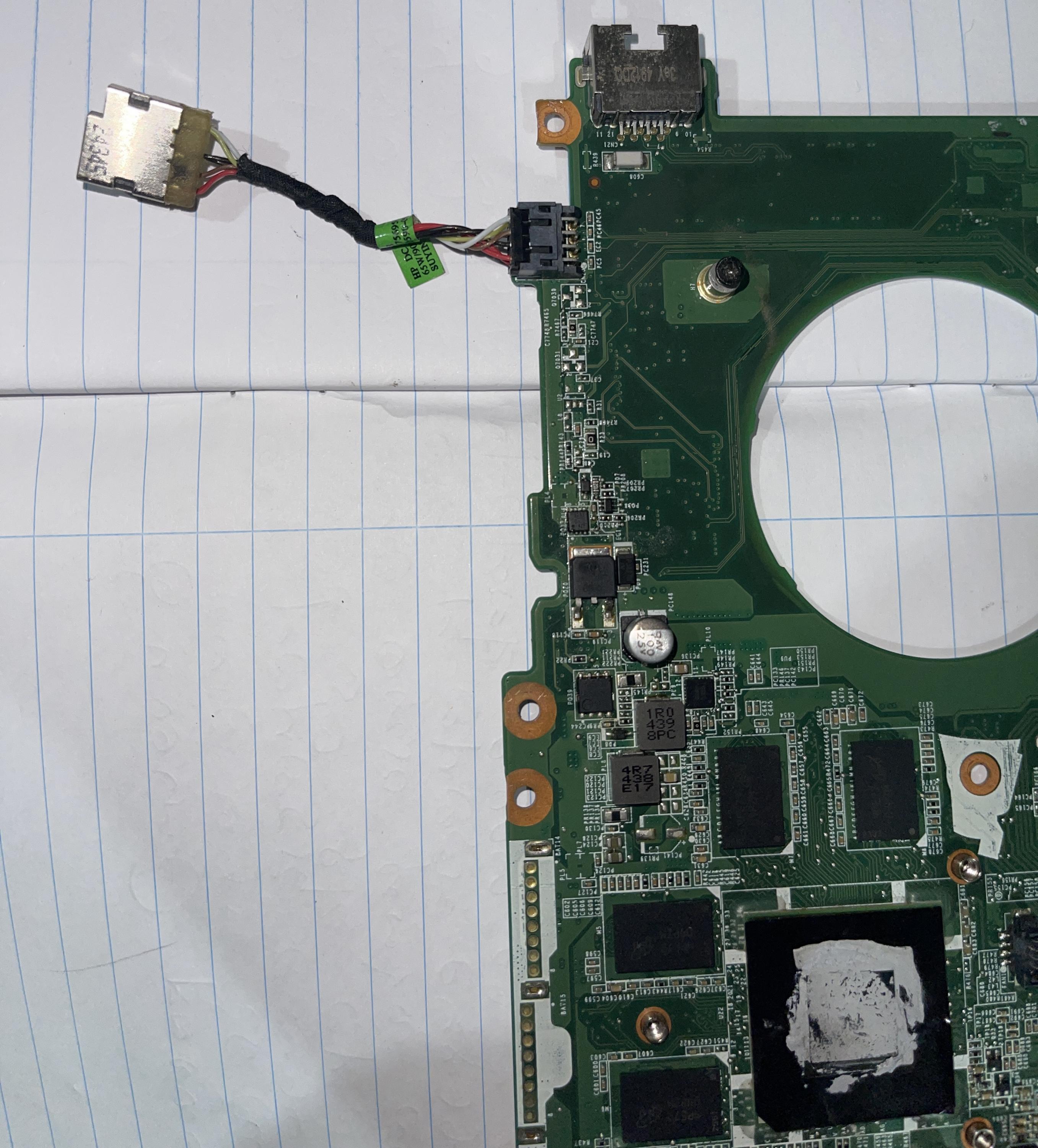

                        Re: HP ENVY 17 Motherboard Short help please
                        I am not familiar with this logic board but for sure the 2nd part is not the mosfet for the DCin connection.
                        Can you zoom / look around the DC in power jack on your logic board ?
                        The ~19v will enter there -> then look for parts like the '#1' in your post = that is a mosfet and the 2nd mosfet will be similar.
                        We are interested to inspect the first 2 x DCin mosfets for this review.
                        Post pics so we can be sure.
                          My mistake.
                          2nd Mosfet (it only has 4 pins) = Source to Drain -------> 0.5ohm
                          not 1.5

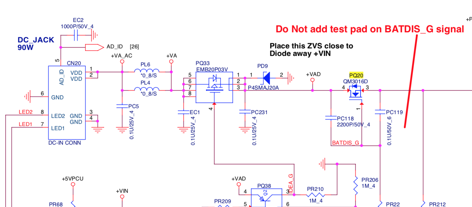

                            According the schematics. thats the 2nd mosfet. Actually I'm new to this. Am I wrong?
                              Ok. Just re-read this thread - found the schematic..hold for a few.
                              My bad...you are on the right track and are indexing the correct mosfets.
                              See attached for the pinout & datasheet for the 2nd mosfet.
                              Can you confirm that you are using the TAB and the right pin for the SOURCE & DRAIN resistance checks ?
                              This is reading @ 0.5 ohms ?? (you are on the lowest 200 ohm scale on your meter ?)
                                Here is the board with DC jack

                                      Yes I can guarantee that I checked resistance between pin 4 and pin 3. I entered it as 1.5 by mistake. actual reading was 0.5ohms.
                                      and also my scale is 200ohm
                                      What did you mean by TAB?? I didn't get it.
                                      • mon2
                                        • Dec 2019
                                        • 14664
                                        TAB is the middle of the 3 pins.
                                        So there is the LEFT, MIDDLE pin (broken) but is the metal TAB that is soldered and large in size, RIGHT pin.
