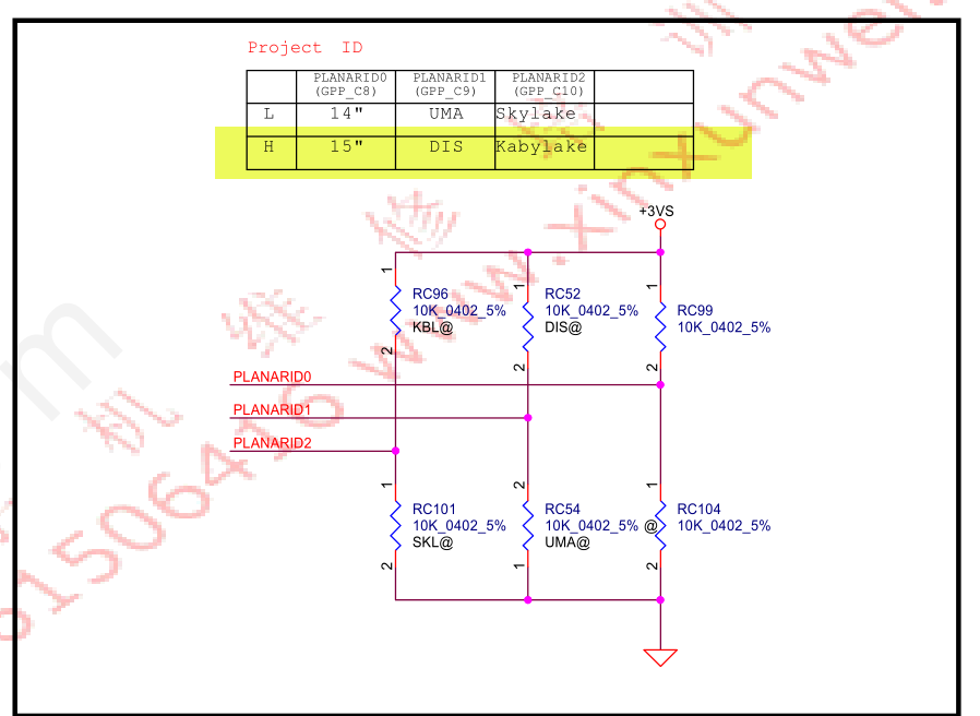

    Can Someone help in the error acpi error in windows 10 boot up in lenovo e570, i want to convert it on intel video card but after i disable the supply in gpu i get the error

    Hi. No direct experience with this topic but to disable the GPU, you will also have to apply a mix of straps.
    Have you done this ?
    See attached - taken from the NM-A831 logic board schematic.
    So is RC52 now stuffed = DIS mode. Also, RC54 should be REMOVED = DIS mode.

      In addition, check this out:
      https://www.badcaps.net/forum/showthread.php?t=108349
