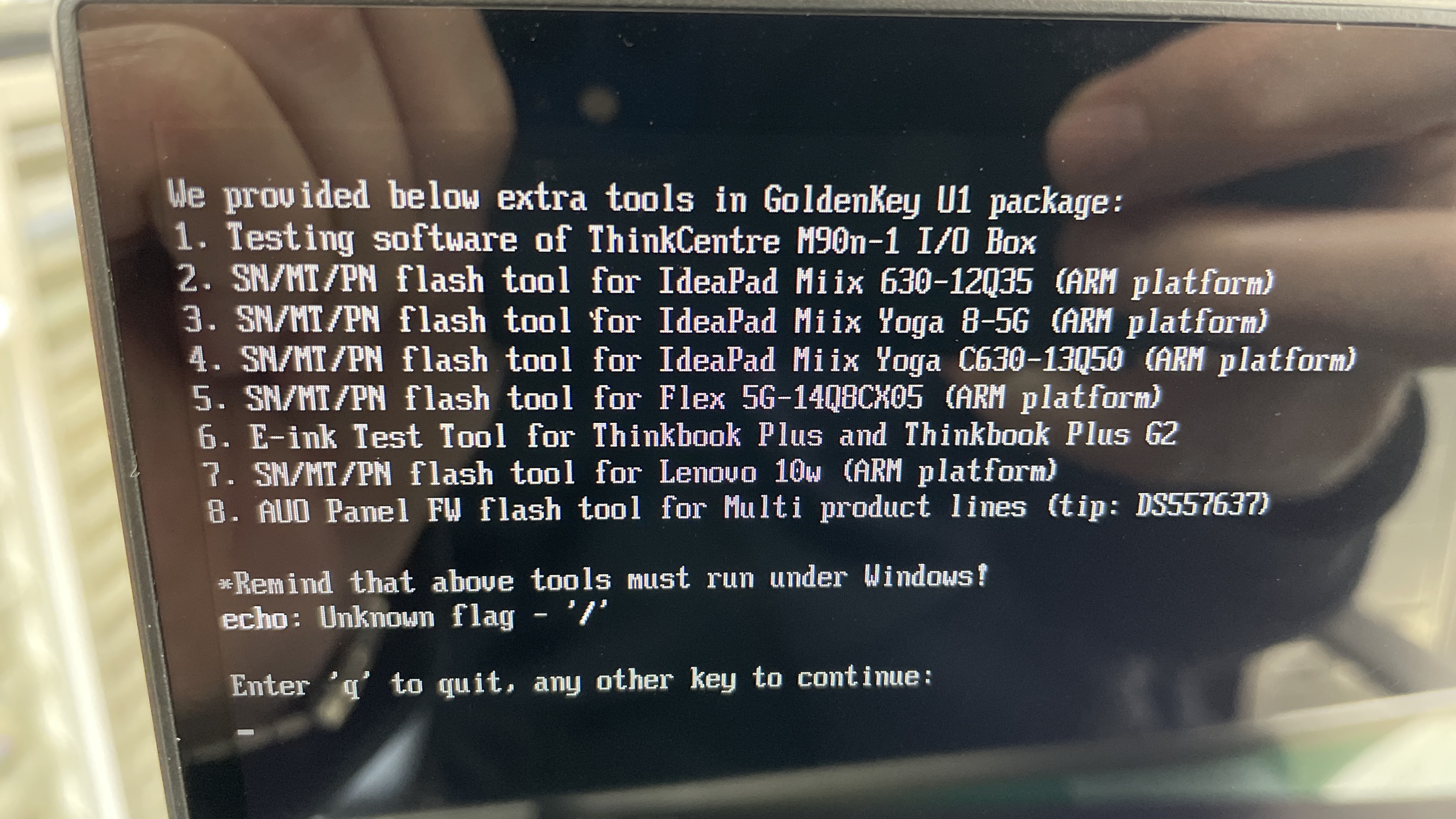

    I have a Lenovo Yoga C630-13Q50 Windows on Snapdragon laptop that I bought used here in Japan. They only sell the 4GB RAM version here in Japan so I decided to purchase an 8GB motherboard off of Aliexpress. The motherboard works without issue but Product ID, MTM, and Lenovo SN entries in the BIOS are INVALID.
    I would like to input the values from the old motherboard. After searching the internet I learned about LVAR and have tried to use it to input the values but I get the following error.
    I have tried placing the LVAR folder on C drive and Desktop with no luck.

    So I found the Lenovo Golden Key download and made a bootable USB. After booting into the Golden Key I found my device listed under other tools, but it says the tools are meant to be used in Windows.
    Going into the gku1tools folder on the USB there is a folder for my device. In the folder is a utility called ControlWosEEPROM.exe.
    Does anyone know how to use this tool to update my MTM, SN, and ID?

          I will outline my steps.
          I downloaded the Lenovo Golden Key toolkit from here. After making a USB stick I copied the files from gku1tools->YogaC630_13Q50 folder; WinWOS.bat and the ODMTools folder.
          I copied those to C:\ and opened a PowerShell prompt on C.
          With the following commands I was able to write a MTM, SN, and ID to my BIOS
          Code:
          .\WinWOS.bat /w /ln "SERIALNUMBER"
          .\WinWOS.bat /w /mt "MACHINETYPE"
          .\WinWOS.bat /w /pn "PRODUCTNAME"
          Putting the actual values in the quotes.
          I got all this information from this post on reddit.
