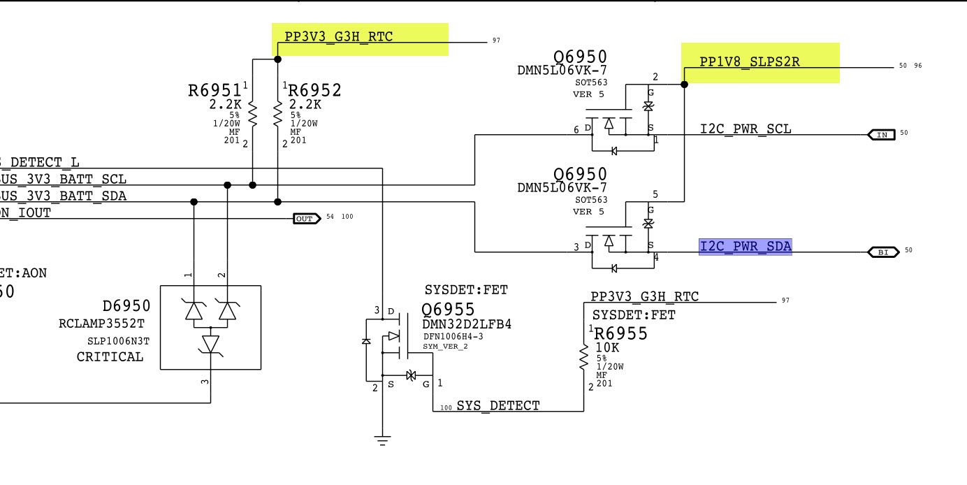

    I'll try to list as much info about the board as I can:
    The machine without the battery connected draws 5V and .025mA.
    PPBUS_G3H is stuck at ~1V. Sometimes it dips below this momentarily
    I2C_PWR_SCL - 0V
    I2C_PWR_SDA - 0V
    3V3_G3H_RTC is missing as well, because U6960 isn't being powered &
    CHGR_EN_MVR is not present as well

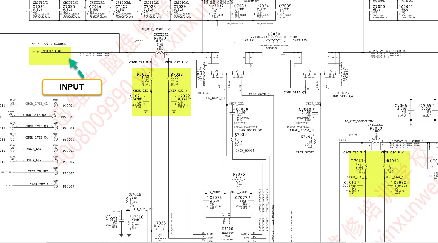

        Re: MBP A1989 No Power 5.1V .025-.03MA
        See attached.
        1) What are the voltage readings for pins # 2 & # 3 of the battery connector? Remove the battery so we can review the true readings of these communication lines (SDA & SCL). Red meter probe on the signal to measure; black to ground (shield is ok).
        2) Measure the voltage of the pull-up voltage rails. Post the readings.
        3) Remove all power -> meter in resistance mode. Check the resistance to ground of the same pins # 2 & # 3 of the battery connector. We are checking to see if the ESD diode @ D6950 is halting the I2C / SMBUS communication lines.
        4) U7000 (ISL9240) is a buck / boost regulator. If 5 volts is fed into the device, this regulator will spit out a boosted voltage of ~12 volts to kickstart the motherboard. Respectively, when all is well, the USB Type C adapter will power the logic board @ 20V once the power delivery contract is selected by this working logic board. Then with a 20V INPUT from the external adapter, this U7000 device will switch into a buck converter mode and will LOWER the input voltage to again ~12v6 (need to check the actual value but is around this range).
        In your case, you do not have anything close so ISL9240 may be defective. This is a tiny WLCSP device and requires precision microsoldering. Before we conclude this, check around to look for obvious damaged parts; liquid damage.
        We also need to confirm:
        a) what is the INPUT voltage @ PPDCIN_G3H ?
        b) Remove all power. Meter in lowest resistance mode. Check the resistance of each current sense resistor that are highlighted. It is vital that the resistance of the series resistors match the schematic. If the part is missing, the ISL9240 will shut down immediately to protect potential damage.
        Use the boardview file for this logic board -> locate the resistors -> measure their resistance.
        Post the readings.
        Again - NO POWER when checking resistance.
          1) The voltage for pins 2 & 3 on the battery connector is 0V, but it periodically jumps up to .120V
          2) PP3V3_G3H_RTC is 0V, PP1V8_SLPS2R is 0.001V
          3) Resistance to ground of those same pins is 3.9M ohms.
          4a) PPDCIN_G3H voltage is 5.1V
          b)
          R7062 is ~53ohms, this does not match the schematic. How did this happen?
          R7061 - 1.1ohm
          R7021 - .8ohm
          R7022 - .8ohm
            Remove R7062 off the board carefully without too much air pressure since it is tiny and can fly away or disturb nearby parts.
            Check the resistance again if this resistor.
            If required, replace it with another but source a 1% accurate part. Then check the resistance again in circuit. Then power up to check ppbus_g3h voltage (without the fuse).

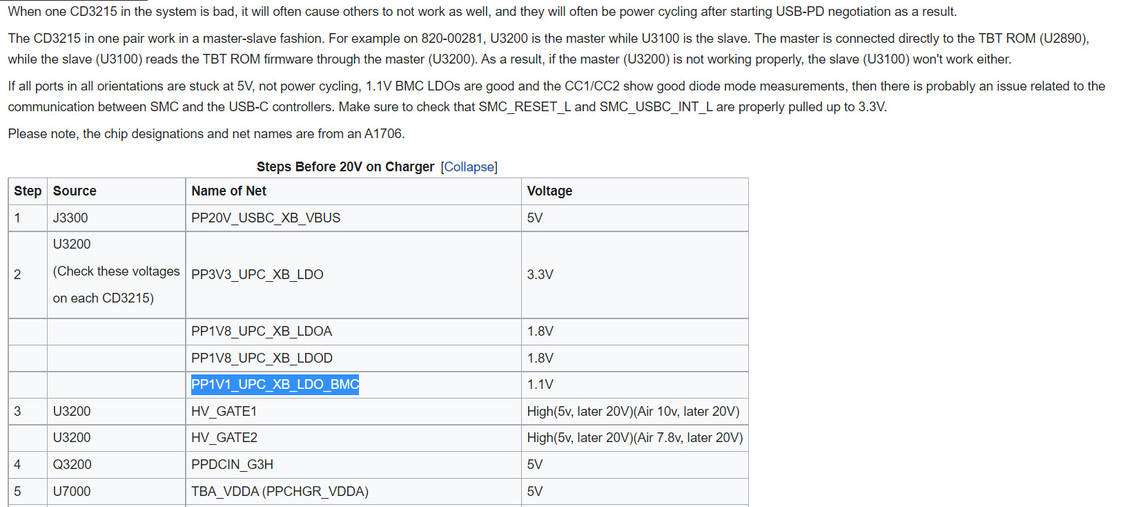

                            From @Piernov's article:
                            Without communication with the TBT ROM, the 1.1V BMC LDO (PIN 35) won't come up while other LDOs will be present. The 1.1V BMC LDO is used to drive the logic negotiating USB-PD (USB 2.0 communications to charger). When that happens, when USB-C is connected to this CD3215, it will not negotiate 20V and get stuck on 5V, not cycling.
                            Can you review the voltages on the SPI lines that is showing the CD3215 controllers? This local SPI flash memory holds the firmware for the type c controllers (cd3215).
                            Post the voltages on each SPI flash pin. The contents of the flash device itself maybe corrupt but start with the voltage check. The dumps for the spi flash (TBT ROM) are available on this forum.

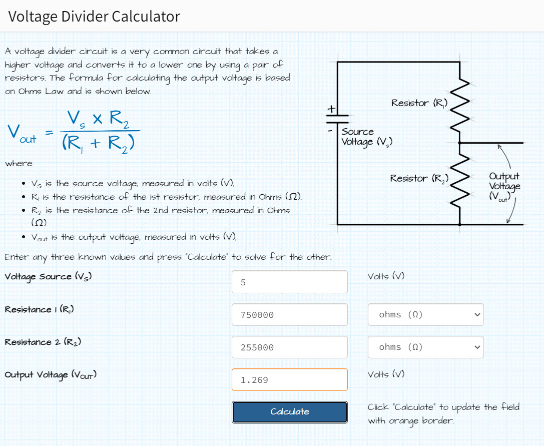

                                    1) Confirm the resistance of R7015 and also of R7016.
                                    The voltage value of CHGR_AUX_DET is off a bit. Perhaps your meter ?
                                    2) According to the logiwiki for 20V topic, step # 2 notes that the CD3215 have to supply the 1v1 @ LDO_BMC (pin E1 of the BGA package). Your logic board does not have this voltage on either CD3215 ACE controller.
                                    Do you have a flash chip programmer ? May be practical to reflash the contents of the TBT rom device with the factory contents.
                                    You are after the 820-00850 TBT ROM dump:
                                    https://www.badcaps.net/forum/showthread.php?t=104860
                                    See the post from @willisk.

                                        I double checked CHGR_AUX_DET and the value is still 1.07V, but R7015 is reading really low at 220kOhm and R7016 is reading at around 200kOhm
