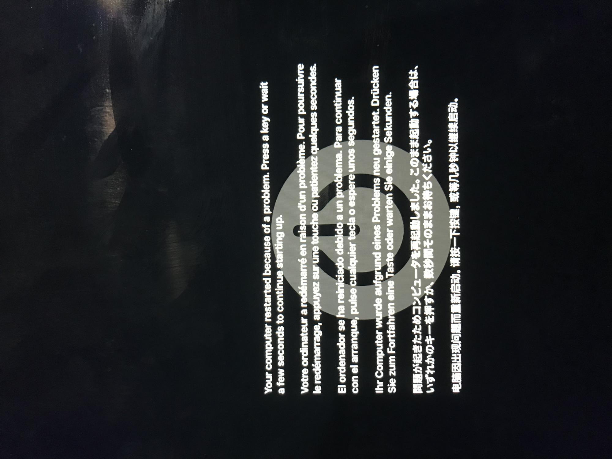

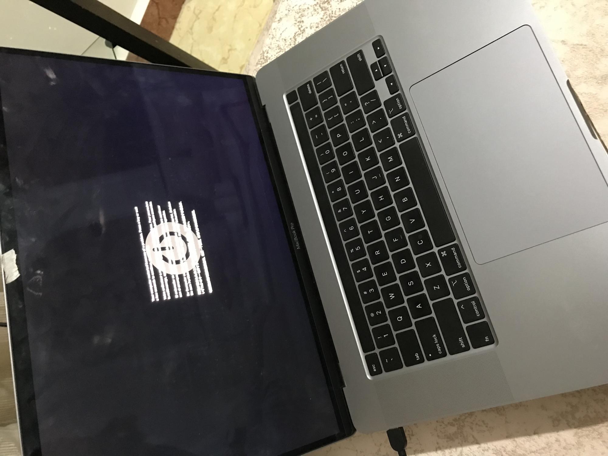

    Help me . Macbook pro 2019
    Please help
    At the end of the formatting, this message appears
  • ugamazing
    • Jun 2013
    • 171
    • usa
    Re: Help me . Macbook pro 2019
    Not a great message to see.
    Can you provide more details? When installing MacOS you receive this message? Or does the unit restart/crash when formatting SSD in disk utility? Any history on the unit? Any signs of liquid (mushy/sticky keys) or drop? If this is a dropped device, it could get super not-fun.
