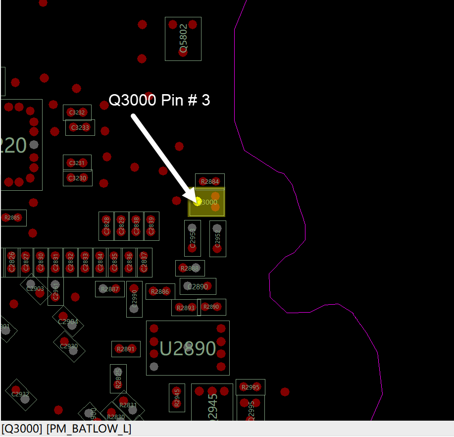

              Re: MacBook Pro Retina Late 2013 shows light, fan spin but no chime
              Measure the voltage of PM_BATLOW_L .
              Check it @ Q3000 - pin # 3.

                #87
                00.8 on 200m mode.

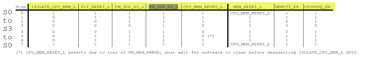

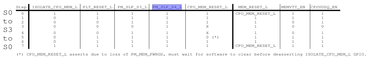

                        See attached. Check each of the signals from this chart to confirm which one is still at '0' logic level.
                        When each is '1' -> the board should boot = S0 power state.

                          #92
                          Hi mon2,
                          Please can you help me understand this chart and what I am testing, please for your help.
                          • mon2
                            • Dec 2019
                            • 14733
                            #93
                            Search for each of the signal (net) names in the attached chart.
                            Measure their values and post them here. If the voltage is ~3v = '1'; then this is a good reading.
                            If the voltage is low = '0' -> stopping your board from booting up.
                            For the S0 power state, each of the highlighted signals need to be '1'.
