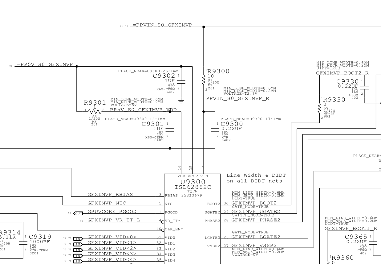

MacBook Pro Retina Late 2013 shows light, fan spin but no chime
  • Gigabit2
    • Apr 2022
    • 264
    • United Kingdom
    I have a MacBook Pro Late 2013 Retina.
    When plugged in, it shows an orange light on the charger (without battery connected) and the fans spin. But after about 15 seconds they stop and then never spin up again. No chimes and nothing on the display.
    There is impact damage to the corners of the casing and one of the USB ports is therefore warped. But the logic board itself looks okay from visual inspection.
    PPBUS_G3H showing 12.58V at all times.
    Can anyone help?

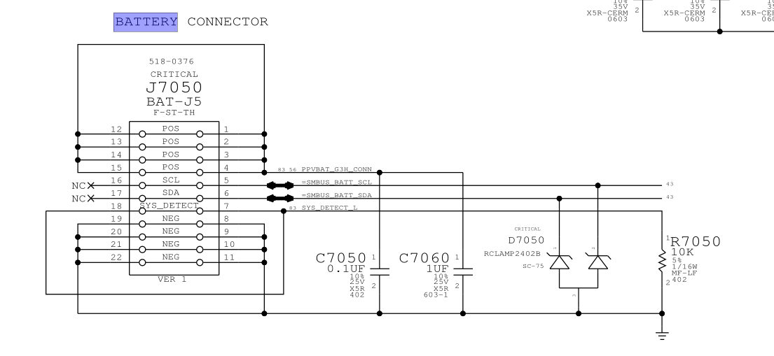

    Remove all power. Meter in resistance mode.
    Check the resistance to ground of each pin on the battery connector.
    Post the readings and scale used on the meter.

      Pin 1: 00.5 - 200 mode
      Pin 2: 00.4 - 200 mode
      Pin 3: 00.6 - 200 mode
      Pin 4: 00.5 - 200 mode
      Pin 5: 10.00 - 20k mode
      Pin 6: 85.8 - 200k mode
      Pin 7: 85.5 - 200k mode
      Pin 8: 1. - on all modes
      Pin 9: 1. - on all modes
      Pin 10: 1. - on all modes
      Pin 11: 1 - on all modes

            Post the voltage readings of each battery pin (with the battery connected).
            • Gigabit2
              • Apr 2022
              • 264
              • United Kingdom
              Re: MacBook Pro Retina Late 2013 shows light, fan spin but no chime
              Pin 1: 11.33V
              Pin 2: 11.33V
              Pin 3: 11.33V
              Pin 4: 11.33V
              Pin 5: ?
              Pin 6: ?
              Pin 7: 0.03V
              Pin 8: GND
              Pin 9: GND
              Pin 10: GND
              Pin 11: GND
              Pin 12: 11.33V
              Pin 13: 11.33V
              Pin 14: 11.33V
              Pin 15: 11.33V
              Pin 16: UNCONNECTED
              Pin 17: UNCONNECTED
              Pin 18: 0.03V
              Pin 19: GND
              Pin 20: GND
              Pin 21 GND
              Pin 22: GND
              Pin 23: UNCONNCTED
              Pin 24: UNCONNECTED
              Not sure how I do the others as the connector blocks the pins?

                What are the voltage readings on pins 5 & 6 ?
                • Gigabit2
                  • Apr 2022
                  • 264
                  • United Kingdom
                  Hi mon2,
                  How can I measure these? The pins are covered by the connector with it plugged in.
                  • mon2
                    • Dec 2019
                    • 14628
                    Measure @ D7050 ESD diodes.
                    • Gigabit2
                      • Apr 2022
                      • 264
                      • United Kingdom
                      Hi mon2,
                      Pin 5: 3.40V changing to 3.33V every second.
                      Pin 6: 3.40V changing to 3.38V every second.
                                    Ok. Meter in DC volts scale.
                                    What are the voltage readings for the following ?
                                    SMBUS_SMC_0_S0_SCL
                                    SMBUS_SMC_0_S0_SDA
                                    • mon2
                                      • Dec 2019
                                      • 14628
                                      Apply lots of flux on U9300 = PPVCORE_S0_GFX_REG regulator.
                                      Reflow this component to fix up every solder joint on this component - there is a long history of faults linked to this device.
                                      • Gigabit2
                                        • Apr 2022
                                        • 264
                                        • United Kingdom
                                        SMBUS_SMC_0_S0_SCL: 3.32V going to 3.29V every second
                                        SMBUS_SMC_0_S0_SDA: 3.31V going to 3.28V every second
