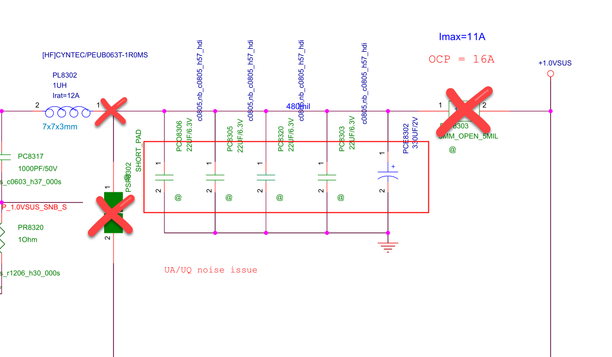

        Check the attached and remove the parts in 'X' to see if the low resistance to ground is due to the filter caps.

          in the motherboard (rev 3) there aren't the 4 capacitor... so it's not a capacitor problem.
          i'v removed capacitor PCE8302 with no luck

            After removing PCE8302, which side of PJP8303 has the low resistance ? Both pins ??
            • phantomEVO
              • Mar 2013
              • 509
              Re: [help]asus x510unr rev 3 dead
              0.7 ohm left side (1.0vsus)
              11.7 ohm right side

                    Confirm the partial schematic posted earlier. If you have broken each of the 'X' marked PCB jumpers, why is there such a low resistance to ground on the LEFT side = regulator side of the traces ?
                    That is almost a direct solder short to ground.
                    Locate the root cause of this fault.
                    The right side is the consumer (load) side and ~11 ohms may be ok for a CPU. CPU designs these days are current sucking pigs (not to be confused with the salt eating women of Star Trek).

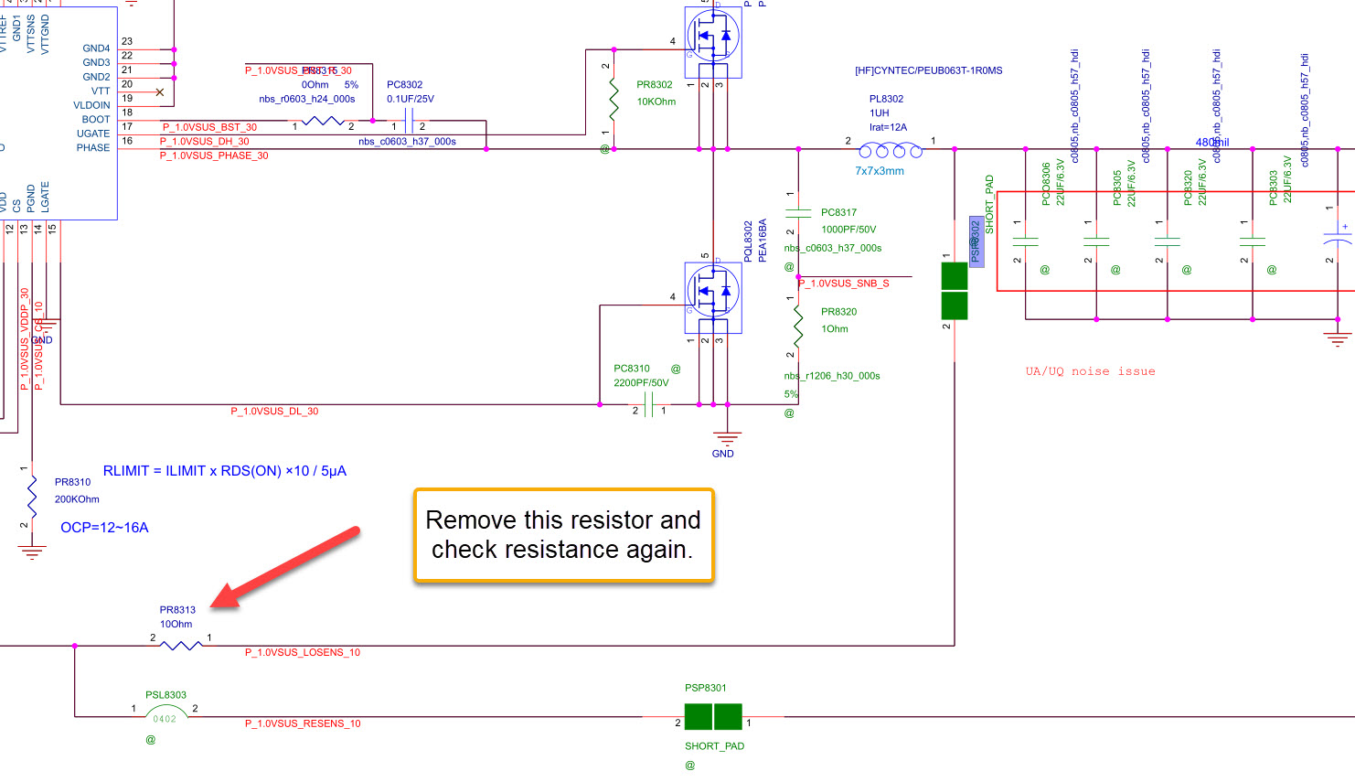

                                Ok. To confirm, you have PL8302 lifted by one leg or removed from the board ?
                                Still have this low resistance ? Then review the trace with PSP8302 -> leads to a resistor @ PR8313. Is this correct ?
                                Remove PR8313 but do not lose it.
                                After removing PR8313, do you still have this very low resistance to ground ?
                                    resistor removed, stil 0,9ohm on 1vsus
