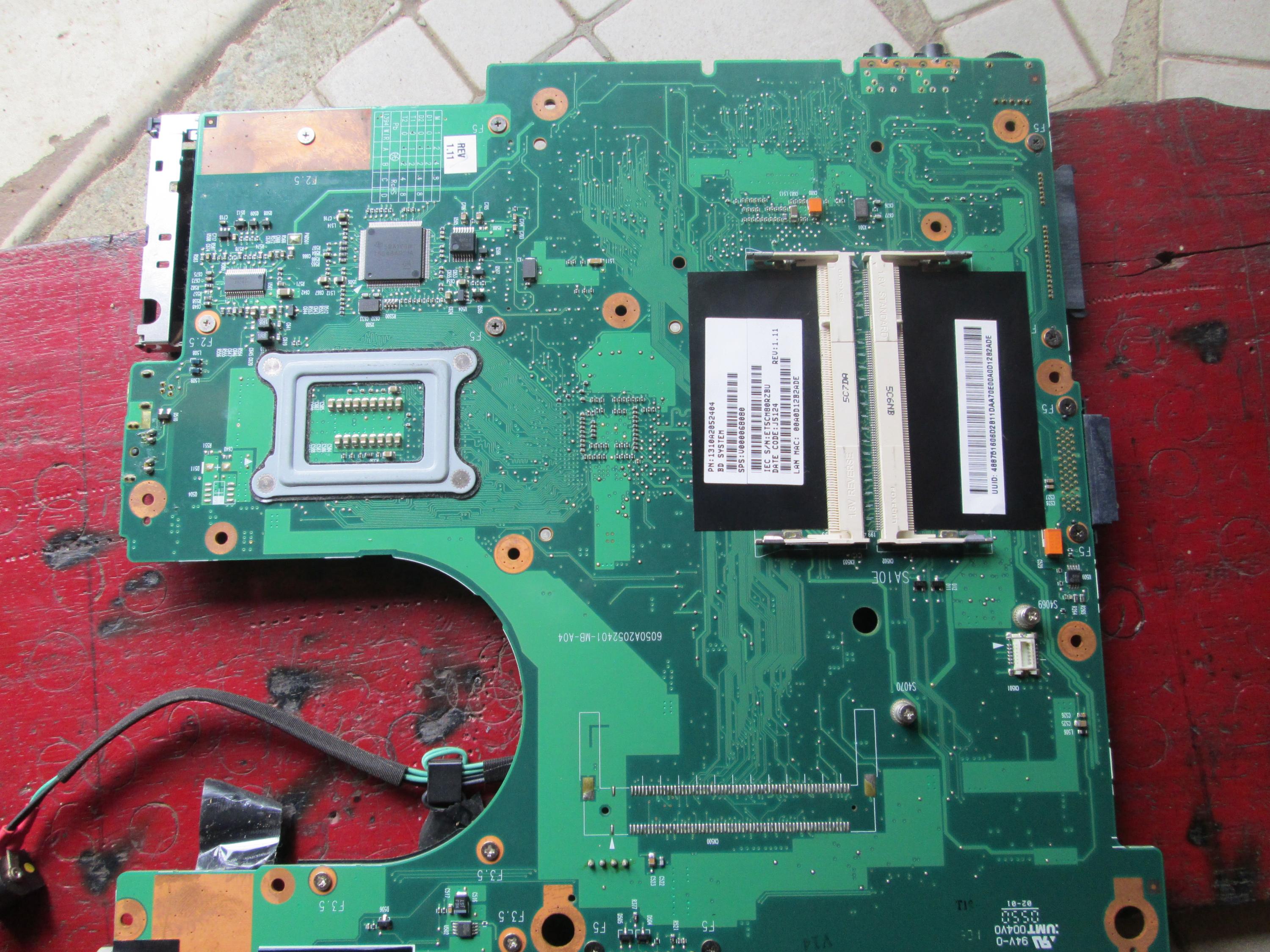

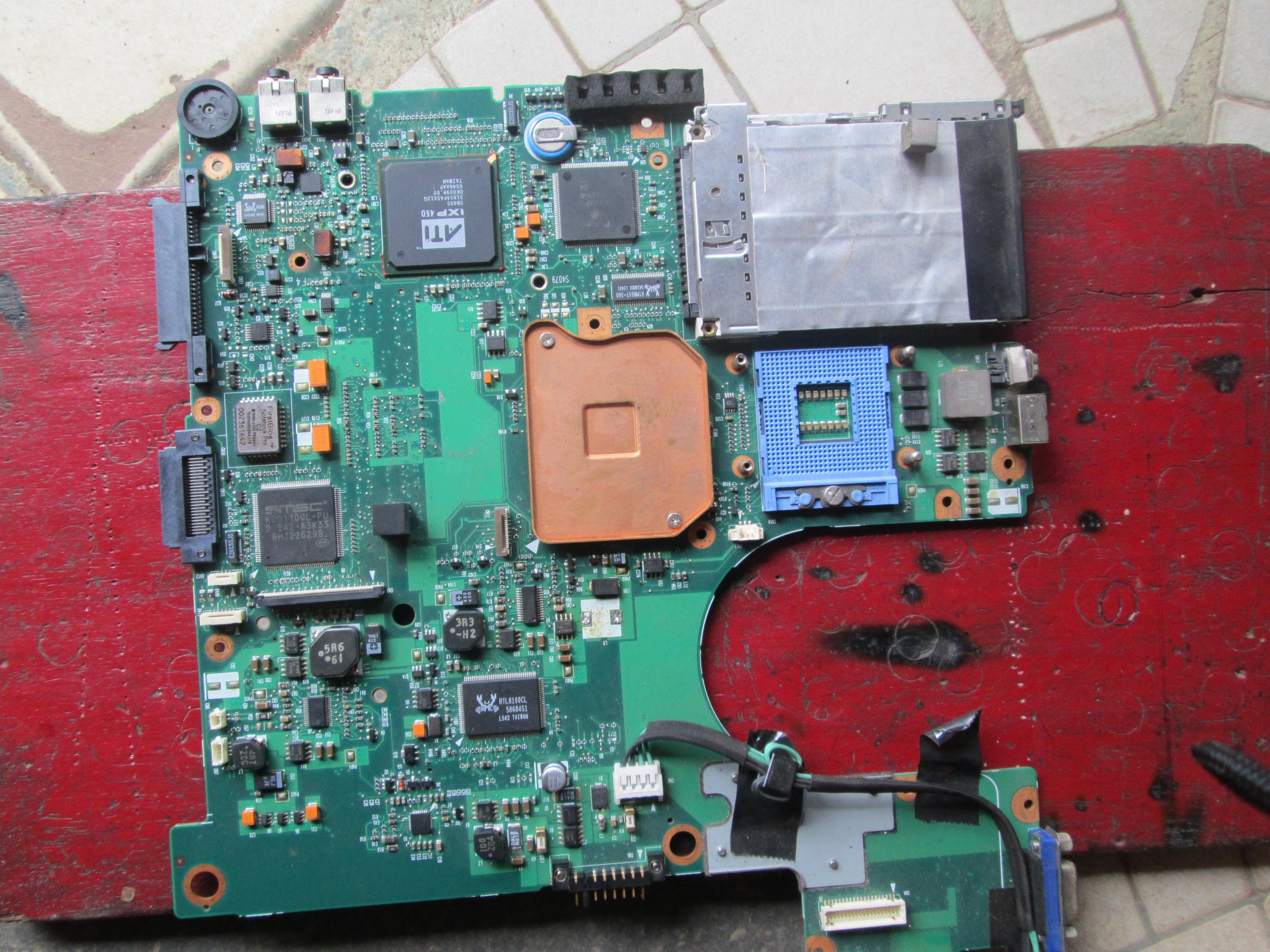

    Toshiba Satellite A100-525 power indicator light disappears on pressing Power Button and voltages disappear except 4.5v on one pin of the battery terminal. Some like L9 shorts to ground and otherwise; capacitors - C340, C371, C98 short to ground, on-board and off-board. Please experts in the house, assist me pin down the fault. See schematic attached.

    5) Consider to remove all power -> meter in resistance scale (start with the lowest) -> check the resistance to ground of each coil (large grey in color); 2 legs; inductors.
    List the inductors and the resistance to ground when found.

      @mon2. Thanks alot for your efforts in assisting me resolve my pc issue. After I read your comments, I had thorough observation of the motherboard I have issues about and discovered that the board labeling does not tally with the schematic in some areas. For instance, I couldn't find F502, F303 and U511 on the board. And I ask, is the schematic I'm working with the one for my uploaded board screenshot? Please, assist me further, Veteran.

        Board is "San Antonio 10E" (AMD chipset) not "San Antonio 10" (Intel chipset).

          @piernov. Your support helped me alot. I got the right schematic, though I wasn't able to get its boardview. However, I was lucky to figure out a faulty coil. I pulled another one off an old parked laptop board, and that was my saviour. The laptop is up and running as I speak. Many thanks, Super Moderator. Please, assist me in subsequent posts as I am a newbie!

            @mon2. Your post in a big way assisted me find solution. Actually, I was wrong with the schematic I sent and you posted in regard. @piernov helped with clue to appropriate schematic for the laptop. VADPTR, ACDET were present. As I was checking the coils on your instruction, I discovered that L9 behaved differently. I pulled it off and replaced it with another I pulled off from another parked laptop board. Then, laptop responded. It's now up and running. Many thanks, veteran.
