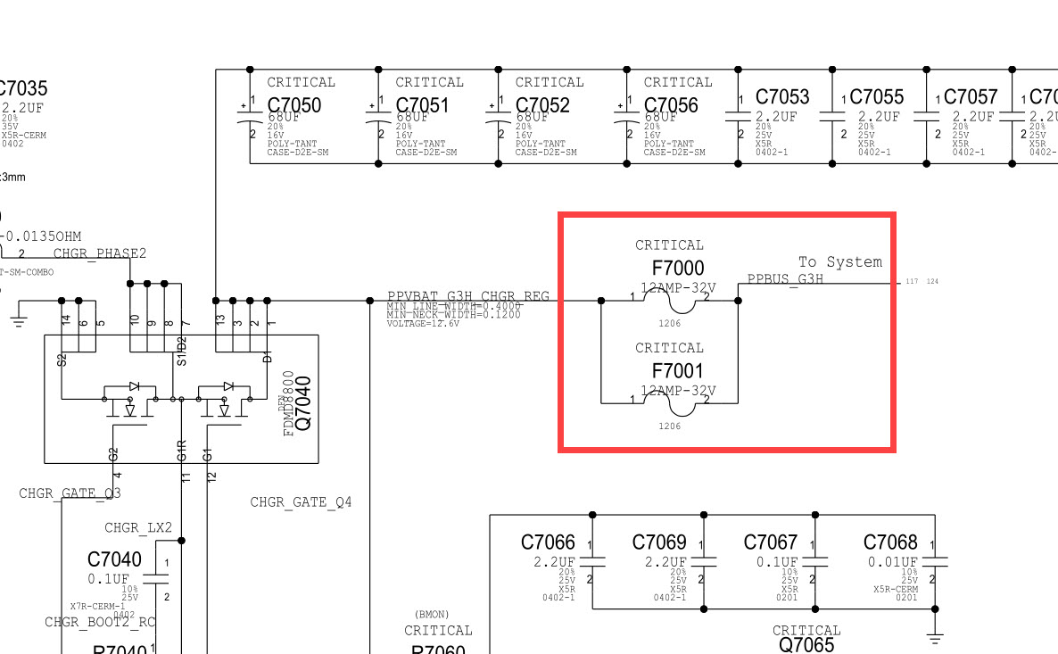

    [help] a2141 motherboard 820-01700 completely dead
    history "suddenly dead"
    no water damage, motherboard seems perfect.when i try to power it on, i have no activity at all..no fan spin...

        Re: [help] a2141 motherboard 820-01700 completely dead
        Thanks for the update.
        Your video is showing power cycling from the current draw.
        Are you using the original power adapter ? Or at least a power adapter that can supply the required current ?
        Review the voltage @ F7000 (PPBUS_G3H).
        Meter in DC volts scale (20v is ok).
        What is the voltage to ground ? Is it stable or is it pulsing ?
          at this moment i'm using a under rated power supply (65w) just to test, and not the original one. but i can have it without problem!
          on f7000 voltage is not stable...
          sometimes it is 9v some times 12v
            Remove F7000 & F7001. Power up and check if the PPBUS_G3H is stable @ pin # 1 of F7000 / F7001.
            What is the voltage of PPBUS_G3H ?
            Is the PPBUS_G3H rail stable without the fuse (and downstream load) ?
            This is to confirm if the fault is on the producer side (U7000) or consumer side (downstream from F7000 / F7001, pin # 2).
            If the PPBUS_G3H (producer side) is stable, then remove all power.
            Meter in resistance mode -> check the resistance to ground of PPBUS_G3H, F7000, pin # 2 (downstream side).
            Resistance of downstream side ?
              if i remove the battery, PPBUS_G3H is stable at 12,6v

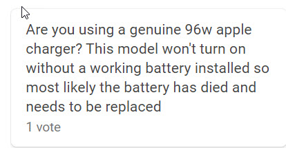

                Interesting. Q7065 (battery mosfet) is a suspect.
                Remove all power & no battery. Meter in resistance mode (start with lowest scale).
                Check the resistance across the mosfet Q7065 as follows:
                source (1-2-3) & drain (5-6-7-8)
                source (1-2-3) & gate (4)
                gate (4) & drain (5-6-7-8)
                Post the resistance readings & meter scale used for the measurements.
                If you see '1' on your multimeter, switch to the next high scale.
                You are checking for a low resistance which often means the mosfet is defective and should be replaced.
                  removing f7000 and f70001 i have stable PPVBAT_G3H_CHGR_REG stable (pin 1 of f7000 / f7001)
                  with my multimeter (fluke 17b+) auto scale mode, black probe on ground and red on pin 2 of f7000 i have 16,6 mohm
                  So you think that the battery Could be the provlem?
                  If it is right to check battery voltage Here, so the battery is Dead: i have 0,009v…
                    See my last post - your power adapter is under rated. Also you need a working battery to power this beast.
                      how to check if battery is working
                        Confirm the condition of the battery mosfet with the resistance checks. Post the readings.
