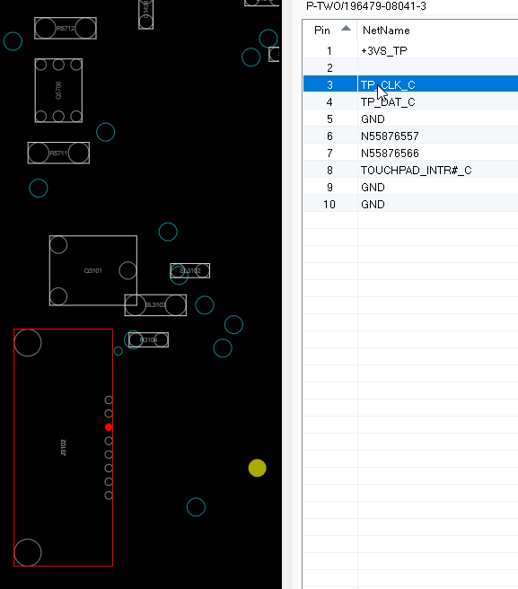

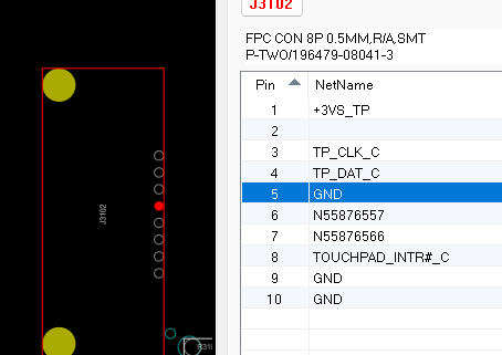

    Re: ASUS X556UJ_MB rev 2.0 touchpad
    Originally posted by SMDFlea
    Pin 5 is actually pin 4 GND
    60NB0AG0-MB1111 boardview https://www.badcaps.net/forum/showpo...76&postcount=4
    In MB1111 pin 5 is ground right? I'm getting 0v and continuity to ground so it seems to line up?

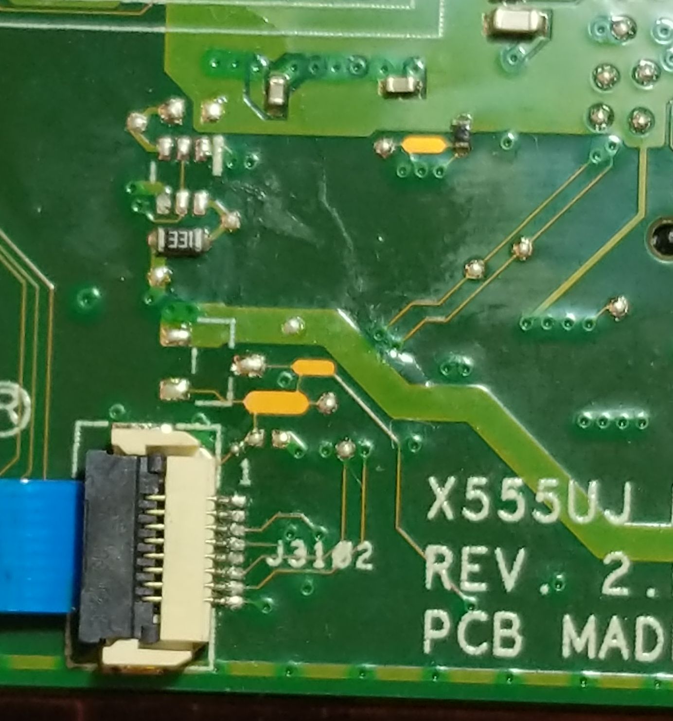

      Yes, looks correct. Concern is for the low voltage readings of the I2C track pad lines.
      Remove the esd diode you have near this connector and measure the voltage readings again. Test again without the esd protection array.
        Originally posted by steve.rand
        This is nearly the exact board version I have:
        https://devicedb.xyz/dev/file/3886-a...boardview-asc/
        I think the boardview files here at badcaps for X555UJ are not quite for this one.
        Mine is 60nb0ag0-mb1112
        I traced continuity from pin5 to this chip:
        Well i'm an idiot. We know now that pin5 is ground (not pin4) so I traced a ground to a ground on a mosfet that potentially has nothing to do with the trackpad?
          Basically, anything to do with the trackpad in boardview is missing on this mainboard, both sides of the board, leading to the embedded controller.
          i've put that little mosfet back on, but the voltages did not change.
