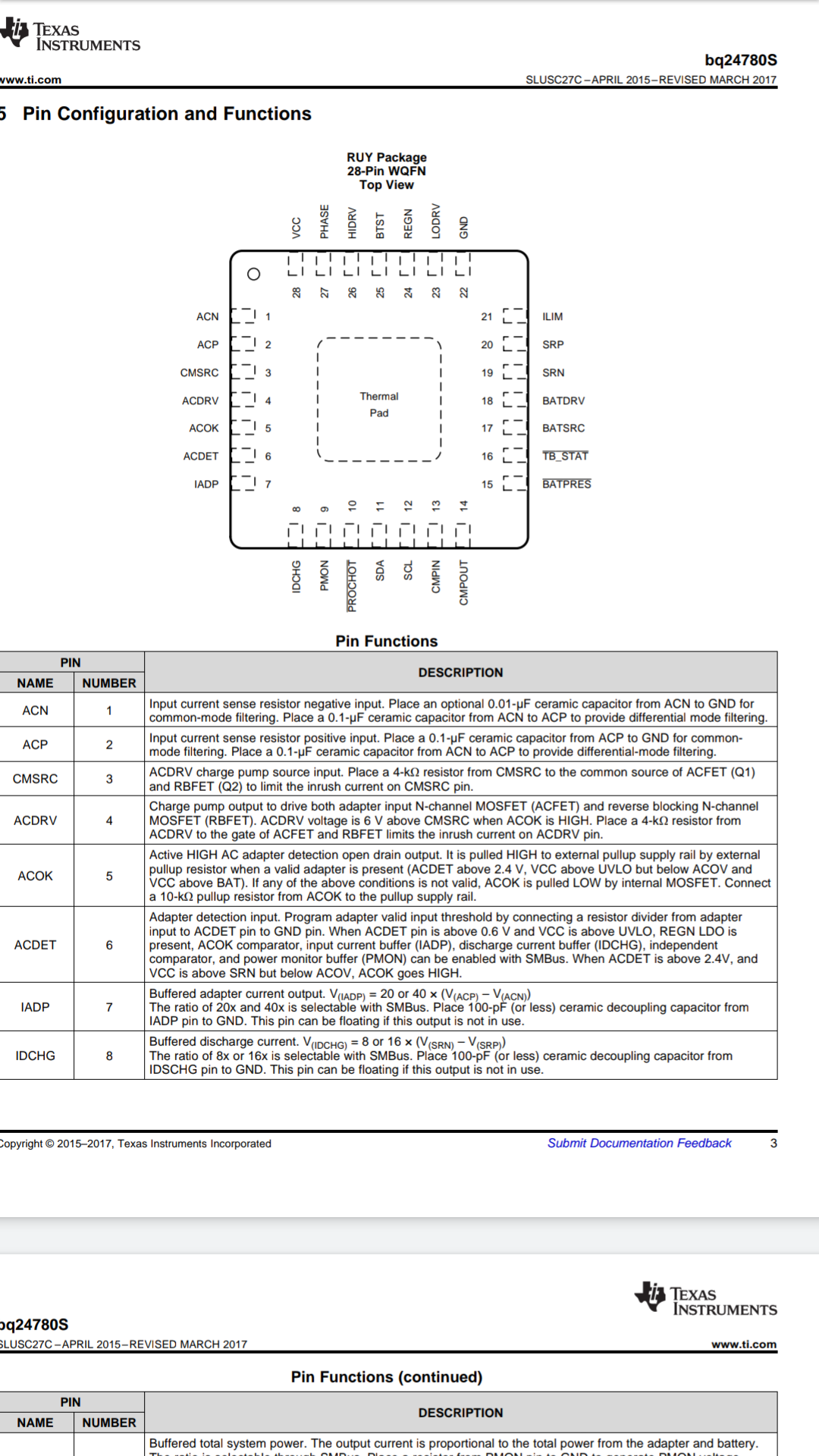

    i measured that almost everything works but have no ACDRV/pulsing to 3.5V after mosfet replace/, no ACOK without battery
    pu301
    pin28 vcc 19v ok
    pin6 ACDET 2.8v ok
    pin5 ACOK 0v ok
    pin3 CMSRC 0v/pulsing to 3.5V after mosfet replace/
    pin4 ACDRV 0v/pulsing to 3.5V after mosfet replace/
    pin24 REGN 6v ok

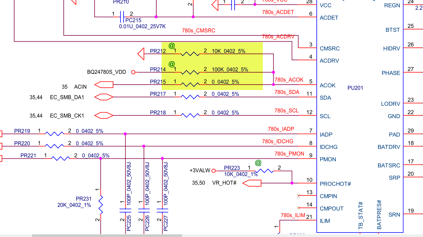

    1) can you link or post the schematic for the logic board? Have not yet checked my schematic database for the same.
    2) pin #5 ACOK PIN = 0v is not OK.
    3) remove all power. Meter in resistance mode. Check the resistance to ground of ACOK PIN #5.
    What is the resistance and scale used on your multimeter?

      Ok - believe to have found the schematic.
      1) Logic board block diagram references the charger IC as PU301 but the actual schematic shows as PU201. Nice.
      2) Review to check which resistors are present on the ACOK signal line.
      Post the location and do check the voltage on the other side of the resistor - do you have ~6v on the other side of PR214 ?
      Confirm which of these 3 resistors are on your logic board.

        only one as on schematics
