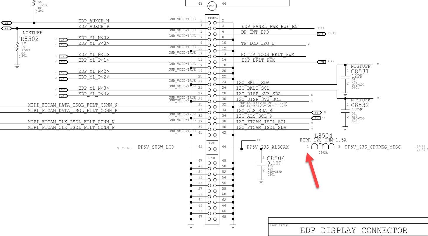

    this a2289 had a no power problem , got 3v3ssd short , fixed found a shoted caps.
    Now i got no webcam detected , i see on system report but no work .
    All flex cable are connected

    Re: a2289 no wecam
    The system report is NOT showing the webcam ?
    Check the voltage @ L8504, pin # 1.
    Check that no pins are bent on the connectors between the logic board & camera cable. Only inspect the camera connector pins with all power removed.

        Re: a2289 no wecam
        5v

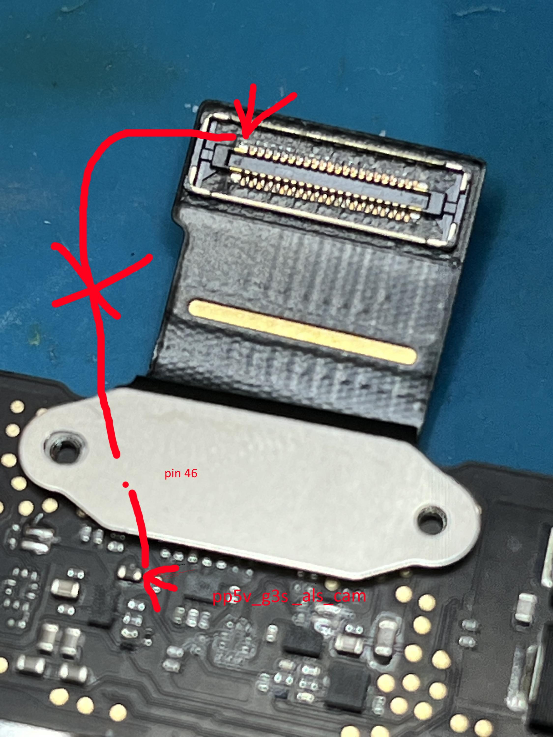

            Re: a2289 no wecam
            i checked the flex cable i have 5v on board and on pin 46 but no continuity with other side ? its right

                Re: a2289 no wecam
                anyone with same flex can confirm that its pin number on pics?
                aniway any pin will beep

                  Re: a2289 no wecam
                  I do not believe this will be the fault since the webcam is being detected.
                  If you do NOT connect this connector, does the webcam get removed from the list of hardware?
                  If the webcam is being found, it is being powered.

                    Re: a2289 no wecam
                    fixed with new flex cable

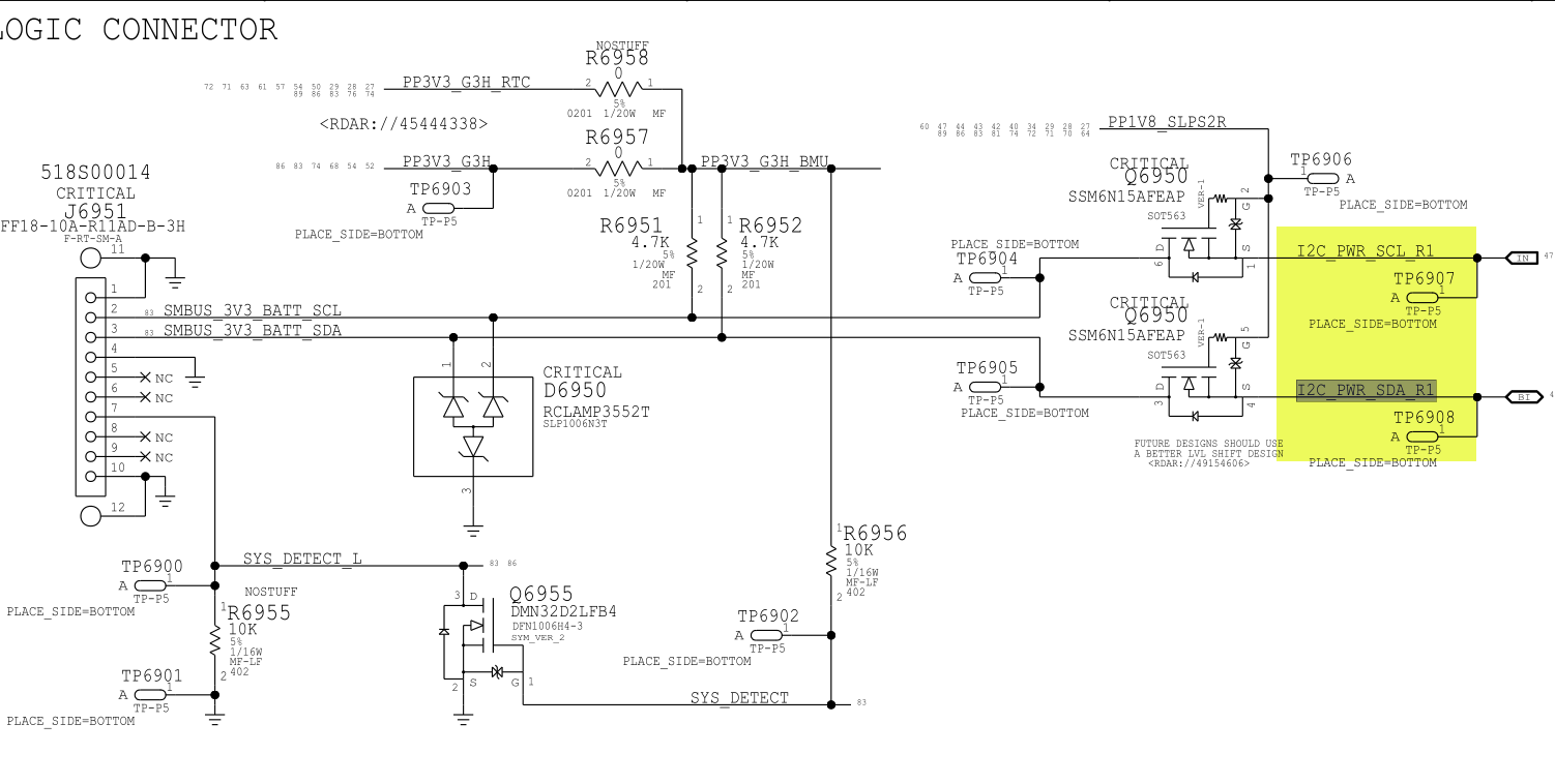

                        Re: a2289 no wecam
                        now this shitty , doesnt detect the battery
                        • mon2
                          • Dec 2019
                          • 14355
                          Re: a2289 no wecam
                          Measure the voltages on the esd diodes on the battery pack. These are the smbus lines (sda and clk).
                          Post the voltage readings.
                          • lordgeny
                            • Apr 2016
                            • 223
                            • Italia
                            Re: a2289 no wecam
                            SMBUS_3V3_BATT_SCL 3.3
                            SMBUS_3V3_BATT_SDA 3.3
                            SYS_DETECT_L not present
                            PP3V3_G3H_BMU 3.3
                            • mon2
                              • Dec 2019
                              • 14355
                              Re: a2289 no wecam
                              Is the battery known to be good?
                              Is the battery dead or charged?
                              With the battery only, does the battery voltage reach the battery mosfet to run the logic board?
                              What is the voltage on SYS_DETECT_L ?
                              Also post the measurements for:
                              I2C_PWR_SCL_R1
                              I2C_PWR_SDA_R1
                              • lordgeny
                                • Apr 2016
                                • 223
                                • Italia
                                Re: a2289 no wecam
                                I2C_PWR_SDA_R1 1.8
                                I2C_PWR_SCL_R1 1.8
                                SYS_DETECT_L none
                                yeas i have 1.8v at f7000
                                i dont know if battery are ok or not .
                                i Found the flex j6950 damaged i maked jumper looking at schematics , but still no charging/not detected
