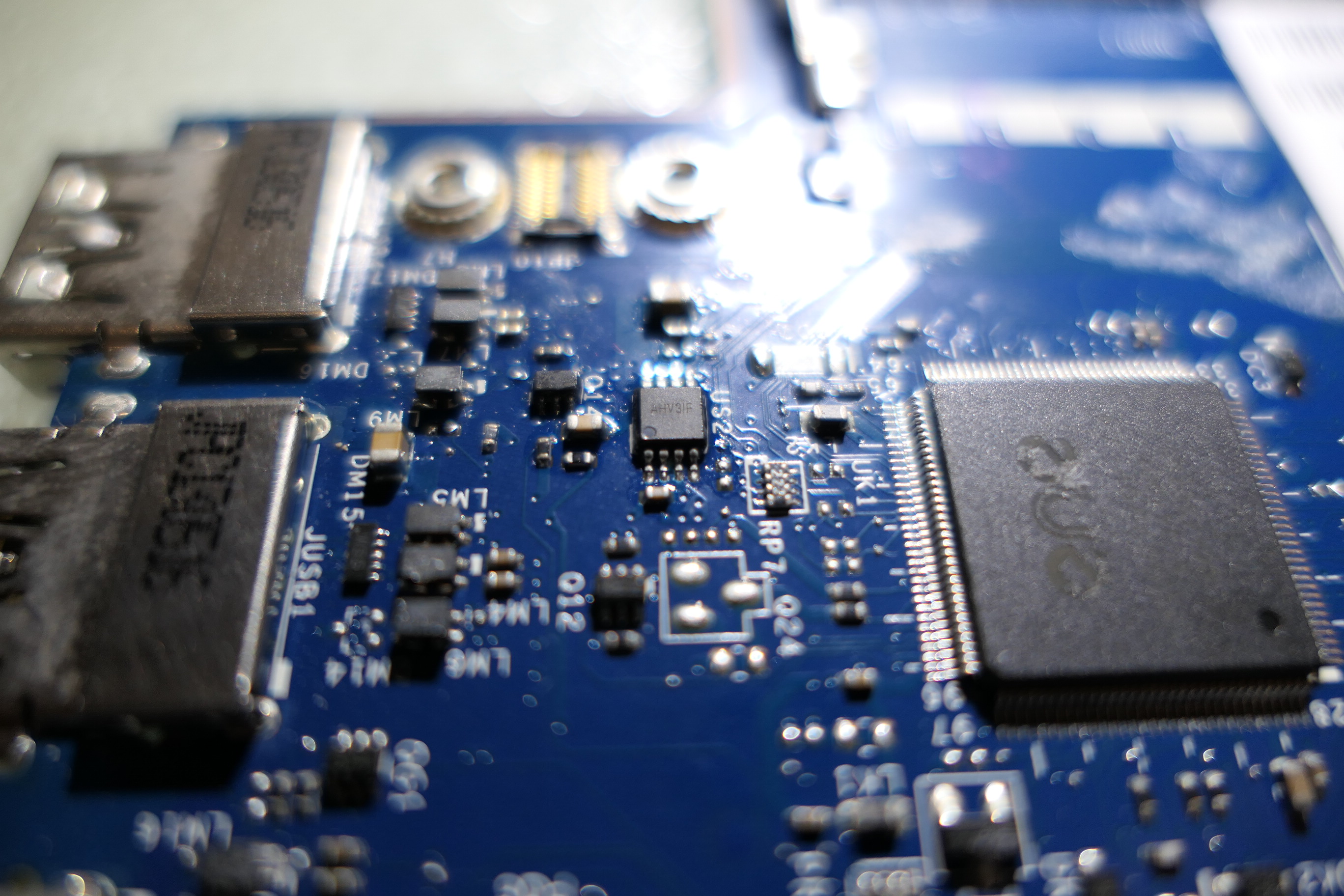

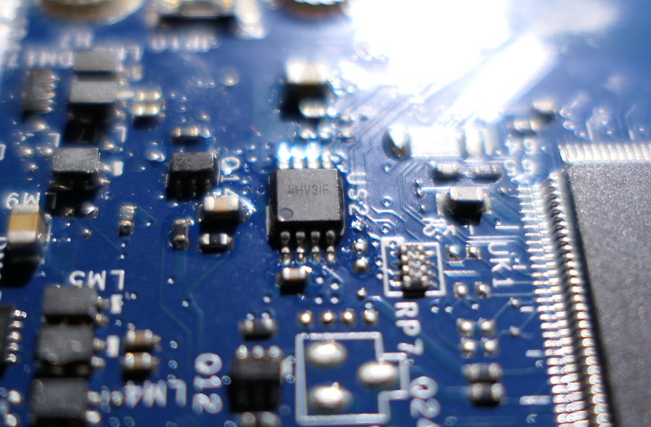

    Hello Everyone,
    Needing to identify this chip which is near the USB ports on an HP motherboard. The marking on the chip is ahv31f.
    It is completed shorted so I need to find a replacement. Thank you for your help!

      Re: Need help identifying a chip on a HP motherboard
      Maybe a silergy SY6288D10CAC
      https://www.badcaps.net/forum/showpo...1&postcount=12
      Post the laptop make/model number please,and the thread can be moved to the laptop forum.

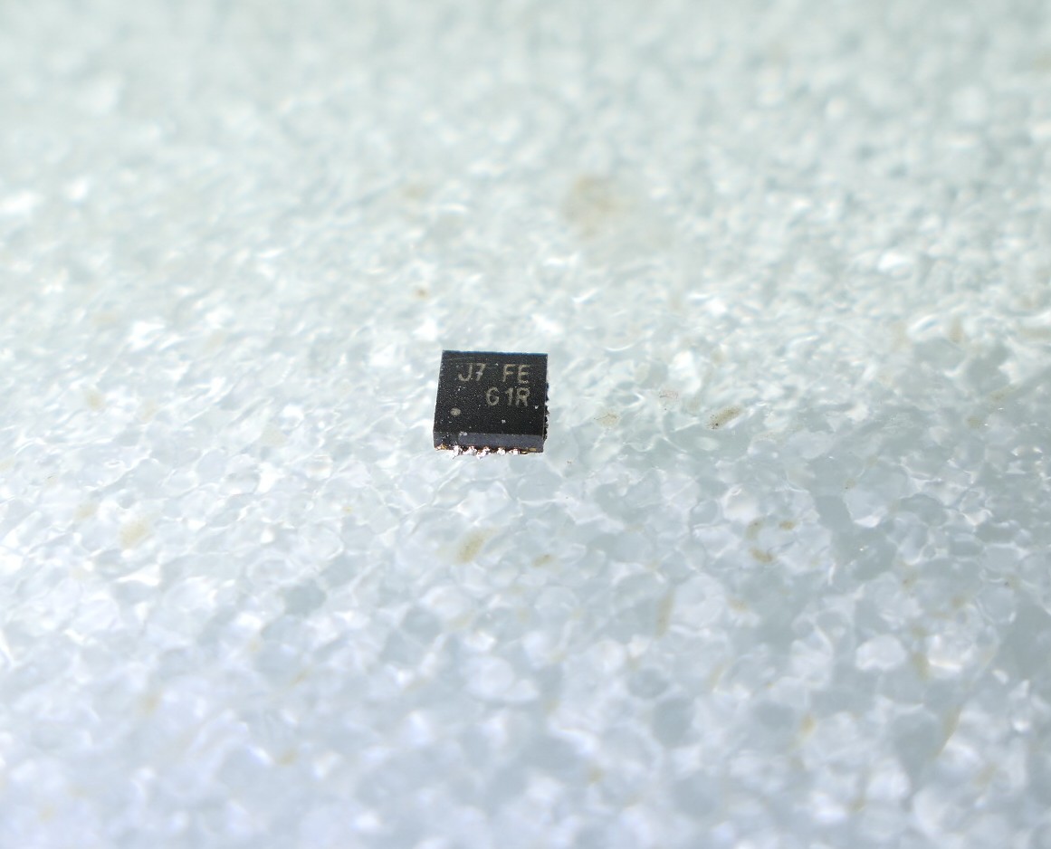

          Hello friends,
          Any help in identifying this chip would be appreciated.
          Is part of a motherboard for a HP model m6-k054ca laptop.
          Many thanks,
          Ray
            • 21841
            Re: Trying to identify IC in HP model m6-k054ca laptop
            Originally posted by rddube
            Hello friends,
            Many thanks,
            Ray
            Probably a richtek part https://www.badcaps.net/forum/showpo...84&postcount=2
            Just google Richtek J7 .Some richtek parts can have the same marking code but with a different number of pins
            Edit: Richtek RT8207MZQW

                A schematic is available if you want to ID anything else.The silergy part isn`t in the schematic,it has a different
                IC ,a G547I2P81U ,its pin to pin compatible
                LA-9314P https://www.badcaps.net/forum/showpo...41&postcount=4
                la-9315p https://www.alisaler.com/hp-envy-m6-...-0-schematics/

                  Re: Need help identifying a chip on a HP m6-k054ca motherboard
                  Hi SMDFlea,
                  Not sure I have the right chip as mine in photo above is a WQFN-20L, so I traced it down to this one that I found on AliExpress (will take a long time however): RT8207MZQW RT8207M J7 EB J7=EB J7-EB QFN20. The one you mention in your last post G547I2P81U, does it come in QFN20 ?
                    • 21841
                    No,its an MSOP8 package (8 leads),its the one in your first post (i merged your 2 thread together). You have the silergy SY6288D10CAC,but in the schematic at US2 it has a different part altogether ,a GMT G547I2P81U.If you need to replace it then either of them will do
