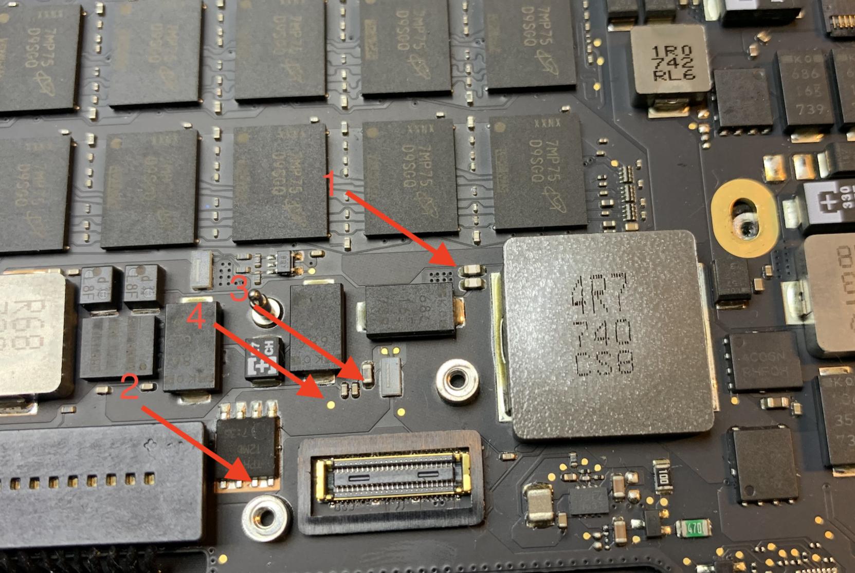

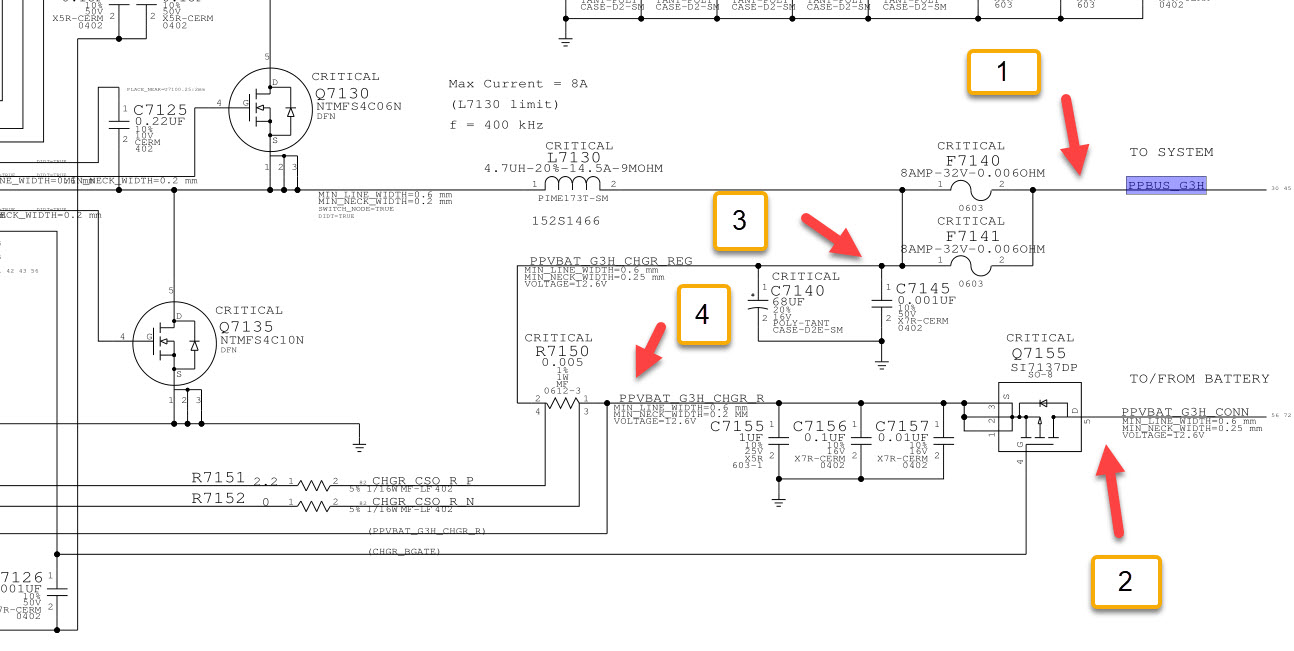

                  Using the battery ONLY (no power adapter) - meter in DC volts (20v scale is ok), check the attached points of interest.
                  Measure each and post the readings.

                    Re: macbook retina A1398 820-00138 works slowly
                    f7140 pin n2 12,30v
                    q7155 pin 5 12,30v
                    c7145 pin 1 12,30v
                    r7150 pin 1-3 12,30v
                    unfortunately the scheme is different from the logic board, I am attaching a photo, I hope I have measured well
                      f7140 pin n2 12,30v

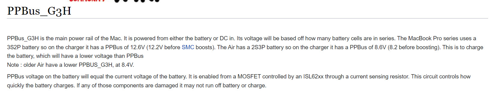

                      PPBUS_G3H is too low. This means that the SMC has not boosted the value with the battery only case.
                      reference:
                      https://www.logi.wiki/index.php?title=PPBus_G3H

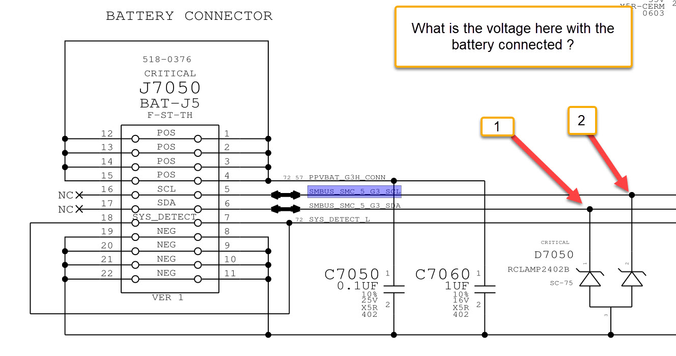

                      See attached. Check the voltage on D7050 dual ESD diode with the battery ONLY attached.
                          reference:
                          d7050 pin 1 3,4v pin 2 3,4v only whit battery
