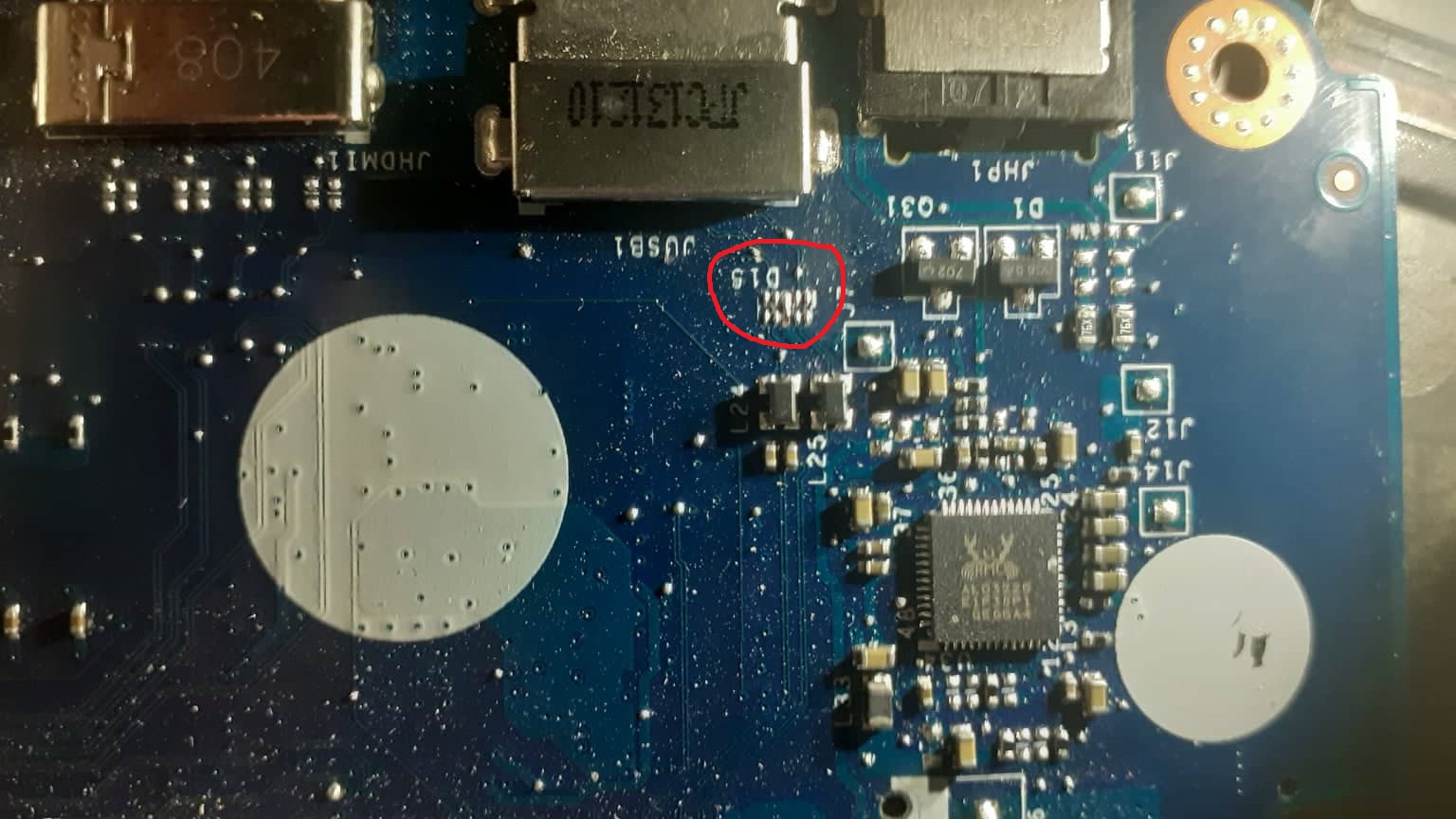

                The diode readings will allow us to review if the ESD transient diodes on the USB 3.0 port pins are damaged or not.
                Do confirm if D15 is present on your logic board or not. Assuming this ESD diode array is present.
                U2DP0_L
                U2DN0_L
                PS: The USB 2.0 signal lines do NOT have any ESD protection = very cheap logic board and may not even pass CE requirements. We pay < $ 0.05 USD for a USB protection device in low volumes of 5k-20k / order from offshore mfrs.
                  U2DP0_L
                  U2DN0_L
                  Can only imagine how low cost the same product will be if purchased in the volumes of this logic board mfr. Zero excuse to not include the ESD devices on the USB 2.0 port pins other than a cheap quality design by amateurs.
                  no D15
                  this motherboard is trash .
                  • mon2
                    • Dec 2019
                    • 14077
                    Re: Acer e1 usb not worknig
                    Still check the readings of each to ground for the USB pins.
                    Very lame of them to not stuff this low cost ESD protection device which most likely has caused many failures out in the field.

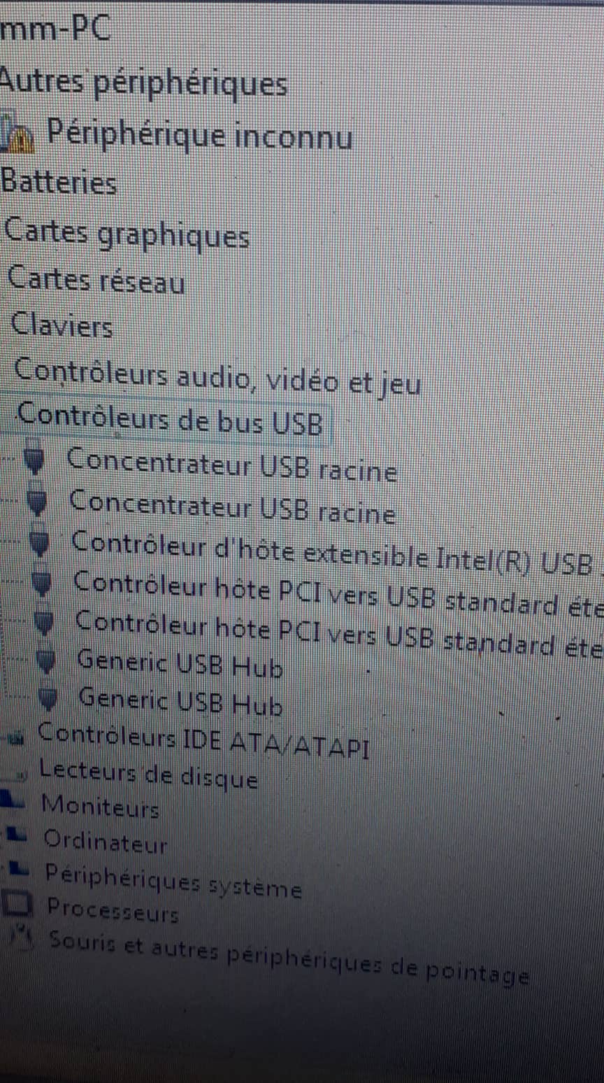

                        When you boot into Windows -> do you see the presence of the USB interface in the device manager tree ? This should be the very bottom of the Device Manager tree -> click the '+' to expand the view.
                        If you launch the camera app -> does the app complain that the camera cannot be found ?
                        • mcplslg123
                          • Jun 2015
                          • 7262
                          • india
                          all USB+webcam not working-its a sure sign of bad pch . You need to replace the SOC/PCH. If you are interested in replacing it and have the necessary tools/skills, then do read my microcode guidance(Sticky thread) before replacing.
                          • mo000
                            • Nov 2017
                            • 276
                            • algeria
                            yes usb interface is present
                            yes camera not found .
