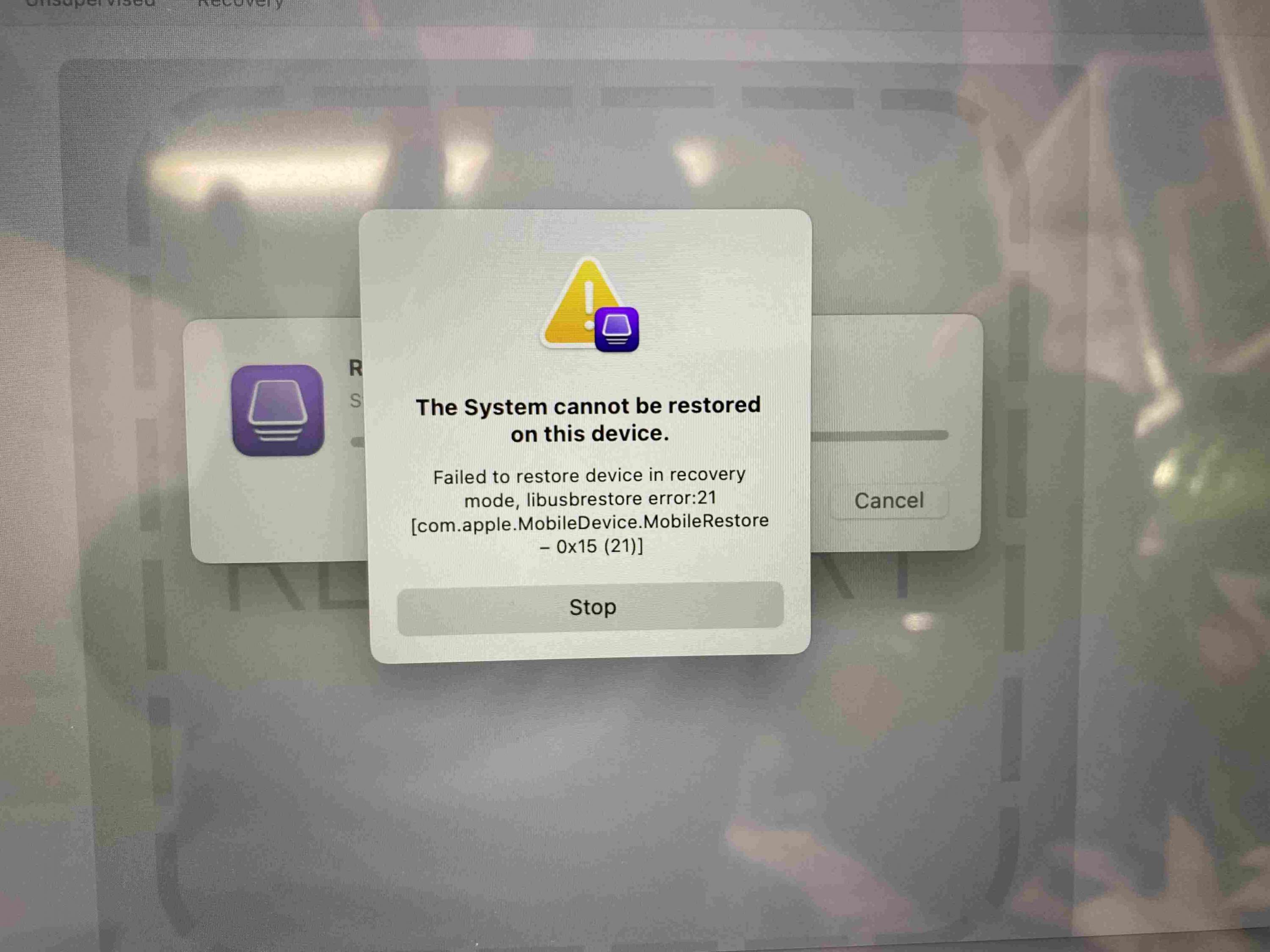

    Hi All, I am working on a MacBook Air A1932 (2018) No Display, motherboard 820-01521-A. It is totally clean & no sign of any liquid spill on it, like new. I notice that this notebook is going easily into DFU mode & while trying to restore, it give me the error, please check photos. In the background all seems to be working, CPU gets hot & the trackpad vibrates & the fans moves too. What can be the problem, any help would be greatly appreciated. Thanks

    Error 21 resolution is posted here:
    https://logi.wiki/index.php/DFU_Mode...roubleshooting

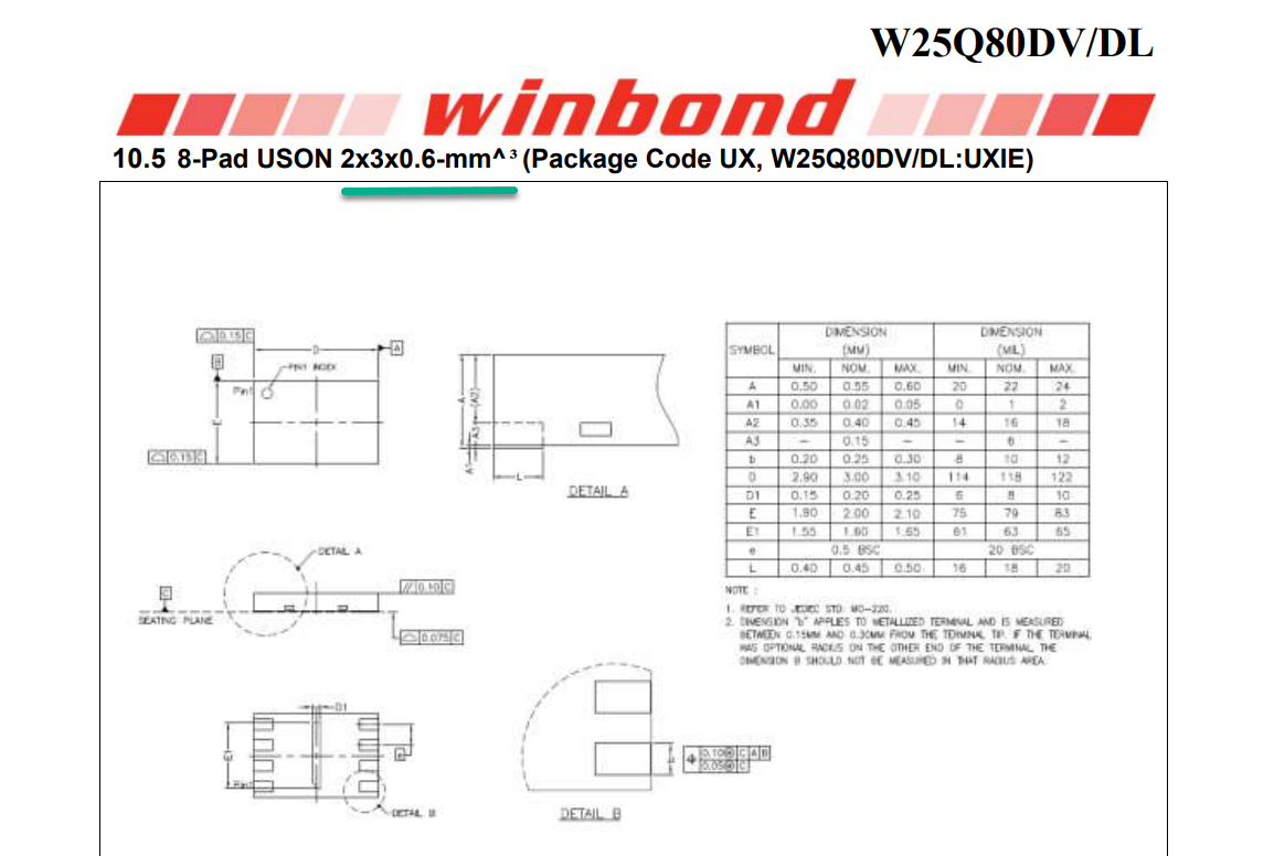

            I am using the Universal Programmer RT809H Serial ISP Programmer & the T2 chipsets W25Q80D & AT25SL321(ISP) description is there in the programmer software. Now I think I just need this socket "A1989 Rom Socket Assistant U2890 Notebook Chip W25Q80DVUXIE Adapter USON 2x3 0.5" available on eBay. Maybe I can give it a try, never know might have a solution in hand.

              Hi. Yes, the linked adapter should work for your use.

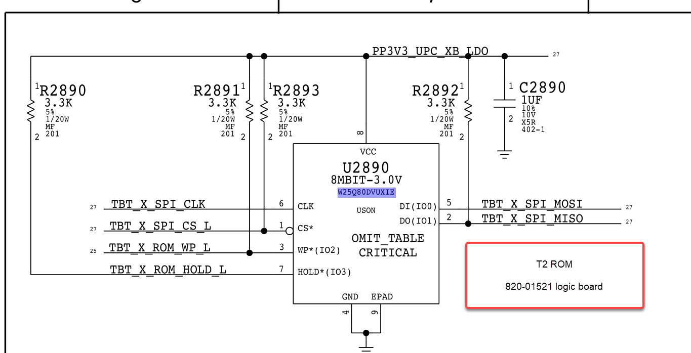

              The schematic shows U2890 as W25Q80DVUXIE. Datasheet is attached.
              Upon review of the schematic, the Vcc for this flash device is 3v3 and not 1v8 as originally thought.
              It should work as noted.
              Comment: We may be indexing the wrong flash device - this the THUNDERBOLT flash which is used to hold the firmware for the ACE controllers (CD3215).
              The T2 rom I have read is 1v8 so for that we DO require a level translation IC to convert your 3v3 signals to 1v8 else the flash device can be killed.

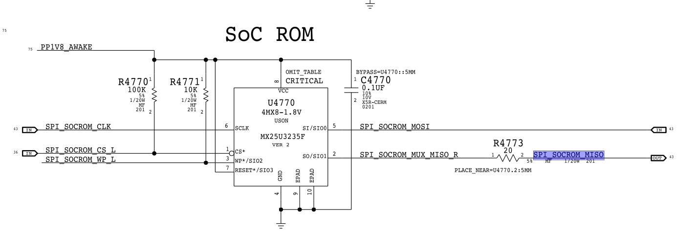

                T2 rom appears to be @ U4770.
                See attached.
                p/n MX25U3235F (1v8 for the Vcc)
                4MX8
                Check to see if your programmer can support this device.
