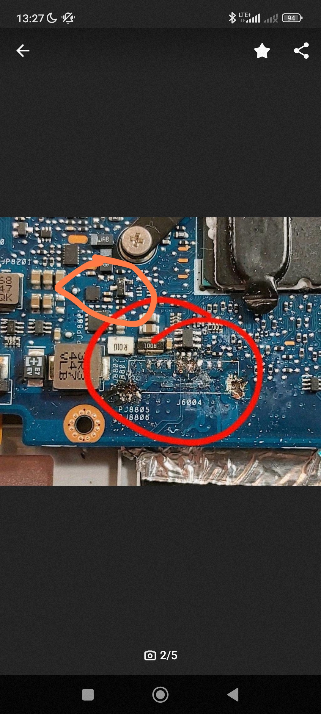

              Yes, its the data line from the battery connector.
              I removed the battery and measured again with only the ac plug.
              Clk gives me again 3.3. data went to 1.3
              Do you mean this little part, marked in orange?
              • mon2
                • Dec 2019
                • 14663
                Re: Asus Ux303UB, Battery not detected after mb change
                Yes, that could be the one.
                Using the same meter setting -> check the voltage on each of the pins on the side with 2-pins. If this is the correct part, then one side will be 3v3 = SCL pin.
                The other pin on the same side will be the low voltage = 1v3 or whatever.
                Once it is confirmed, remove this part off the board -> apply flux and hot air and use tweezers to remove it.
                Then check the voltage again on the pads on the logic board at this location.
                If ok for both pins and ~3v3 for each -> attach the battery and test again.

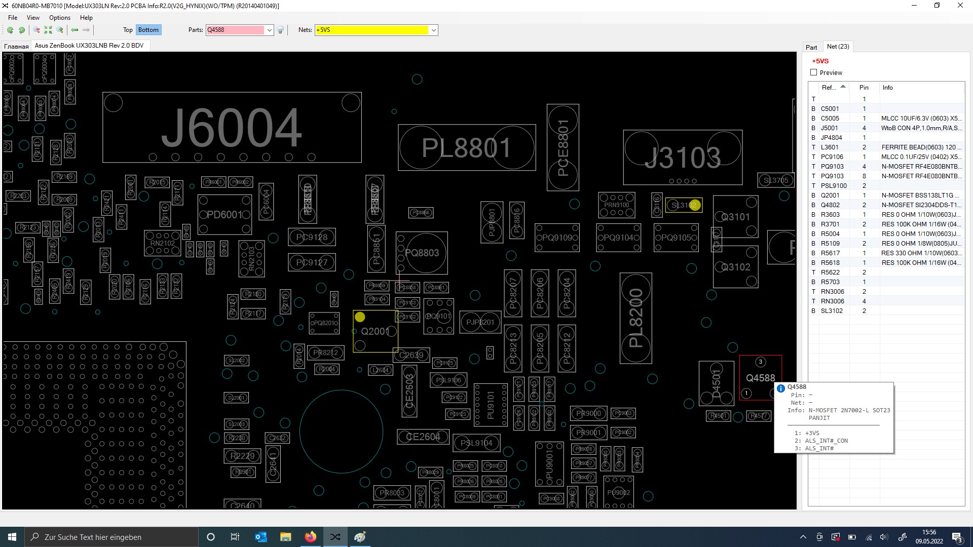

                  ok, i guess its not the right part,
                  this one measures 5v on the left side of the pin. rest is 0.xx

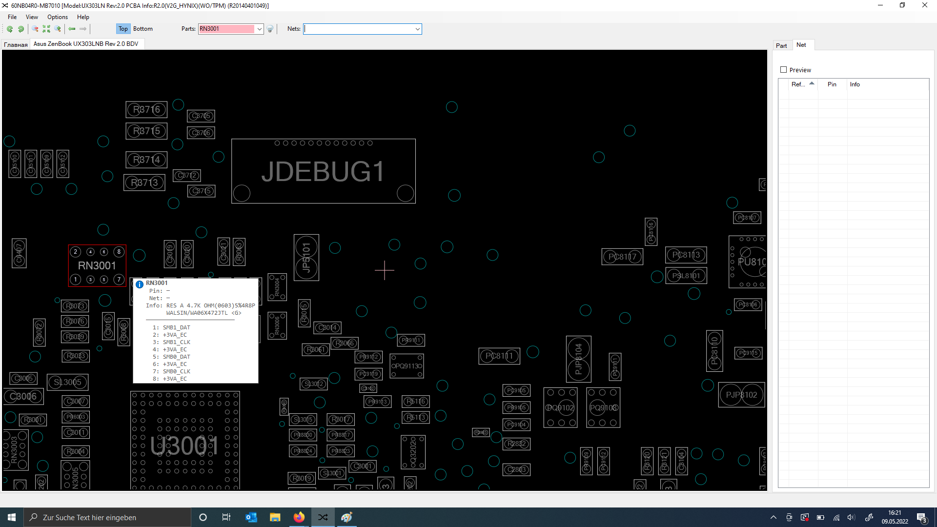

                  i found this part here. It has 3.3v on each side, but i dont know if it belongs to the battery.
                  picture 2

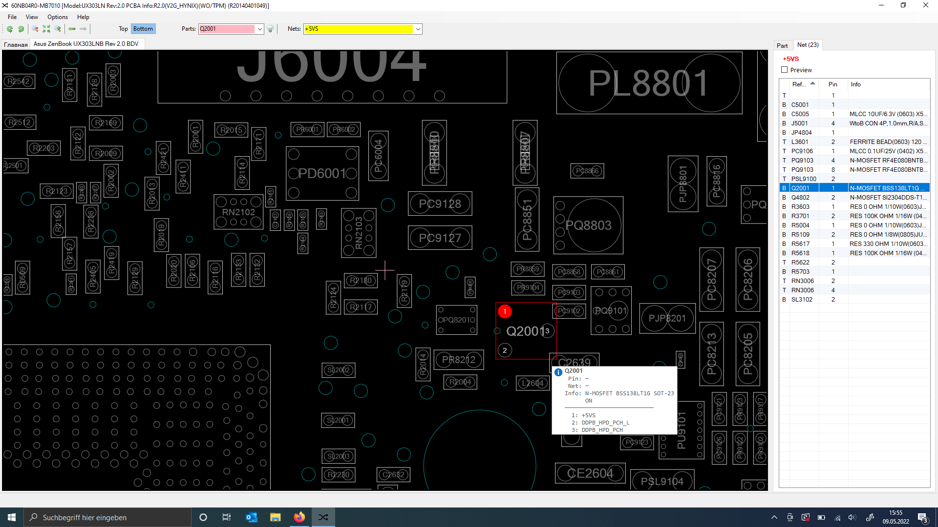

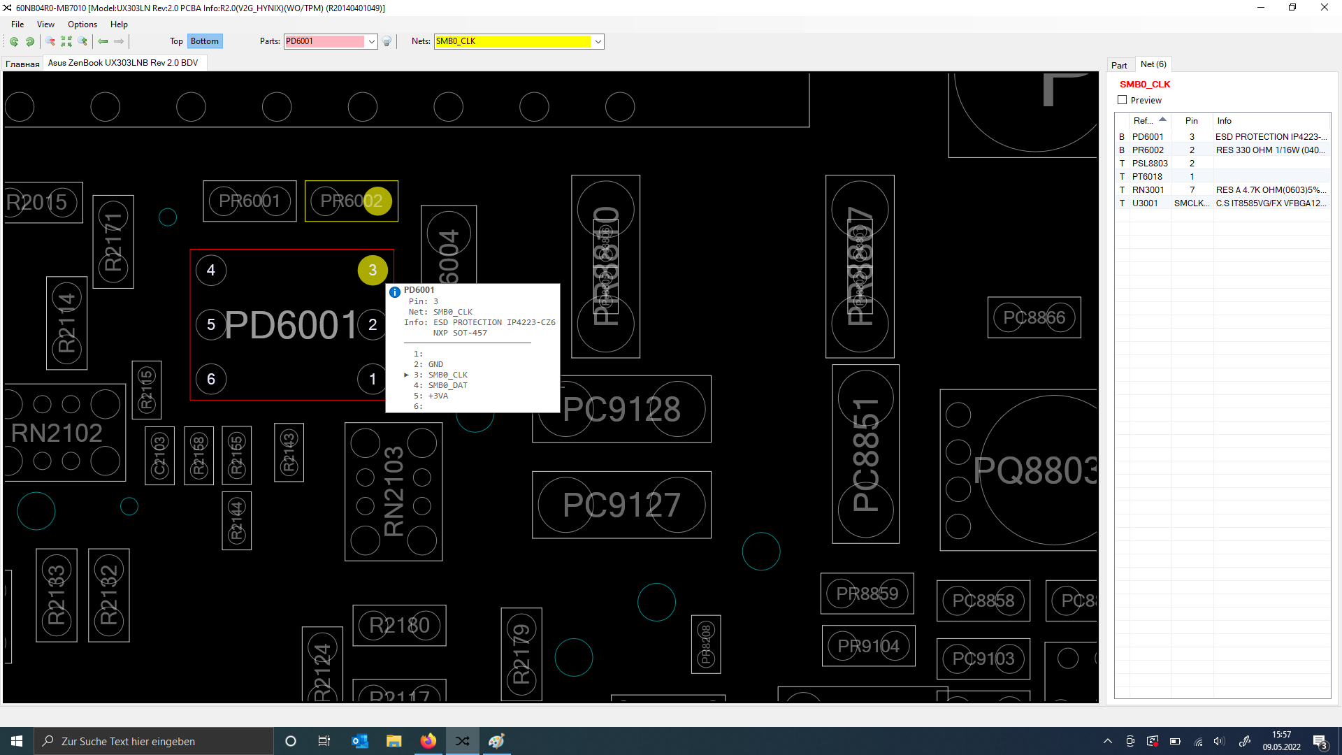

                  what im wondering is, that i cant find another SMB0_DAT and SMB0_CLK besides on this litte ic next to the battery
                  picture 3
                  EDIT
                  omg i made it!
                  i found out, that SMB0_DAT wasnt routing to the ic on the other side, while SMB0_CLK was. took a wire and connected from battery to other side of the board and it started with battery!
                  thank you so much for you help anyway. guess i couldnt find a solution without you
