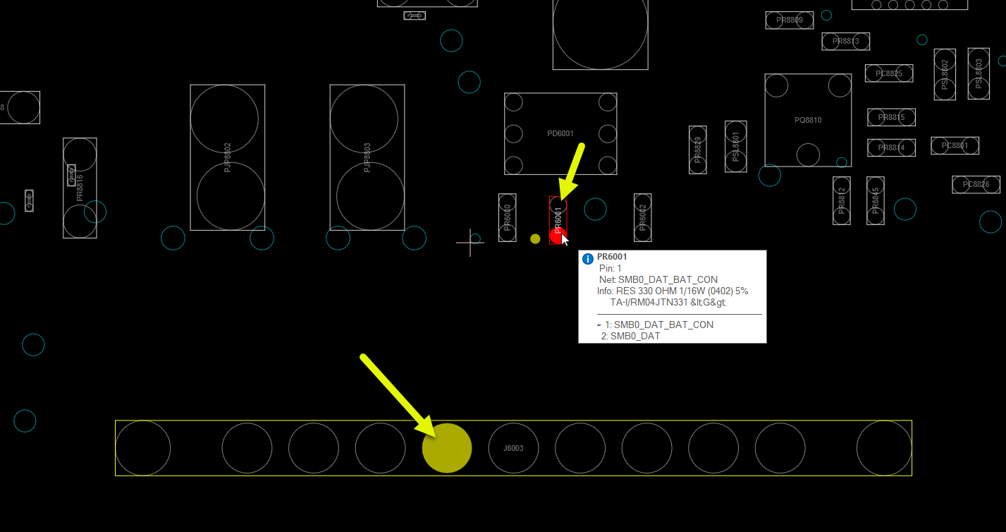

          • mon2
            • Dec 2019
            • 14240
            Re: ASUS X455L Battery not detected problem.
            See attached.
            Between the battery connector and this missing ESD diode network, there should be a series 330 ohm resistor.
            Remove all power. Meter in resistance mode.
            Check the resistance from the one side of this series resistor and the battery connector.
            What is the resistance in ohms ? Measure between the 2 yellow arrows.

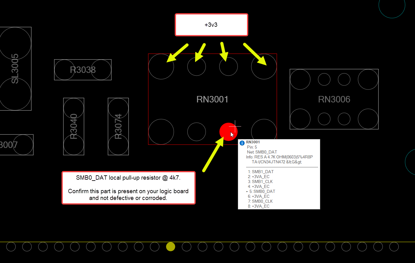

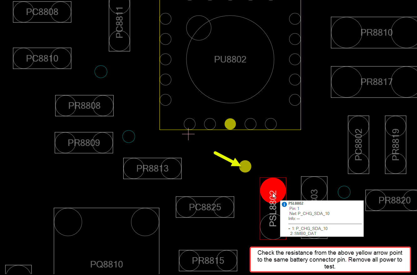

              • bustacaps
                • Jun 2022
                • 7
                • Philippines
                Originally posted by mon2
                See attached.
                Yes, there is a 330ohm resistor. It reads 324ohms.
                The one side of this series resistor(PR6001) and the battery connector(pin4)=324ohms.
                RN3001 is present and not corroded it reads--4k25ohms on those pins you indicated.
                PSL8802 to pin4 is 342ohms.
                It seems all values are good sir...
                • bustacaps
                  • Jun 2022
                  • 7
                  • Philippines
