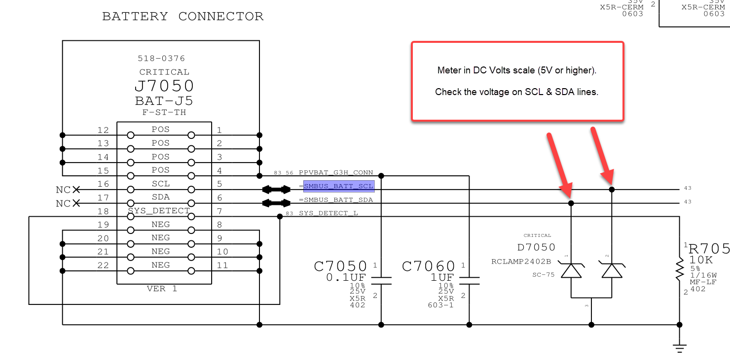

        Re: MacBook Pro 15" Late 2013 no chime or boot but green light on charger
        Ok.
        See attached. Meter in DC volts mode (5V or higher is ok).
        Check the voltage readings (with adapter & battery connected) of:
        SMBUS_BATT_SCL
        SMBUS_BATT_SDA
        @ D7050, pin # 1 and # 2. Black meter lead to ground. Red meter lead to diode pin.
              Pin 1: 3.4V
              Pin 2: 3.4V switching to 3V back to 3.V constantly
              • Gigabit2
                • Apr 2022
                • 264
                • United Kingdom
                Possible is just bad probing on Pin 2, showing 3.3V to 3.4V oscillating on re-test

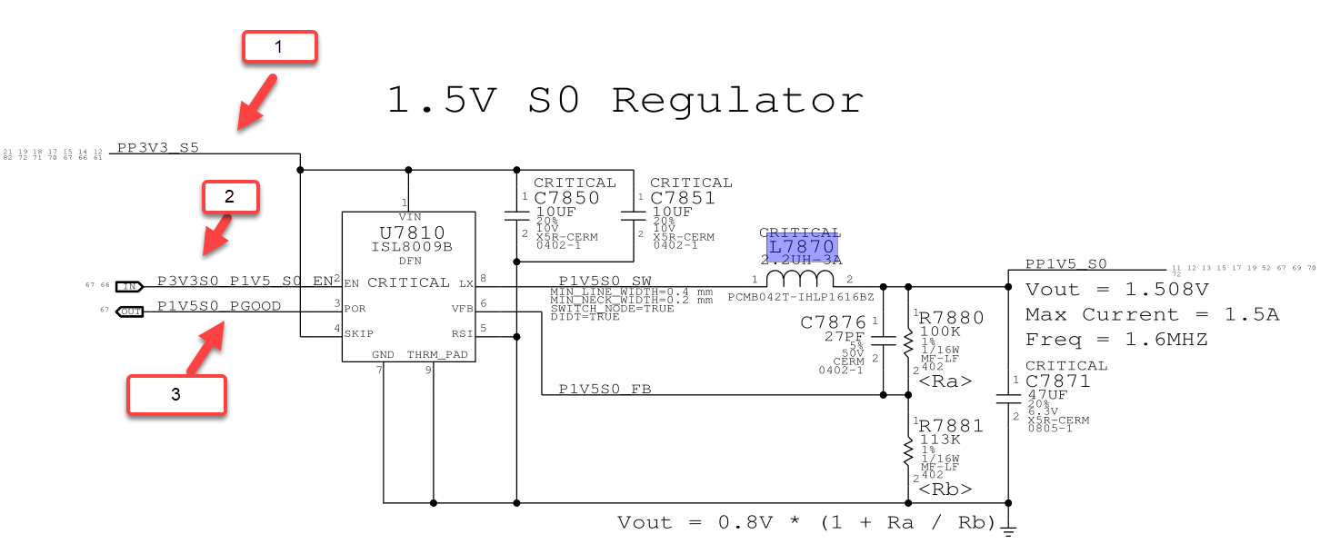

                            I noticed PP1V5_S0 is very low, showing only on 300m mode.
                            I looked at U7810, PP3V3_S5 is okay at 3.3V but pin 8 is coming out as 300m as above.
                            I already replaced U7810 and the issue remains - I also replaced all components in this circuit.
                              I apologise, is wrong board. Is actually 820-3362-A!
                              Unable to locate this board - is it 820-3462-A ?
                              No U7810 in the schematic...
                                  Ok, after a bit of a chase, for future readers, the schematic to use for the 820-3662-A is the 820-00138. Makes perfect sense to me
                                  Measure the voltages of points 1, 2 and 3. Post each reading.
                                  Then remove all power -> meter in resistance mode -> measure the resistance to ground of L7870, pin # 2.

                                      • Gigabit2
                                        • Apr 2022
                                        • 264
                                        • United Kingdom
                                        Pin 1: 3.32V
                                        Pin 2: 3.22V
                                        Pin 3: 0.58V
                                        L7870 resistance: 3.75 on 20k mode.
