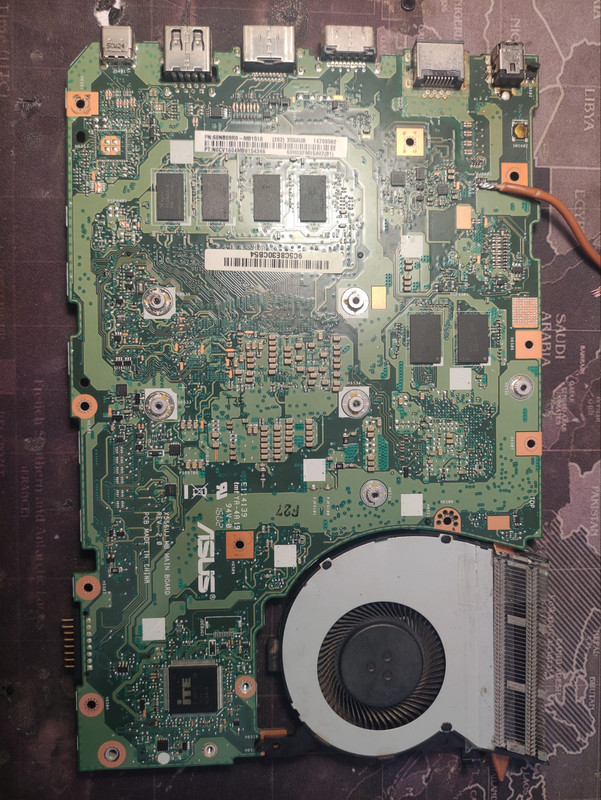

                            The cable that i soldered was on the back. To use my power supply , to find the short in case there is one.
                            But it doesn't "draw" any Ambs my power supply. It stays in 0.00 even if i use 3.0v
                            I even removed the first (2 mosfets) just in case i can see something else, that is wrong. Nothing again...

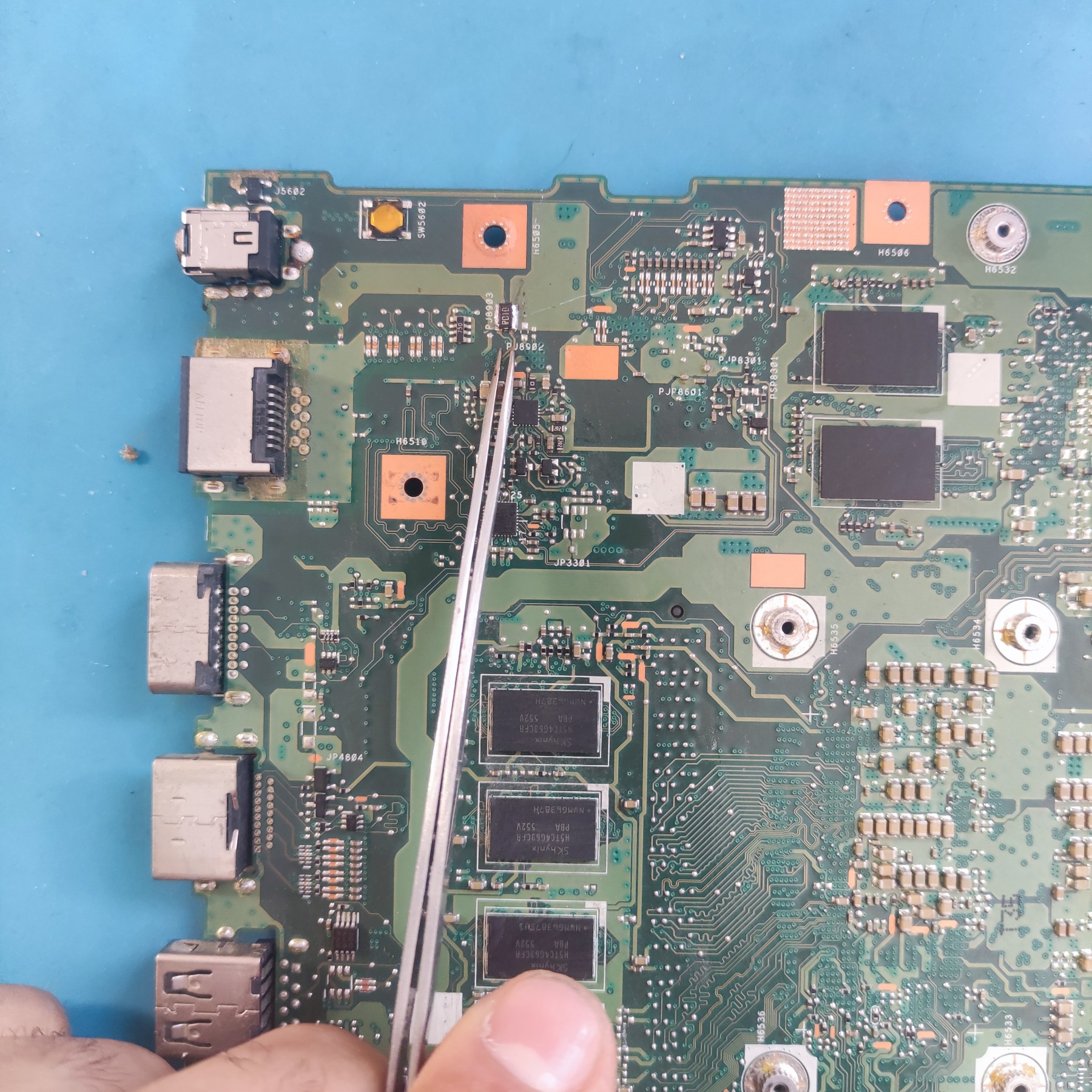

                                  Something else that i found.
                                  All the red circles, are beeping , in both ends. ( i removed them and still they were beeping)
                                  I removed the green chip (that i circled in case this was the problem) but again the beep is in all capacitors .
                                  The rest that are around and are NOT circled they are not beeping (only 1 side)
                                  But the ones in red, they all beep in both ends...

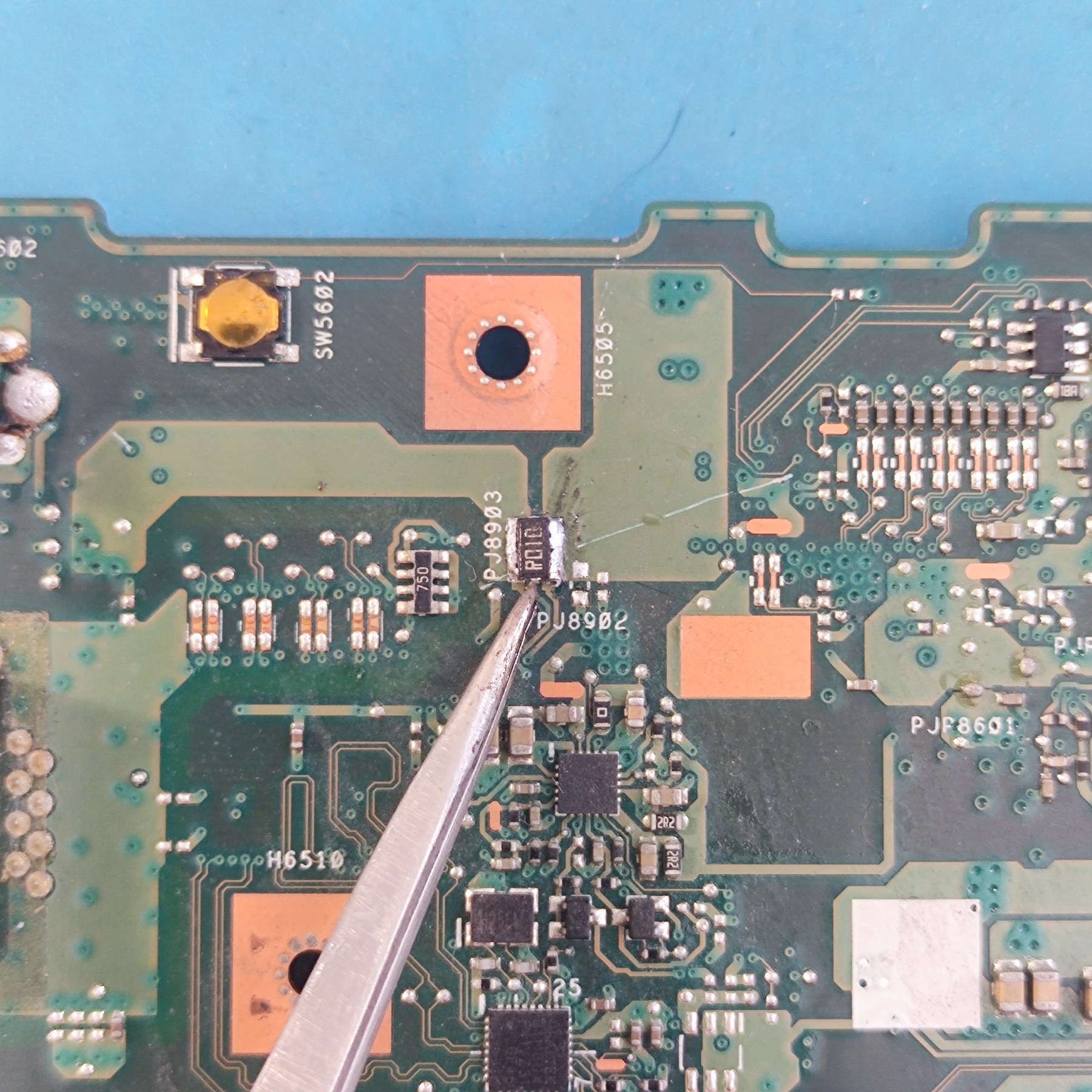

                                      The pin8, after a while it shows 0,86 (in my multimeter with selection of the 2M Ωhm)
                                      Now, i found something else...
                                      QFN-8 , G4 GUE , 2R0F04 chip.
                                      One shows the resistance 0,510...the next to it ,shows only 1/4 of the value .
                                      Here is picture.
