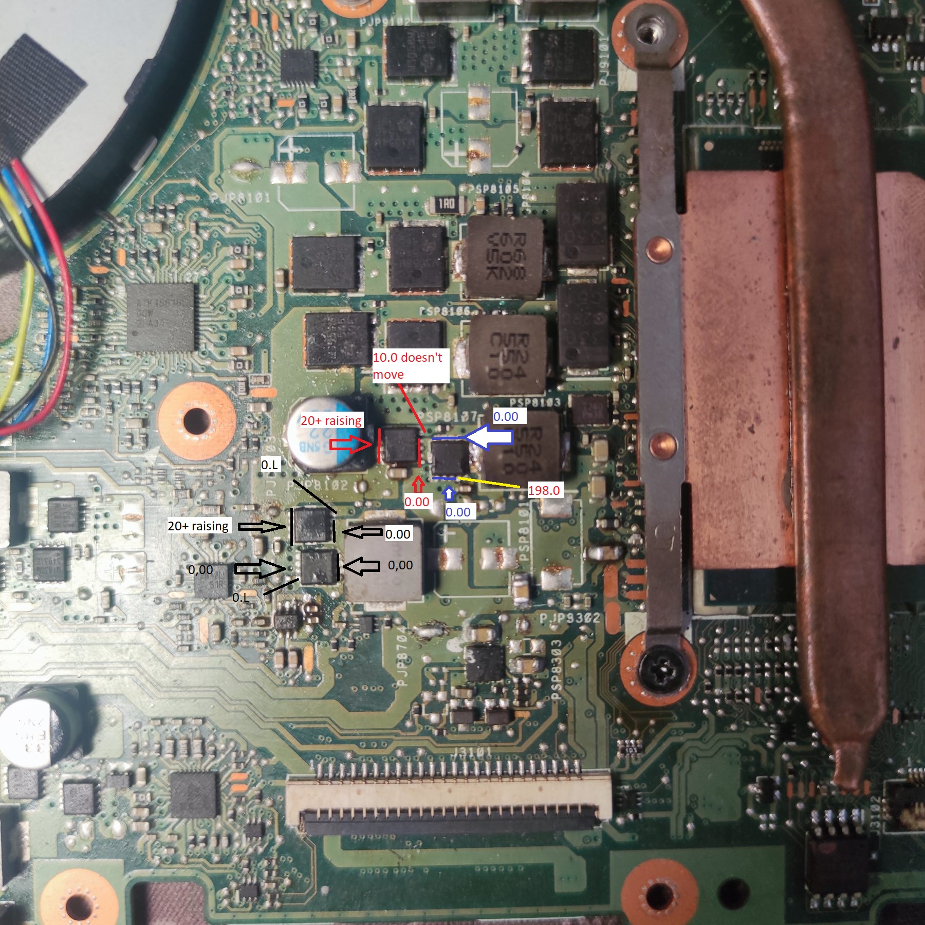

    Have you still got your meter on the 2M scale ? ,put it on 200 Ohms scale and post the measurements again

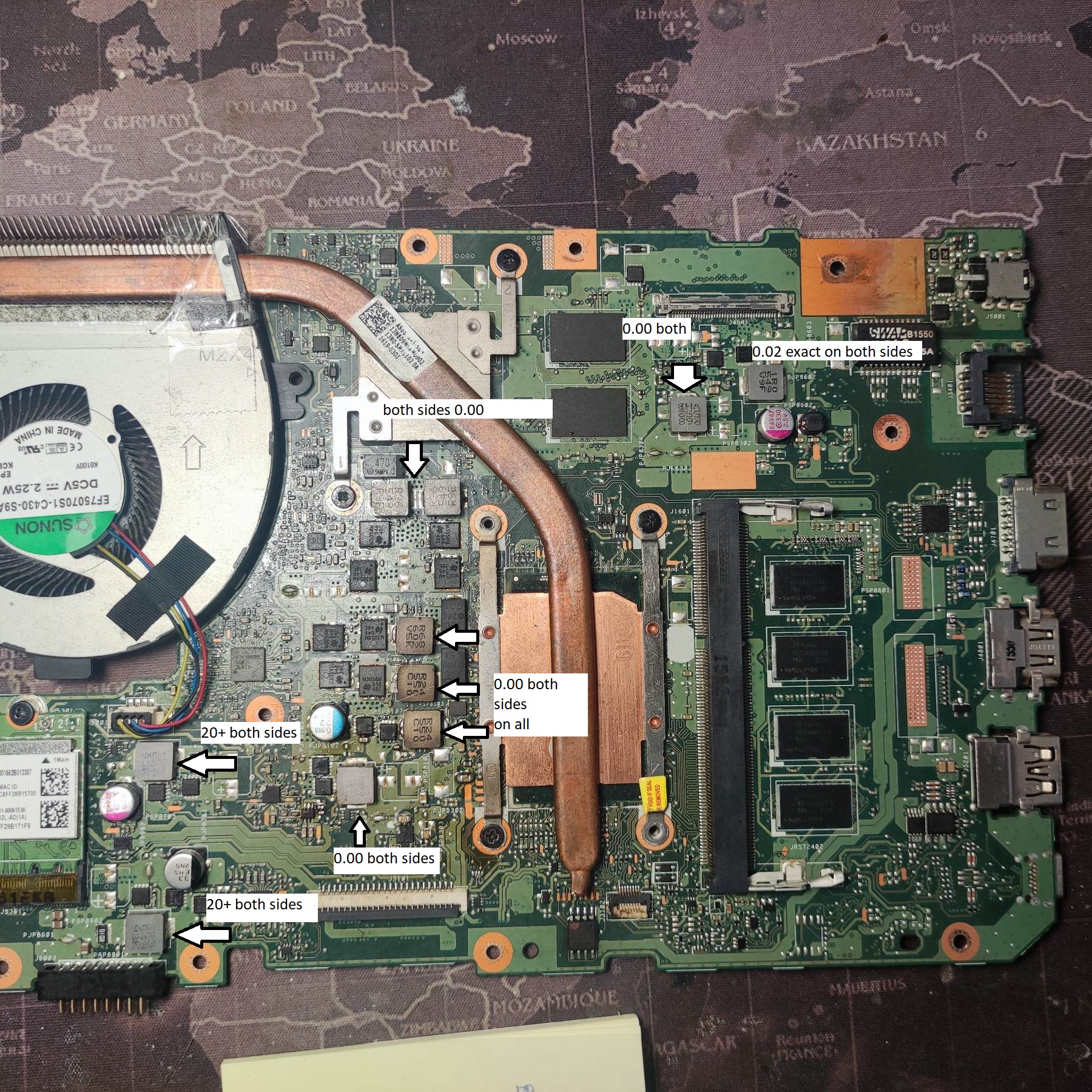

      Re: X556UJ-XO114T with i5 6200U & Nvidia 920M ?
      Done it with 200Ohms as requested.
      Here is the picture with coils measured to ground,and the chips (mosfets measured as well )
        I think i was correct ,about which chip is dead?
          Solder the 2 mosfets back,plug charger in and test voltage on PR8911 .Unplug charger and post resistance on all large grey coils
          PR8911 , shows 187K and slowly raising all the way to 192~ and then slows even more (Measure to 200K on meter)
