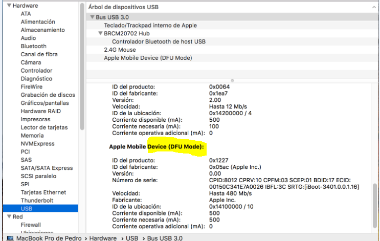

    Hi, this A1932 820-01521 has 5V 0.60A at the input usb-c (both inputs are the same)
    PPBUS_G3H is present and all the AWAKE and SLPS2R also are ok.
    Seems that "Device stuck in DFU mode due to corrupt T2 firmware", as it is mentioned in this good link:
    https://repair.wiki/w/A1932_2018_-_2019_MacBook_Air
    I have tried to download Apple Configurator 2 from Apple Store, but the mac I used seems not good for this app. (osx high sierra)
    I have tested dfu mode state with this mac in siystem information.
    I will try to use a hackintos pc but not sure if it is possible to get this app running in this type of machines.
    Any comments will be appreciated.

    Re: A1932 820-01521 DFU mode?
    Preferable to use the same macOS version between target and host. Or at least having older macOS on the host than the target can definitely cause issues.
    https://logi.wiki/index.php/DFU_Mode_Restore_(Macs)
    https://mrmacintosh.com/how-to-resto...into-dfu-mode/

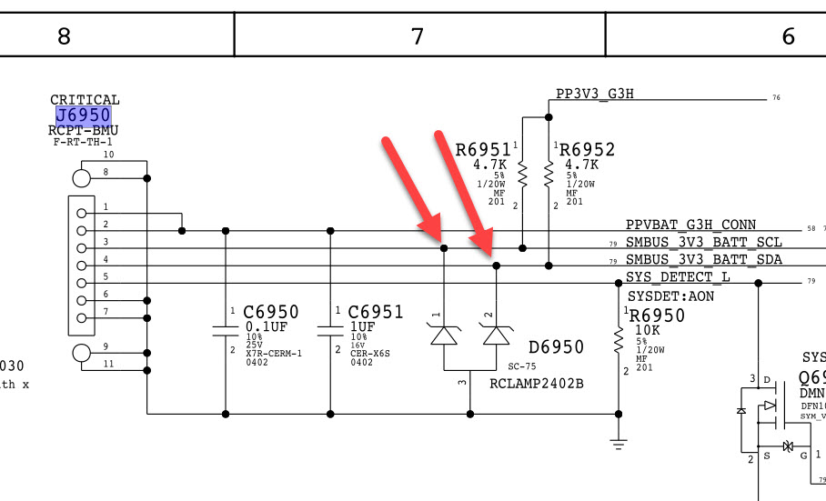

          • mon2
            • Dec 2019
            • 14662
            On the battery not being detected, see attached.
            SMBUS_3V3_BATT_SCL
            SMBUS_3V3_BATT_SDA
            Check the voltage on D6950 to confirm the I2C / SMBUS interface lines are not being clamped down. These points should be ~3v3 for each = lines are high impedance and the local pull-ups @ R6951 & R6952 are used to pull them to a 'soft-high'.
              SMBUS_3V3_BATT_SCL
              SMBUS_3V3_BATT_SDA
              Hi mon2, this data bus are ok.
              Have 3v pulses on both lines.
              Battery should be damaged, it has been damaged by some liquid.
              The controller chip inside battery, has disabled its output.
              Time for a new battery.
              Thanks for your help.
