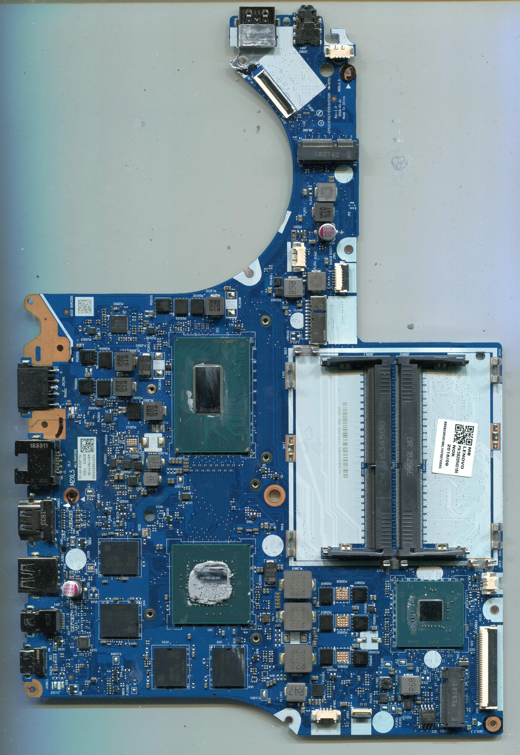

    Hi

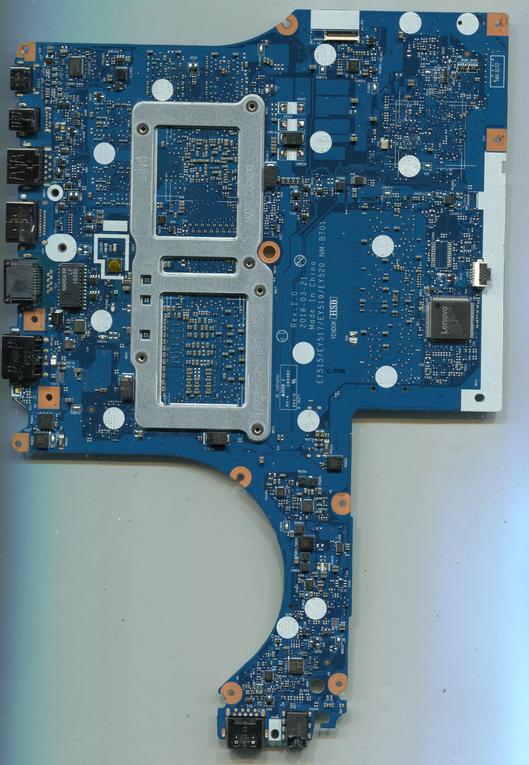

    Im trying to repair a Lenovo Legion Y530 that turns on but has no display or external display.
    ive already tried resetting it and removing ram one at a time to see is there is any change but it did not work.
    the laptop just turns on and fans both spin but no screen, nothing.
    the schematic and boardview ill try to attach below...any help would be greatly appreciated since im new to board repair but im trying to learn.
    With no power , no charger , no battery no Cmos coin ,
    With multimetre at diode mode , red probe at GND and with black probe taking all the measurements at All the grey coils i get this
    PL601: .440
    PL602: .310
    PL201: .548
    PL1401: .228
    PL3102: .004
    PL2101: .117
    PL1801: .102
    PL5802: .001
    PL5801: .001
    PL5803: .001
    PL901: .058
    PL3201: .016
    PL3004: .002
    PL3001: .002
    PL3002: .002
    PL3003: .002
    as for the mosfets, i only have 7 measurements so far but i will try to get the rest of them tomorrow.
    the 7 readings i have so far are
    PQ601: D-408 S-310 G-738
    PQ602: D-310 S-0 G-425
    PQ603: D-407 S-439 G-871
    PQ604: D-440 S-0 G-425
    PQ201: D-1.665 S-1.625 G-1.635
    PQ202: D-408 S-1.625 G-1.635
    PQ206: D-549 S-0 G-346

    Re: Lenovo Legion Y530 turns on but no display or external display
    Good , since there's no short can you take the voltages measurements .
    Consumption on dc supply
    Ram socket =
    pin 255 = VDDSPD
    pin 111 = VDD_1
    pin 258 = Vtt
    pin 257 = VPP_1
    pin 254 = SDA
    pin 253 = SCL
    pin 108 = PCH_DRAMRST
    PLT_RST# = UE1 = pin 22
      but arent these ones considered a short since the diode reading is this low?
      PL3102: .004
      PL5802: .001
      PL5801: .001
      PL5803: .001
      PL901: .058
      PL3201: .016
      PL3004: .002
      PL3001: .002
      PL3002: .002
      PL3003: .002
      • mcplslg123
        • Jun 2015
        • 7262
        • india
        You should'mt measure resistance on Diode mode. Instead use resistance mode(200 Ohms ). Newer mb with onboard soc will show very low resistance on cpu/gpu rail. Anything near 002 Ohms is not considered short on 8th gen onwards. On GPU even 0.500 ohms is not short on new age gpu's. So its confusing but with experience and exposure to many boards, you can judge by yourself which one is shorted. Many engineeres do the fatal mistake of taking it as short and start random injection of voltage and thus killing the SOC.

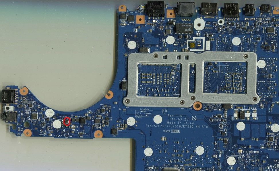

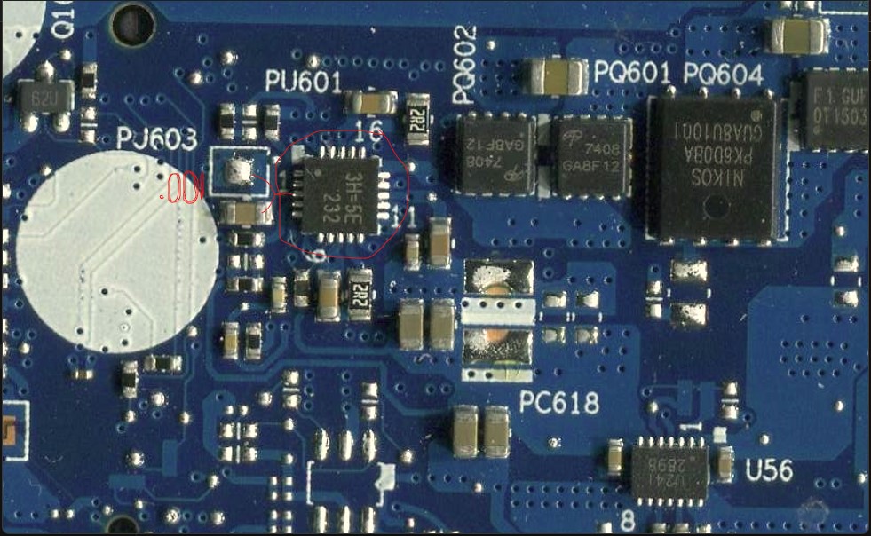

          i tried taking the ram measurements after pluging in the power adapter and i messed it up elsewhere on the board.
          now i have no power at all
          when i plug in the power adapter to the board the PU601 gets extreamly hot and in diode mode on pin 3 i get .001 and also on the capacitor next to it .001
          but all the other pins on that PU601 i get good measurements in diode mode.
          i removed the capacitor next to it PC603 which also gave diode reading of .001 but problem remains. it still gets extreamly hot (the PU601) and i have no idea what i should/need to do now
          • D87
            • Mar 2022
            • 10
            should i remove/replace PU601 ?? anyone know or have suggestions?
            i attached the information i found on the PU601 below

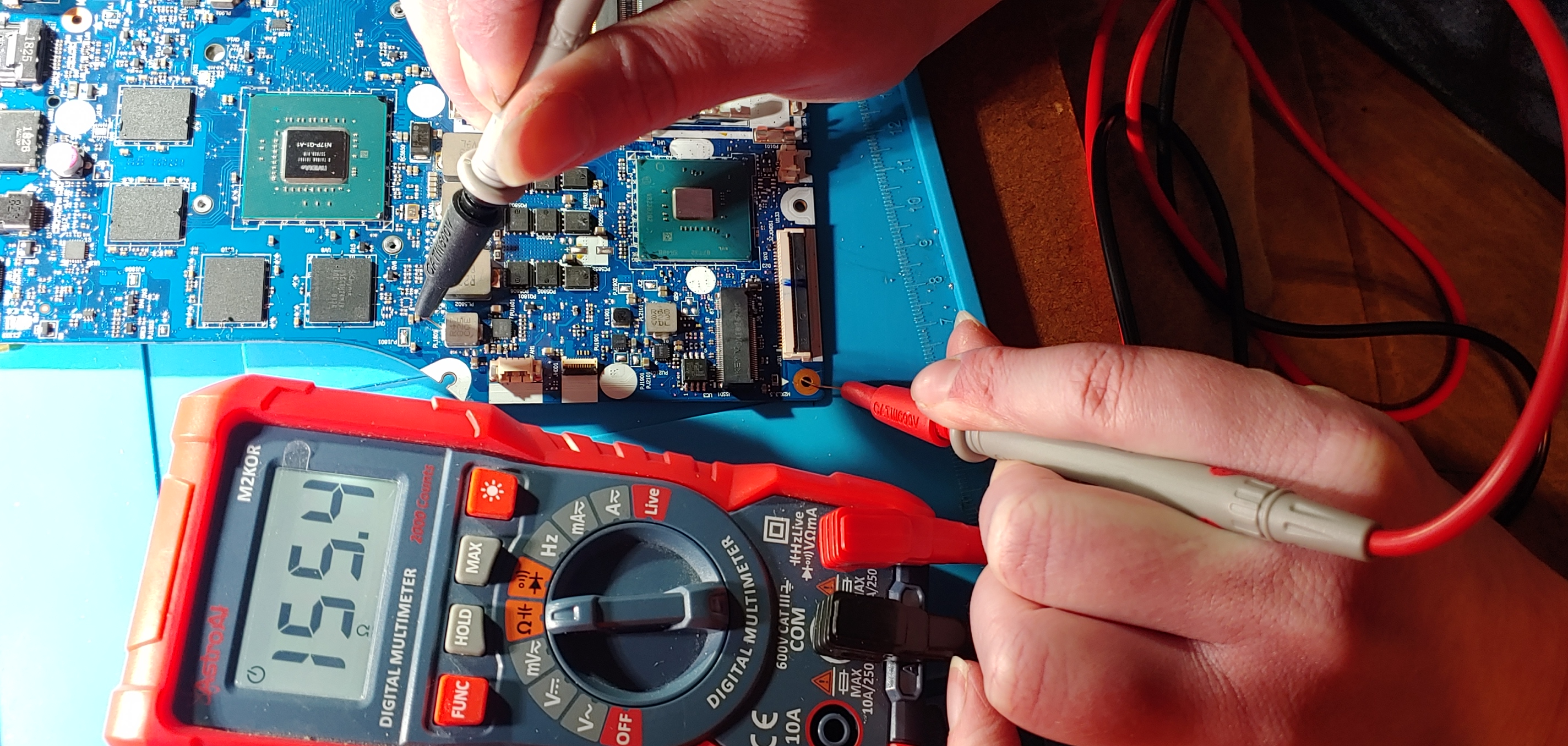

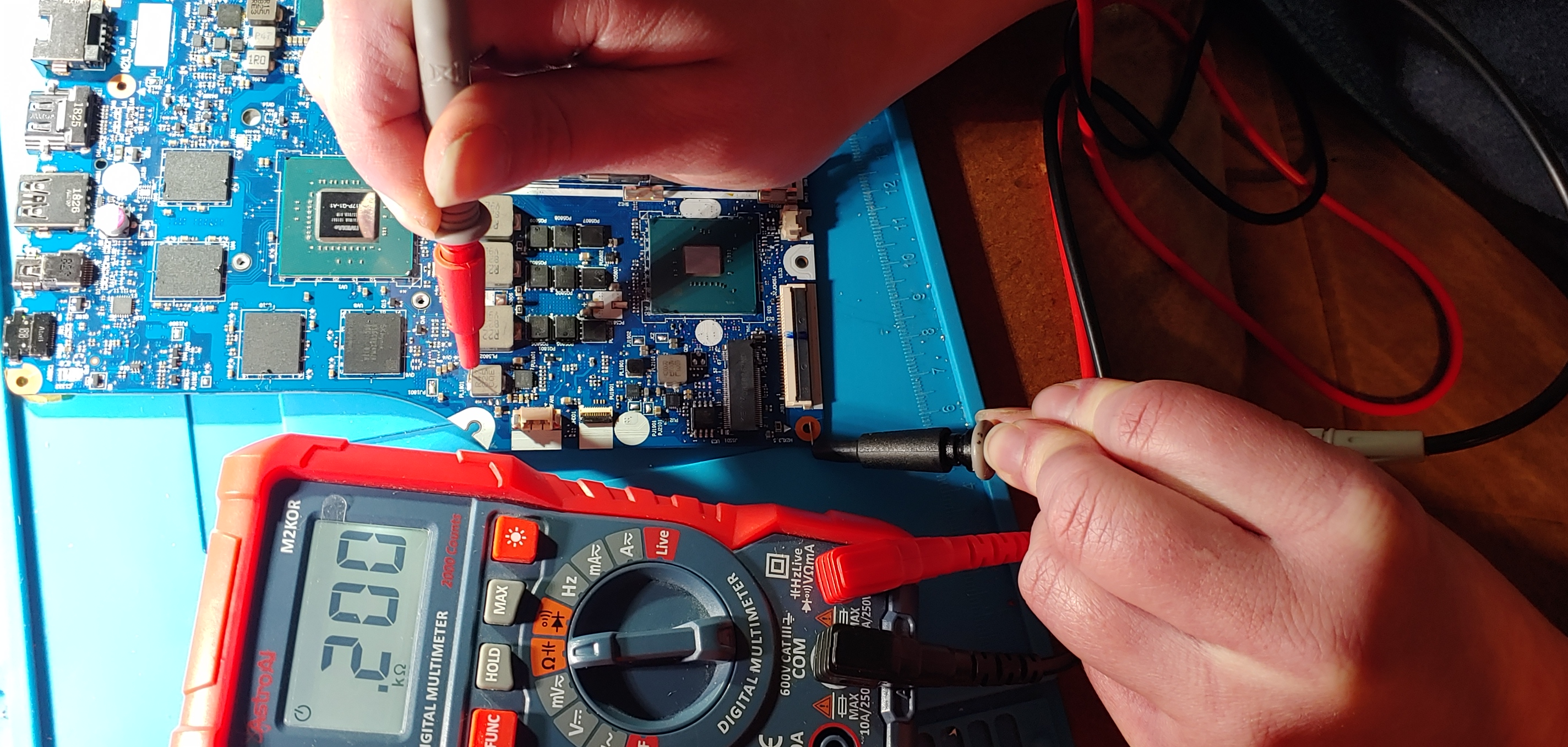

              Hi, meassure again, in resistance mode, PL1801, it should be arround 80 ohms
              • D87
                • Mar 2022
                • 10
                i was not sure how to measure in resistance mode ...im used to diode mode so anyway i tried once with black probe on ground and red probe to PL1801
                and then the other way around with red probe on ground and black measuring PL1801 i shared the pictures of the measurements below

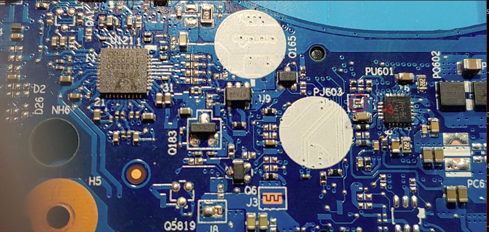

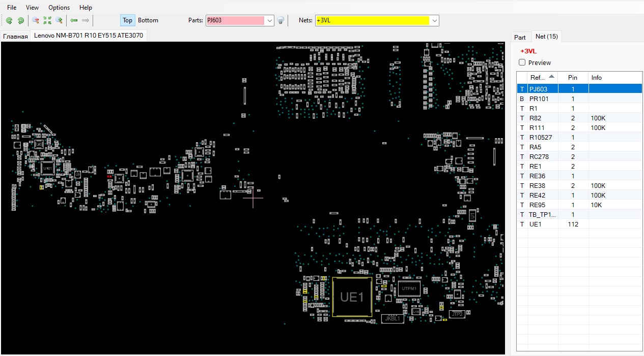

                • D87
                  • Mar 2022
                  • 10
                  also i did remove PU 601 but short was still on the pin 3 pad on the motherboard so i removed PC603 to check again but still short remained so i put them back and removed the jumper PJ603 connecting +3VLP to +3VL and now the short is gone from the pin 3 of PU601. (which is +3VLP)
                  so im not sure where to go from here, i followed +3VL from pin 1 of PJ603 jumper and below you can see 15 nets it shows on the boardview but again i dont know what to do now so any advice and or help would be greatly appreciated
