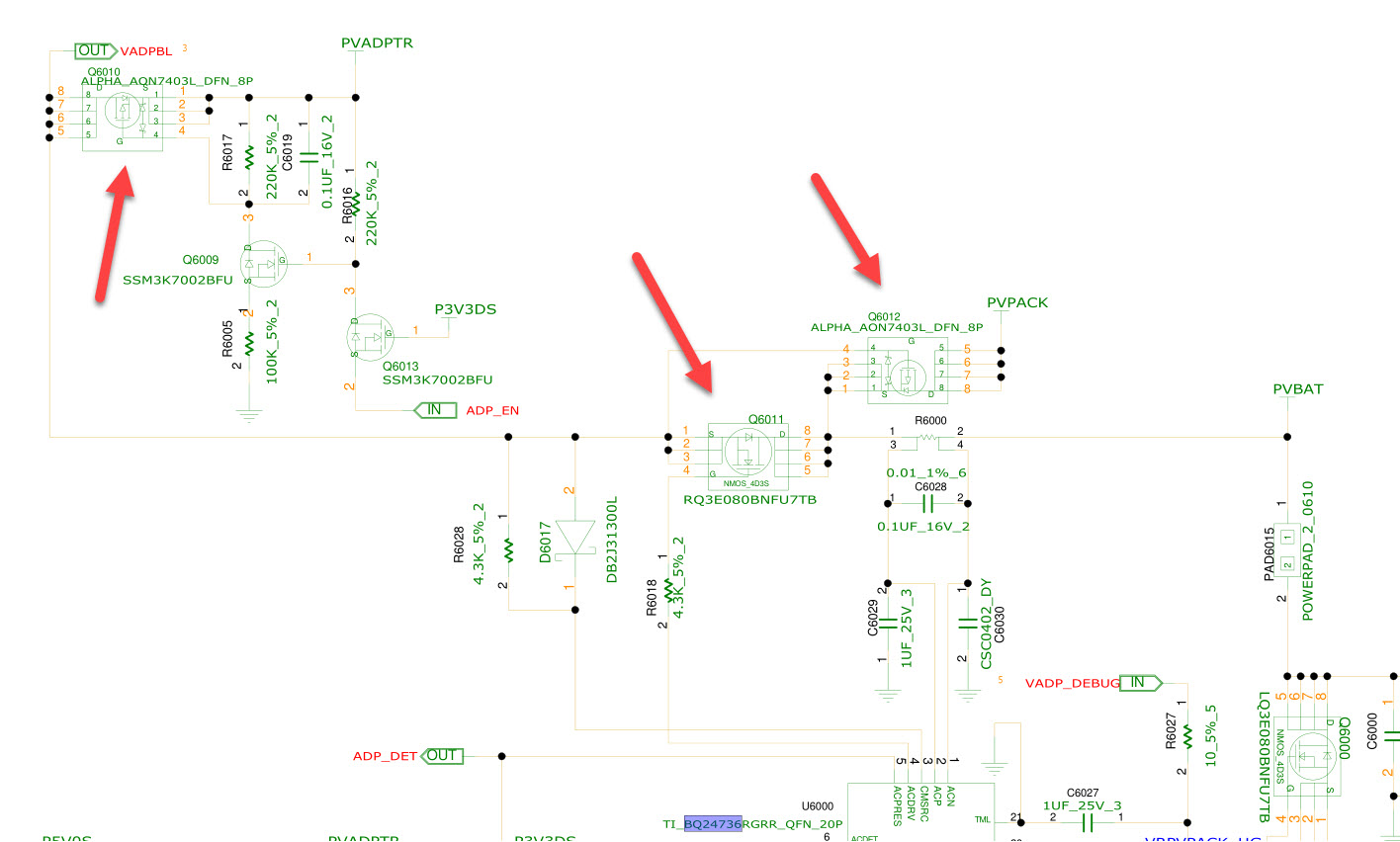

    Re: hp elitebook 840 g2 turning on and off
    Start with the adapter - is it 90W as recommended by the vendor? Does the adapter work ok and supply the DCIN voltage ?
    What is the adapter voltage ?
    Next, remove all power -> meter in resistance mode (2k scale is ok).
    Check if the first 2 mosfets are defective by checking their resistance.
    Measure the resistance between:
    (Mosfet @ Q6010)
    source (1-2-3) & drain (5-6-7-8)
    source (1-2-3) & gate (4)
    gate (4) & drain (5-6-7-8)
    If you see 'OL' = over limit - then increase the resistance scale to the next higher setting on your meter and measure again.
    If you see a low resistance reading, the mosfet is defective and needs to be replaced.
    Repeat the test with the next mosfet @ Q6011 and again Q6012.
    Post the readings.

      thank you for your response.
      i believe the mosfets are okay, because there's voltage supply into the system.
      here are what you requested for:
      1. the adapter is rated 90W
      2. all the voltages are okay- 19.83V and 19.26v
      3. there's supply of DCIN voltage
      4. resistances- q6010 89.5k, 205.3k; q6011 205.3k, starts from 20M but continues to drop, reverse prob gives 21.32k; q6012 same with immediate previous, the other side fluctuates in K ohms
      but reverse prob gives 0.562k.
      5. q6011 19.83v; q6012 0.8v.
      in summary voltage gets to r6000.
                q6012
                source and drain 37.32k
                is too low IMHO. Replace Q6012.

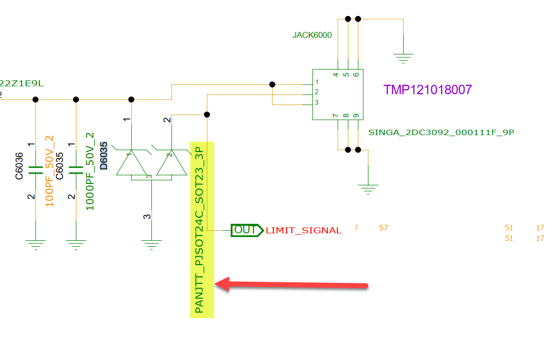

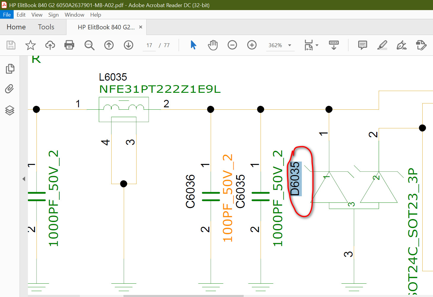

                                what is this in this diagram (d6035) near chargin pin
                                transister or what????? and no
                                Can anybody tell me plzz
                                    where are u all guys
                                    Sleeping. Rest is sometimes required...
                                    See attached. If you copy and paste the markings shown in the schematic, you will find the vendor = PANJIT. They are a company out of Taiwan.
                                    Then go to their website or any of the many resellers of their parts and stuff in the other markings in the schematic.
                                    This is a surface mounted SOT23 packaged DUAL ZENER DIODE rated @ 24 Volts. The drawing of the arrow head with the slanted lines = ZENER diode.
                                    The direction shows that it is a UNIDIRECTIONAL DIODE so the component is protecting only the positive side of the power rail.
                                    In summary, the component will trigger to suppress any voltage > 24 volts on the line. There are 2 diodes in the single package, so it can protect 2 lines.
                                    As long as the voltage on each line remains under 24 volts, this part will not be active. If > 24 volts, it will attempt to suppress the voltage to the save and max value of 24 volts.
                                    The part is not critical and can be purchased from any vendor (does not have to be PANJIT brand). I think my mom makes these. Check your local suppliers for:
                                    'SOT-23 packaged dual zener / tvs / ESD diode @ 24 volts, unidirectional'.
                                    The part should be < $ 1 USD. For sure you can buy from Aliexpress.
                                    PS: If you have a logic board where this part is damaged then this means some in-rush surge was placed on this rail and the component was killed in an attempt to protect the rest of the logic board from being damaged. This can happen in power brown outs, etc. or with a bad power adapter.
                                    Update - the datasheet is attached for this part. Order the version that is rated @ 24 Volts !! Any brand of this part will work - nothing special here to replace this component.
                                        The following should work fine to replace this defective component:
                                        ONSEMI ESD7272LT1G
                                        https://cdn.badcaps-static.com/pdfs/...195d4e8444.pdf
                                        ONSEMI SM24T1G
                                        https://cdn.badcaps-static.com/pdfs/...c04ef91804.pdf
                                        ST ESDA25L
                                        https://cdn.badcaps-static.com/pdfs/...5f0415f8e5.pdf
                                        ST ESDA25LY
                                        https://cdn.badcaps-static.com/pdfs/...322e89e16c.pdf
                                        Mouser has the above parts in stock but as noted, you can find them on Aliexpress or mention the details to the store on Aliexpress and they will find a suitable replacement from their local markets.
