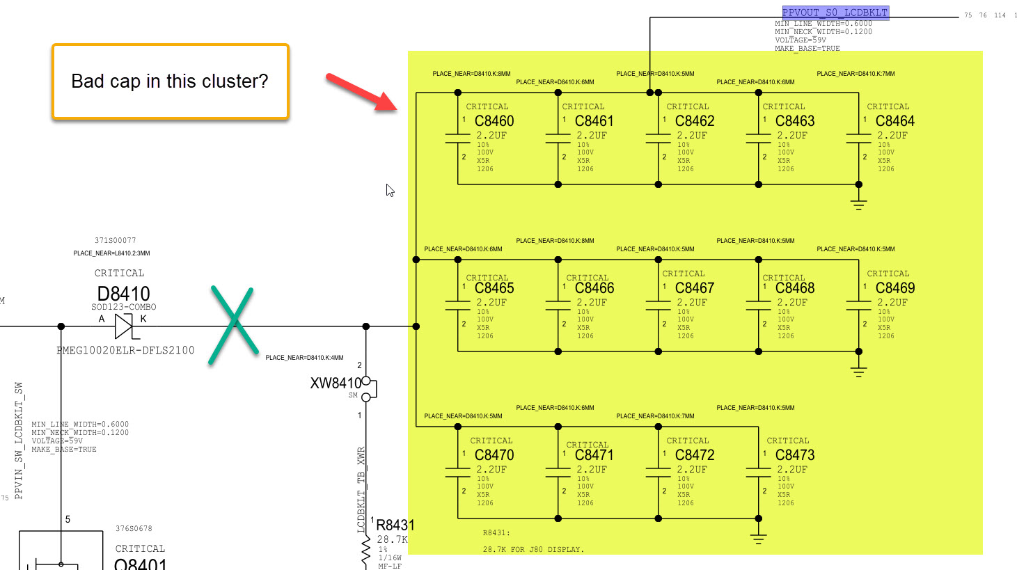

              PPVOUT_S0_LCDBKLT = 1,8Kohm
              This resistance, in my opinion, sounds low.
              Can you remove the LCD display and check the resistance to ground again of this rail (PPVOUT_S0_LCDBKLT) ?
              If the resistance is still low WITHOUT the LCD display, then proceed to desolder one leg of the diode @ D8410. Then check the resistance again to ground of PPVOUT_S0_LCDBKLT.
              This method should allow us to isolate the possible bad cap between D8410 and the LCD display.
              Post your readings. Do not power up - just use resistance checks.

                PPVOUT_S0_LCDBKLT (no LCD) = 3,1Kohm
                PPVOUT_S0_LCDBKLT (no LCD neither D8410) = 2,5Kohm
                I injected voltage on the "cluster" (without LCD and D8410), to see if any capacitor warms up, but nothing happens.
                After that, I checked again the resistance on PPVOUT_S0_LCDBKLT, and the value was 178Kohm.
                So I found, every time I plug the display without power to the adapter, the resistance drops immediately to 1,8Kohm. And if I apply some voltage again, it goes up to 178Kohm.
                My only conclusion is that the display may be damaged.

                  • reformatt
                    • Feb 2020
                    • 1497
                    Re: Macbook A1707 / 820-00281-A / Boot, but no image nor backlight
                    Any A1706/A1707/A1708 that come in with backlight issues are predominantly damaged flexes in the LCD. Try another known working LCD first.
                    MUX damage only usually occurs with liquid damage on the LCD connector since the backlight voltage is right next to a data pin that goes to the MUX. Of course on models without the MUX, it destroys the CPU in this case.
