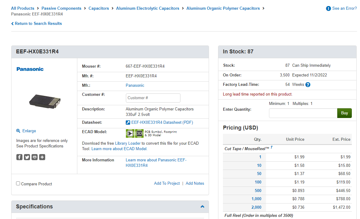

            Here is another option (Mouser has stock) - but will require some scraping.
            This one has 8.5A peak current support:
            https://www.mouser.com/ProductDetail...TRPAWp1g%3D%3D

              Looks interesting but 54 week lead time.

                Re: Apple MacBook Pro C9560 and C7771
                Weird...I see stock.
                See attached.

                  I stand corrected. I saw the long lead time and missed the 84 being available. Thanks for letting me know.
