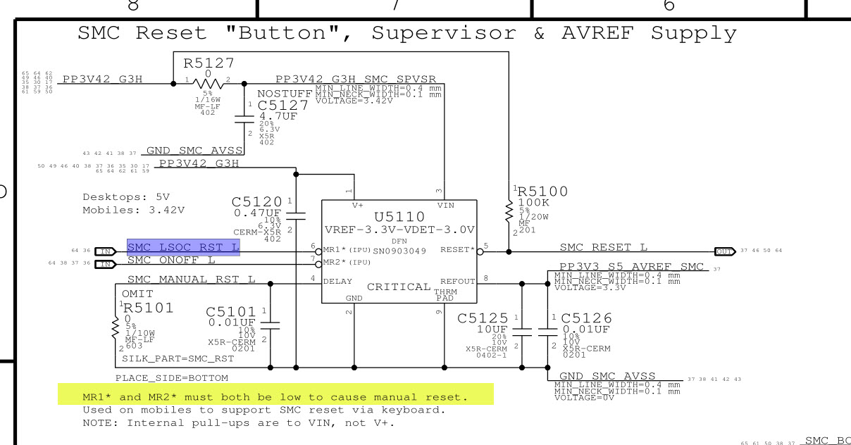

            Without the battery, confirm the voltage of SMC_RESET_L (R5100, pin # 2).
            This is an open-drain output so R5100 must be present to pull this hi-z line HIGH.

              • mon2
                • Dec 2019
                • 14634
                Re: Macbook Air A1466 does not turn on when pluged
                This one will be tricky to monitor...when you short the ON/OFF pads with tweezers, do you see the SMC_RESET_L go low ?
                  okey, i'am using oscilloscope
                  when shorting ON/OFF ( R5115 ) SMC_RESET_L does not go low ( you didn't ask but PM_PWRBTN_L goes low )
                  • mon2
                    • Dec 2019
                    • 14634
                    Do you see SMC_RESET_L go low when powered off the battery and R5115 is shorted ?
                    If you short the open-drain output line SMC_RESET_L to ground, you should be able to mimic the ON/OFF button press.
                    If you manually short SMC_RESET_L to ground, does the logic board turn ON / OFF properly ?
                    • delphi_firebird
                      • Mar 2015
                      • 36
                      • France
                      No, even with battery or charger SMC_RESET_L does not go low when R5115 is shorted ! ( it should be ? )
                      With shorting SMC_RESET_L to ground the logic board start up
                      ( by the way i think this is a manuel SMC RESET ? it has the same behavior as when i press SHIFT+CTL+OPTION + POWER BUTTON => it reset the SMC brief green light on the charger and logic board startup )
                      • mon2
                        • Dec 2019
                        • 14634
                        See attached.
                        BOTH inputs to the device @ U5110 must be LOW to drive the output low.
                        What is the voltage on SMC_LSOC_RST_L ?
                        I may have lost my way on this thread, when you use tweezers @ R5115 with the battery only - does the logic board turn ON / OFF normally ?

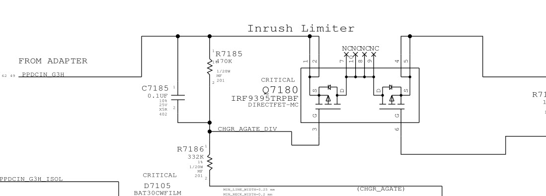

                            Using only the external power adapter, what is the voltage of the following ?
                            PPBUS_G3H
                            Next, remove all power. Meter in resistance mode. Use the lowest scale on your meter (2k is ok).
                            We want to check if you have defective mosfets.
                            Measure the resistance of the following:
                            < see attached >
                            source (1-2) & drain (7-8-9-10)
                            source (1-2) & gate (3)
                            gate (3) & drain (7-8-9-10)
                            of Q7180.
                            This is a DUAL mosfet in a single package device so repeat the above tests for the 2nd mosfet.
                            source (4-5) & drain (7-8-9-10)
                            source (4-5) & gate (6)
                            gate (6) & drain (7-8-9-10)
                            Post your (logic board's) measurements.

                            • delphi_firebird
                              • Mar 2015
                              • 36
                              • France
                              Thanks for your patience :
                              PPBUS_G3H = 8,53 V
                              Q7180 is OK there is no short
                              source (1-2) & drain (7-8-9-10) = OL
                              source (1-2) & gate (3) = OL
                              gate (3) & drain (7-8-9-10) = OL
                              source (4-5) & drain (7-8-9-10) = OL
                              source (4-5) & gate (6) = OL
                              gate (6) & drain (7-8-9-10) = OL

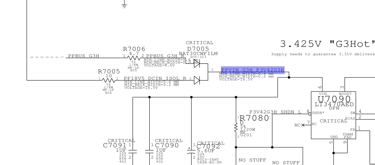

                                • mon2
                                  • Dec 2019
                                  • 14634
                                  Can you confirm the voltage of PPVIN_G3H_P3V42G3H with only the adapter?
                                  • delphi_firebird
                                    • Mar 2015
                                    • 36
                                    • France
                                    Hello ,
                                    PPVIN_G3H_P3V42G3H = 14.55v
                                    than you for your time
