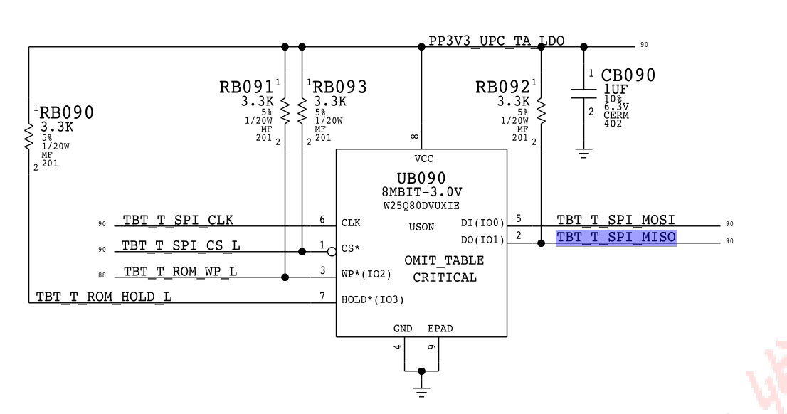

      Re: Macbook Pro A1989 820-00850-a not powering on
      reference:
      https://www.logi.wiki/index.php?titl...a91ffa8e4775a9
      Measure the voltage of:
      I2C_PWR_SDA
      I2C_PWR_SCL
      * The I2C lines are used to configure the mode and voltage out of U7000. Confirming if the I2C lines are NOT stuck which will halt the communication with the U7000 buck/boost regulator.
      and
      TBT_T_SPI_CLK
      TBT_T_SPI_CS_L
      TBT_T_ROM_WP_L
      TBT_T_SPI_MOSI
      TBT_T_SPI_MISO
      PP3V3_UPC_TA_LDO
      Post the readings.

        I2C_PWR_SDA measured at Resistor R5280 PIN #1 - 1.79V (Also same voltage when measuring at PIN #2 but see the voltage oscillating here)
        I2C_PWR_SCL measured at Resistor R5281 PIN #1 - 1.79V (Also same voltage when measuring at PIN #2 but see the voltage oscillating here)
        TBT_T_SPI_CLK measured at UB090 PIN #6 - 0.63-0.63V fluctuating
        TBT_T_SPI_CS_L measured at UB090 PIN #1 - 3.34V
        TBT_T_ROM_WP_L measured at UB090 PIN #3 - 3.34V
        TBT_T_SPI_MOSI measured at UB090 PIN #5 - 1.43-1.44V fluctuating
        TBT_T_SPI_MISO measured at UB090 PIN #2 - 3.34V
        PP3V3_UPC_TA_LDO measured at UB090 PIN #8 - 3.35V
          Do you see a steady voltage on TBT_T_SPI_MISO ?
          MISO = Master in; Slave OUT. So this is the binary output from this flash IC to the host (Master controller) for the SPI bus.
          That is, if indeed you see a static value then this flash rom is spitting out 'FF' = binary '1111 1111' = means the flash rom is blank / erased.
          Suggestion at this point is to locate a donor board with the same flash rom and apply onto here or a clone of it.
          One of the techs was supposed to post the dumps here ? Wonder if they have received it or forgot or filed under do not care. We can wait but if no one steps up on the flash rom dumps we will order the tool and post the contents.

                    TBT_X_SPI_CS_L measured at U2890 PIN #1 - 3.34V
                    Just realized that you posted this voltage but the CS# (chipselect) is ACTIVE LOW. So this line needs to be a logic low (~0v) to ENABLE this flash device.
                    Can you also measure & post the voltage of UPC_TA_SPI_CS_L ?
                    If this CS# is ~3v3, then the flash rom is not being selected. It is possible that your meter is not fast enough to capture this event (ie. could be LOW briefly and then goes HIGH after the host determines there is nothing of value inside this memory device). Sometimes, firmware will contain special header details inside the memory device that must match the expected value else it is considered to be corrupt firmware.

                      mon2 here are the measurements i took, see below and thanks for the attachment Chip Select (/CS) description.
                      UB090
                      UPC_TA_SPI_CS_L measured at Resistor RB281 PIN #2 - 3.34V
                      U2890
                      UPC_XB_SPI_CS_L measured at Resistor R3096 PIN #2 - 3.34V
                      You are right this was a tricky one to capture, but i managed it, on the multimeter so i had to have my probes ready on the logic board/flicked on my plug socket power switch and for a brief moment you can see it gets to 3.34V and then the voltage goes down to 0.00V then back to 3.34V.

                                  Hi mon2, just a update on this, so i received the replacement CD3215 and had it back soldered on to the board and i was still getting the same results.
                                  So i decided to investigate some more throughout the immediate area and noticed something was different here, i have drawn 2 arrows from Resistor R3430 and R3440 (see image below) each at PIN #2 going to each of the respective capacitors C3113 & C3114 carrying signals USBC_XA_CC1/USBC_XA_CC2.
                                  I measured using diode mode for continuity between the two points, one probe at PIN #2 of one of the resistors and one to its respective capacitor at PIN #1. I was getting the reading of 0L. So I decided to measure the other three working CD3215 at these same points for continuity and for the other 3, I am getting beeps here, showing continuity. First I thought that the replacement CD3215 was bad, so i removed it and measured again and it still measures at 0L. Do you think a bad CD3215 could cause this or if not any ideas what could be causing this to happen? Has something happened to the board internally because of the liquid damage that the board had experienced before?
                                  P.S I know there is three pads missing under the CD3215, they came off when i desoldered the replacement CD3215 off the logic board again. I am waiting for some circler soldering lugs to arrive so i can reconstruct the area.
                                  • Simplebeans
                                    • Sep 2021
                                    • 135
                                    #37
                                    Hey guys just thought I’d provide an update on this in case anyone was following. A continuation from my last post above, when I was getting the 0L continuity reading in diode mode when measuring at Resistor R3430 and R3440 at PIN #2 going to each of the respective capacitors C3113 & C3114 carrying signals USBC_XA_CC1/USBC_XA_CC2, I decided to check the diode mode readings at the FPC connector J3300 at PIN #52 (USBC_XA_CC1_CONN) and PIN #53 (USBC_XA_CC2_CONN) and was also getting a reading of 0L so i concluded that maybe the FPC J3300 connector needed replacing due to a internal short within the connector having checked everything else on the immediate U3100 circuit.
                                    I was contemplating still at replacing the FPC connector. I decided i would heat the board up one more time around the previous area of corrosion that the logic board had arrived with, and whey and behold something different again. Now when i plug the USB charger in to the USB port connected to the U3100 i still get the same result my USB tester does not switch on. However now on the other three USB ports i am getting 5V negotiated to 20V and the machine is now powering on!
                                    Ok so it’s not exactly the desired result however it seems to be against the standard curve explanation of requiring all 4 CD3215's to work before 20V power delivery can be negotiated. I have decided then now because i was undecided on replacing the FPC connector anyway as i know how these things can be to keep the machine for my work space so i can use it for testing. DFU revivals and restores if required etc as it is.
