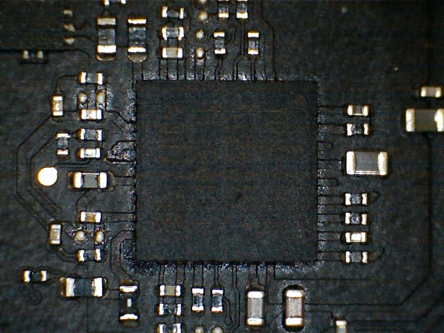

            I thought i found a boot up sequence for the CD3217 and T2 Mac here:
            https://logi.wiki/index.php/CD3217_a...er_on_Sequence
            In this sequence my board is struggeling from the PMU_VDDMAIN_EN.
            PMU_VDDMAIN_EN = 0.1 mV - to low!
            PP3V3_G3H = 3.31 V seems good
            P3V3MAIN_PGOOD = 3.2 mV - to low!
            PP3V_G3H_RTC = 3 V seems okay
            PMU_CLK32K_PCH_R = 0.87 V okay
            PCH_RTC_RESET_L = 3 V okay
            P5VG3S_EN = 0.1 mV - to low!
            PP5V_G3S = 0.3 mV - to low!
            P3V3G3S_EN = 0.1 mV - to low!
            PP3V3_G3S = 0.1 mV - to low!
            The readings that are to low are refering to U7650.
            I attached an image from this chip but to me it doesn't seems to look bad.
            Do you share my opinion, that i should try to resolder or replace this chip?
