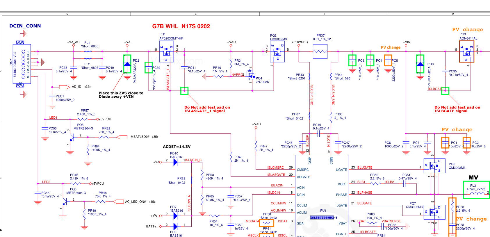

Help Id part from Hp Board number dag7admb8d0
  • reassor
    • Apr 2021
    • 176
    • Poland

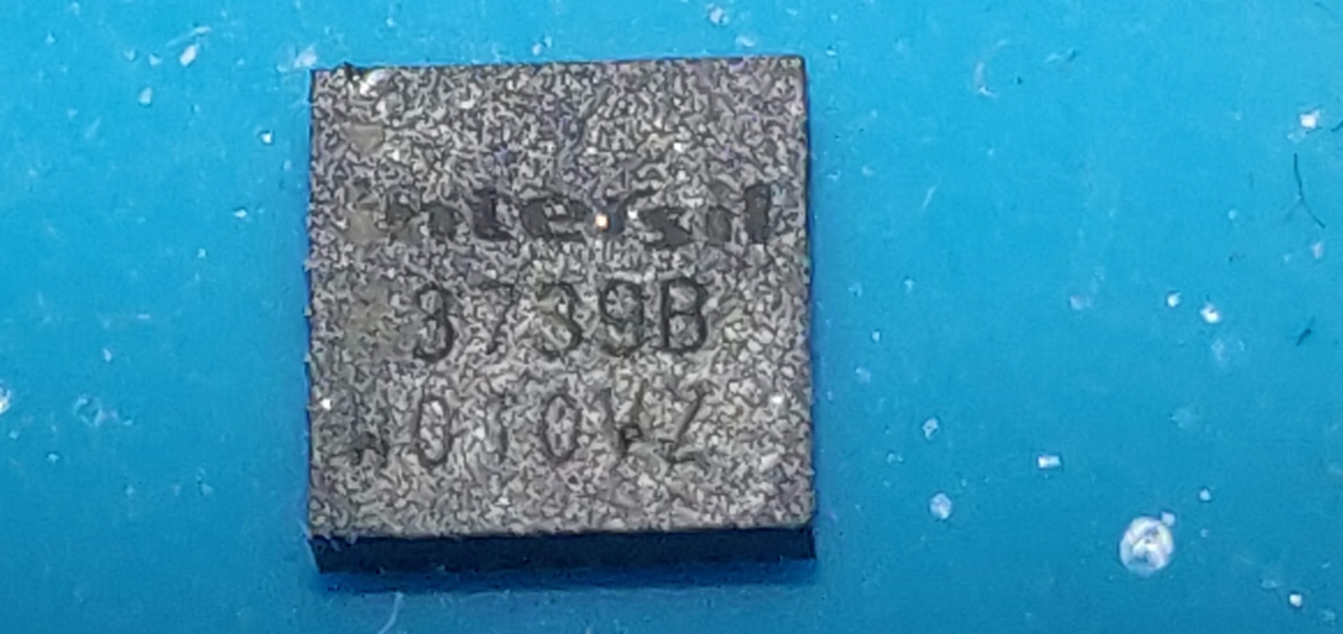

    Its from Hp
    Board number dag7admb8d0 rev d
    IC markings
    intersil
    83739b
    W0t0vz
    Thx in advance i just cannot find any isl that matches this.
    Cheers

    Re: Help Id part
    You are missing the leading '8' in the p/n - it got scrubbed on the top surface.
    The full p/n ISL88739BHRZ is available here:
    https://www.aliexpress.com/wholesale...t=ISL88739BHRZ
    Found it in a close schematic - post back if you need a portion of that schematic for your repair.
    Do confirm from the bottom side if this is a 32 pin QFN device - appears to be.
    Also, order the replacement with the SAME suffix = 'B' version to match your device.

      So i messed you second number? I thought it was 83739b ...
      I see the first 8 is messed up same as I in intersil
      but it looks like your right 88739b ...
      OMG - THX THX THX
      I'll check QFN toomorow at work.
      Schema would be cool i just cannot request it here.
      Pm if you can

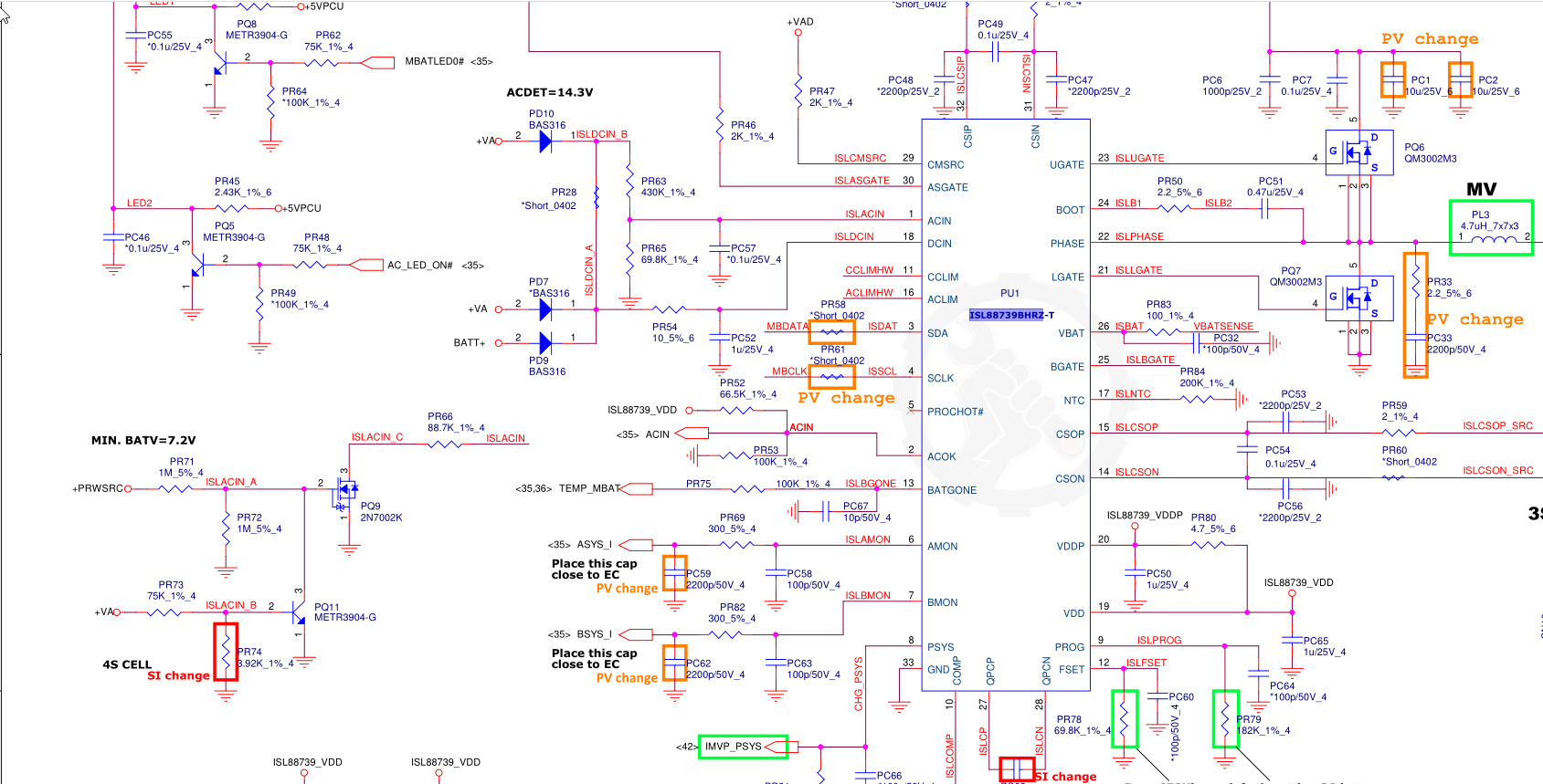

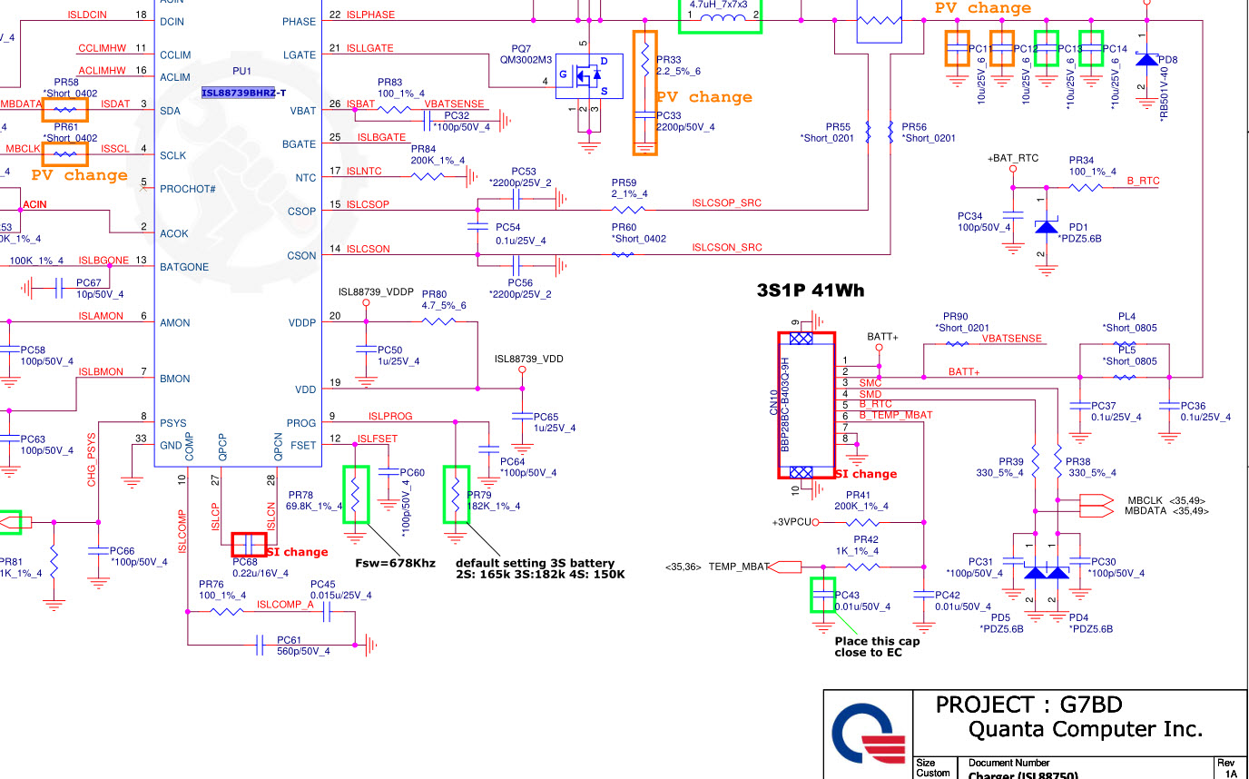

        See attached. This is from a different HP board but should be helpful for your case.

          Re: Help Id part
          Thank you again very much.

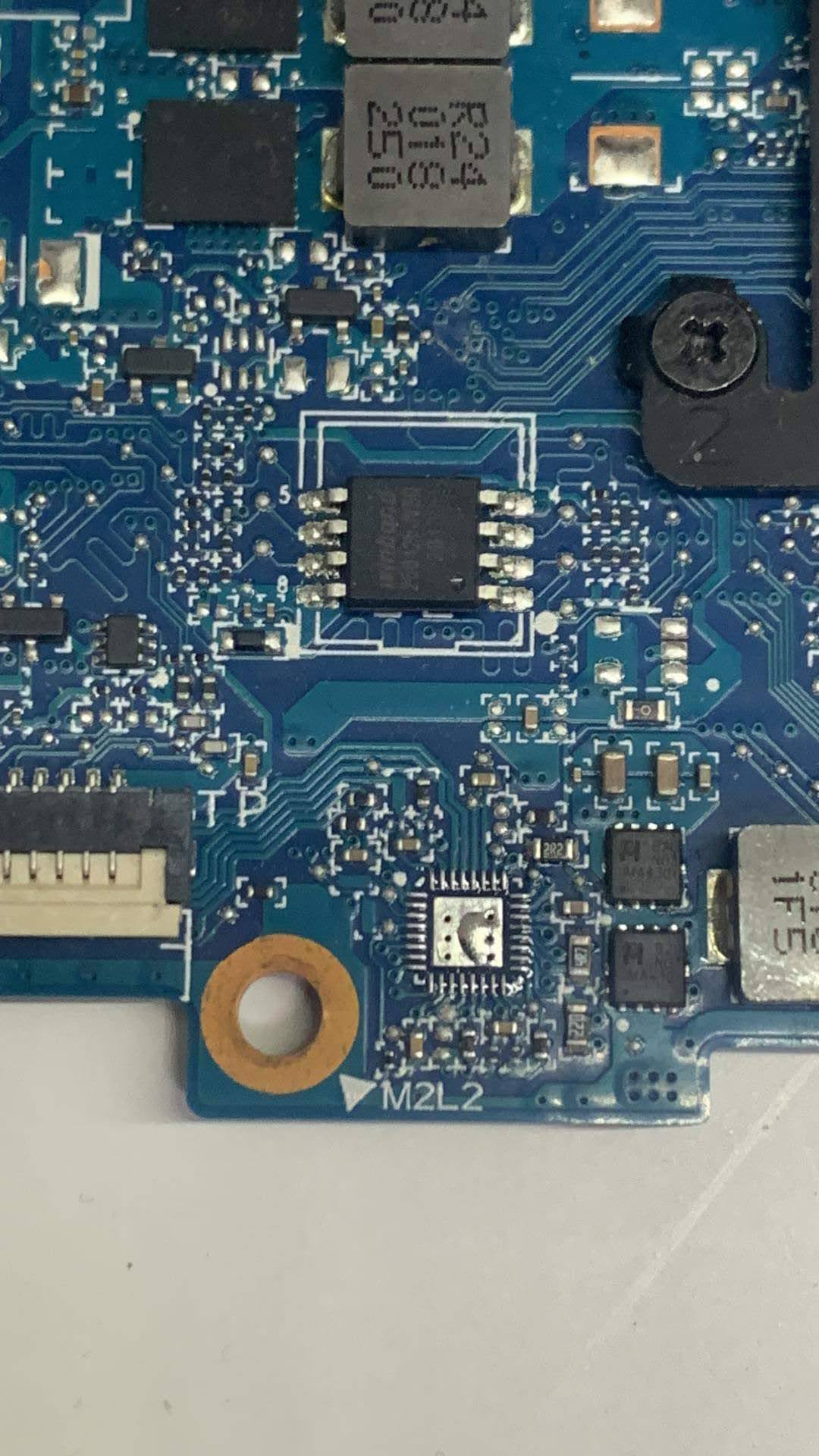

          Added a photo of a spot for it on mobo so now im 100% sure thats it

            Hi, What Schematics Is?
