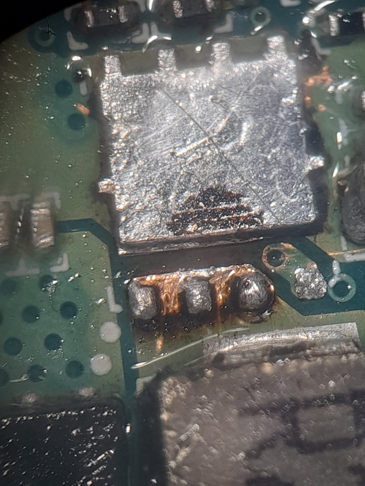

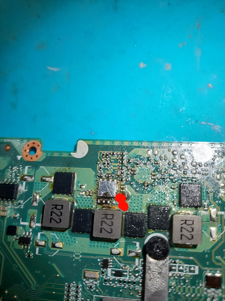

    I need help on this acer a315 DA0ZASMB8D0 REV.The problem with this one it came to me as no display, so i open the laptop and find out burnt mosfet near processor area AO6414A so i replaced the mosfet with new one now no lghts i removed the mosfet and check outside it became short, so I checked the pads , i noticed the gate is shorted to ground,anyone can help me on this please, i have attached schematic and pic on the location of the mosfet the mark read is the gate shorted

    anyone please help already done cleaning but still source and gate are still shorts beeping to ground

        @mcplslg123 thanks for the response I remove one side of coil R22 connected to gate and the gate is not beeping to the ground anymore,but source and gate are beeping, any help on this please

                the burnt mosfet removed measure the shorted gate 0.016k , s= 0.003k and drain ol

                    the mosfet above pic burnt is AO6414A connected to R22 COIL my meter is fluke 15b+ i set to manual to kohms

                          Look for the PU2 RT3662ACGQW controller and check which pin the AO6414A gate is connected to.Don`t apply any power to the board.

                            @smdflea thanks for the response the gate of the burnt mosfet removed A06414A Gate connected to RT3662ACGQW BEL0W
                            PIN4
                            PIN8
                            PIN10
                            PIN22
                            PIN24
                            PIN32
                            PIN36
                            PIN37
                            PIN38
                            ALL of them beeping on shorted gate of ao6414a

                                        UPDATE: remove RT3662ACGQW the short is gone on the gate of 6414A
