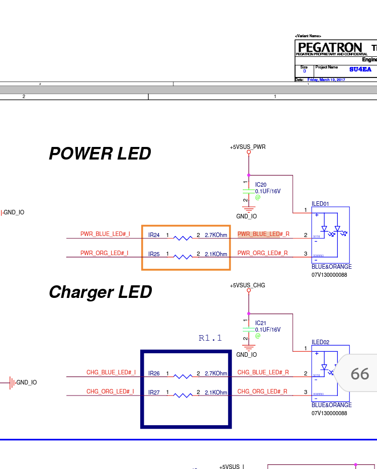

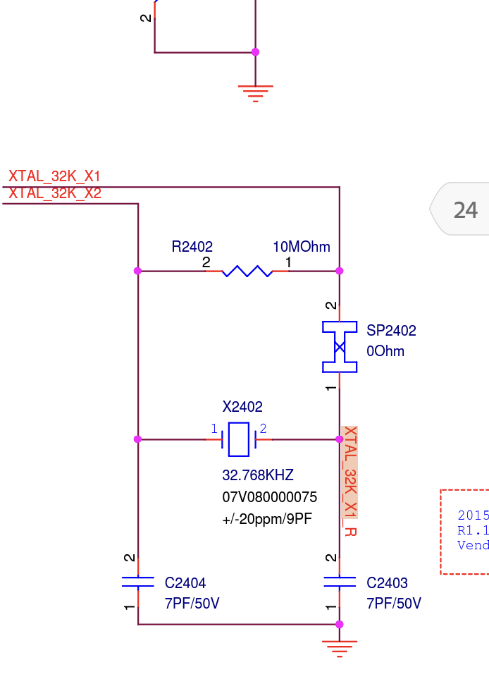

                                    Can you test the cristal X2402 32.766 khz is working or not ? is the power led working ?

                                      Re: ACER Swift 3 SF314-52-51KE dead
                                      For power led

                                        I don't have a scoop to test if the cristal is working, the power led does not work / does not give light when pressing the power button or placing the charger.
                                        On IR24 I do have 3.84v and IR25 i have 4.39v, and I also measure this on the led itself (blue / orange) (with the diode test on the multimeter, the blue and orange does give light).
                                        IC20 is not on the board, but from +5VSUS_PWR (at pin 1 from IC20) I do have 5.16v
