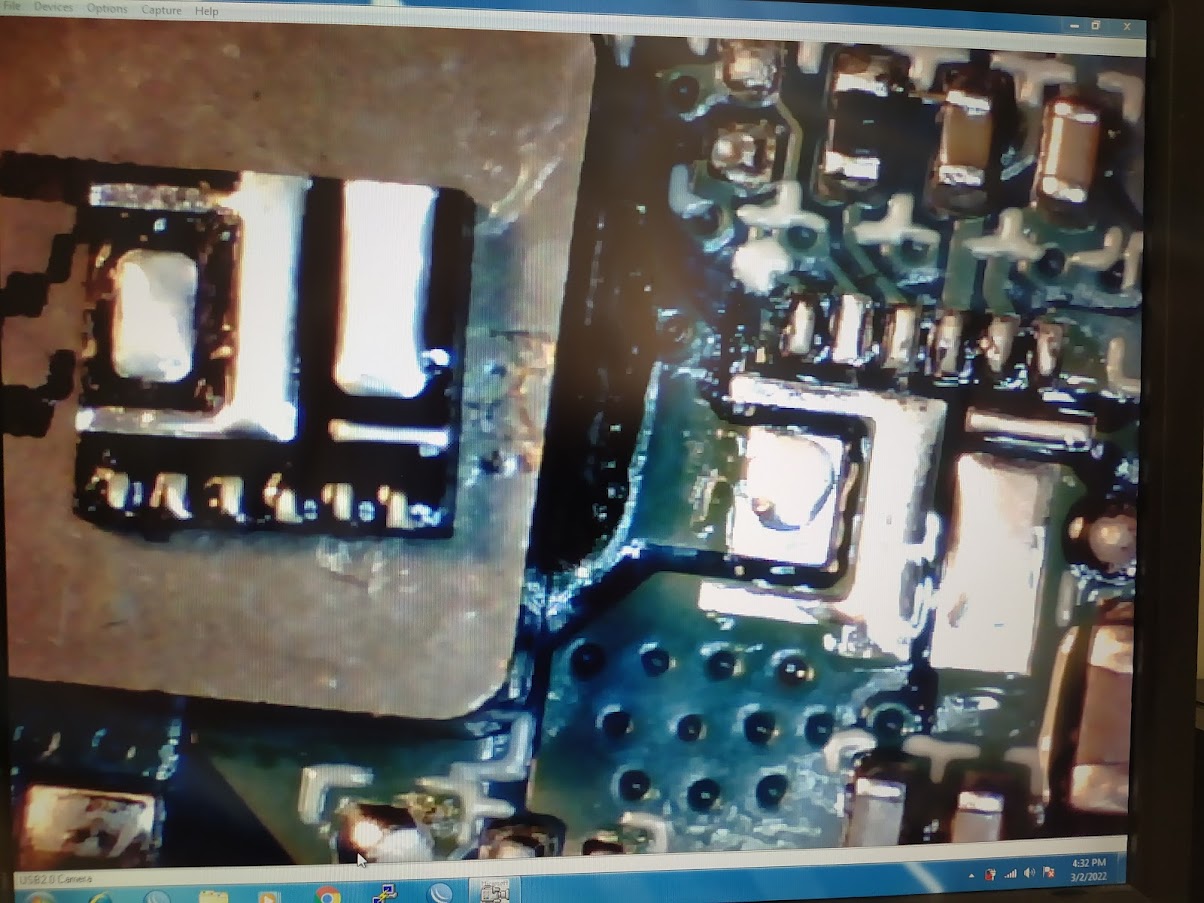

    i have this
    hp spectre x360 Convertible that not work and have burning ic. as i dont have schematic, i need help to identify this burning ic

    It could be a Silergy SY8208BQNC https://www.badcaps.net/forum/showpo...1&postcount=12
    MS*** SY8208BQNC - N/D (LA-9535P + Read post #6 https://www.badcaps.net/forum/showthread.php?t=75034)
    Desolder it and look at the pin layout.

      looks like it.
      here is the picture of pinout.
      Mostly burning 3.3V ic means dead PCH. i have 18kohm on 3VLP

        Just do a google search, ive seen it for sale at bulgarian and polish sites,it would be quicker than buying from aliexpress. Do you have ebay in your country

          waiting is ok for me from ali , but i fear burned PCH

            Inject 3V on +3V LP pin and check whether pch is getting hot or not. Why wait for the ic if pch is gone.Adapter/battery should'nt be connected while injecting on this pin. I doubt your KBC is likely damaged.
