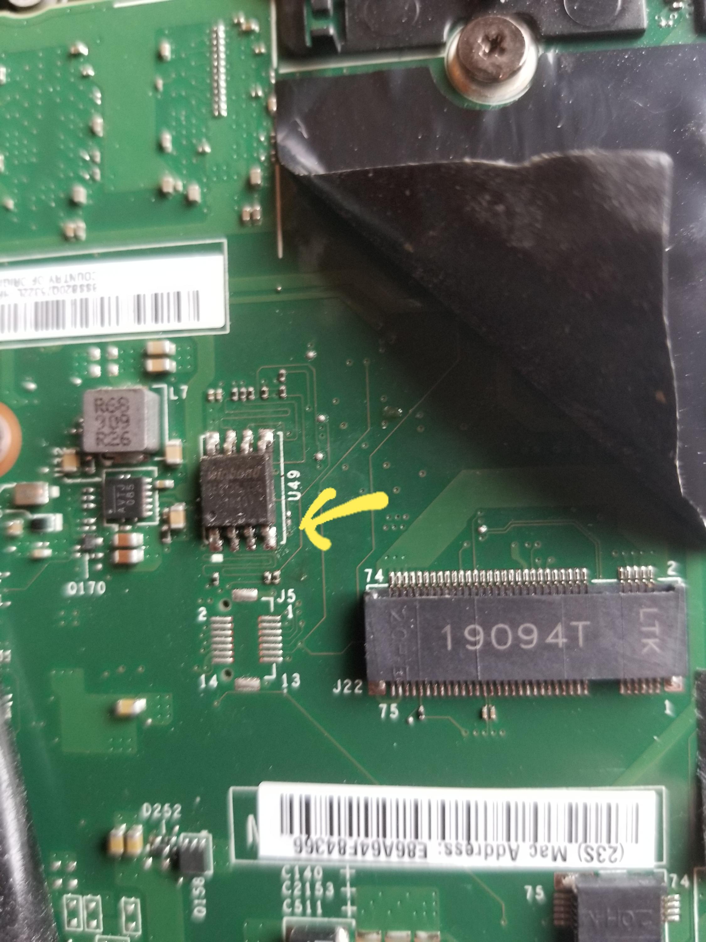

      Btw previously it was turning on but there was password.
      After desoldering BIOS IC, read the content 4 times. I am sure I have read the dump correctly. I have 4 separate backups with matching MD5 sum.
      After burning patched bios file, soldering back, that's when this happened.
      Reverting to original backup doesn't solve the issue

        Lenovo x280 missing component near bios ic
        Hi guys anybody know what component is missing marked by yellow arrow
        My guess is a resistor but I don't know the appropriate value. Probing the track tells me that it is connected to chips WP# pin
        Thank you

          Re: Lenovo x280 missing component near bios ic
          It was a 33 ohm resistor. Case closed
          Hope it will help others

            Re: Lenovo x280 no power plug in charger blink 3 times
            Issue solved. The BIOS IC was missing one resistor to one of its leg. Check this link https://www.badcaps.net/forum/showth...45#post1127845
            Case closed
