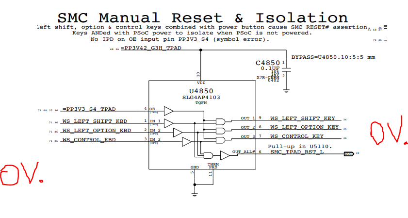

    Hello Dear
    Macbook 820-4924 not working Keyboard.. Trackpad ok
    test other flex, other trackpad, keyboard Same problem.
    reviewing I found that the IC U4850 does not have input and output signals (with Keyboard Connect)
    add File Picture IC SMC MANUAL
    thanks

    Re: 820-4924 Keyboard not Working,TrackPad ok !
    Update
    Are Flex Trackpad
    Test other y working
