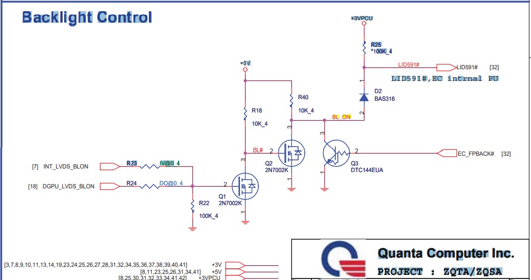

    hi guys....gud day ...i have an acer v3-471g
    DAZQSAMB6E0 REV E model ZQSA
    the problem is after 5 to 10 mins the backligt is off but i can see the display/graphics with a flashlight...
    i already try other lcd and it has same probmem......
    can anyone help me.....
    thanks in advance...

    Hi. Can you post the schematic? Or link it if it is on this forum.
    • mon2
      • Dec 2019
      • 14370
      Re: help acer v3-471g backlight problem....

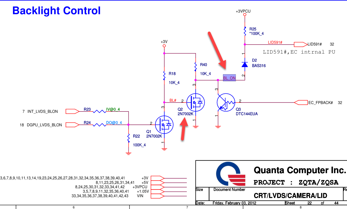

      I think I have the schematic for this logic board.
      Update - referenced the wrong schematic earlier from the database.

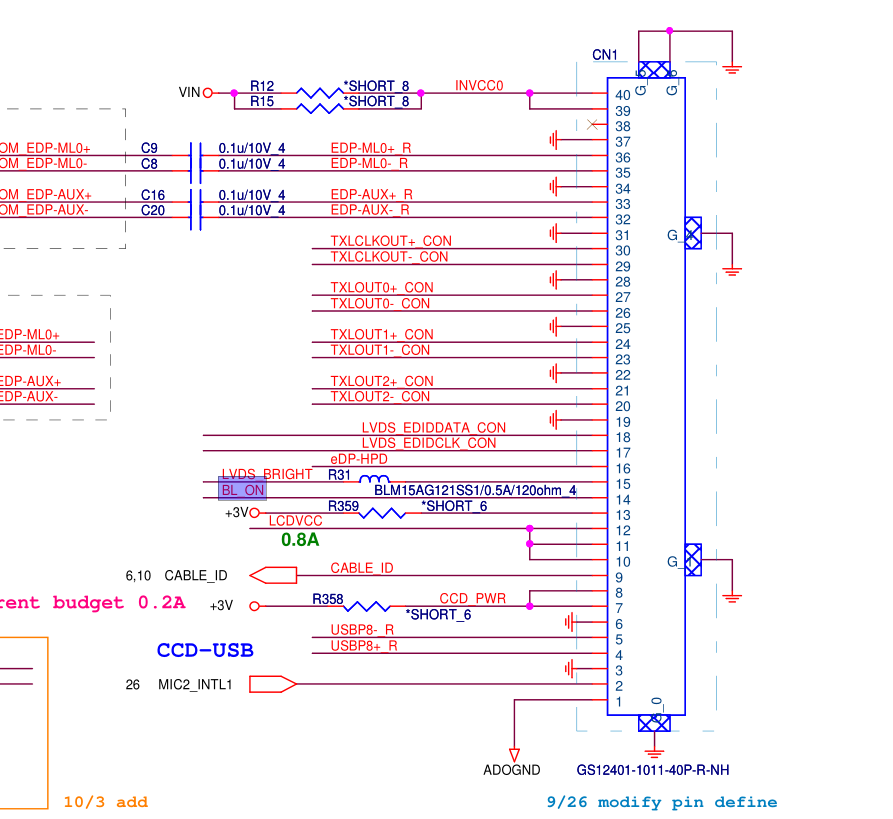

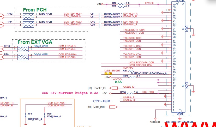

      measure the voltage on pin # 26 (BL_ON) of the CN1 connector:
      a) when the backlight is ON
      b) when the backlight is OFF

        this is the schem....
          i test the voltage on bl_0n whenthe backlight is on 3.2v and when it off after 5 mins.... 0.5v.....

                update i try to remove Q2 and test it now it has a backlyt ...d Q2 marking code is K72 F.....i have a scrap board and the transistor code is K72 X1 ist d same?

                  What is the voltage on pin #2 of Q1 mosfet ?
                  Voltage on pin #2 of Q3 ?
                  To check if a mosfet is damaged, remove all power.
                  Meter in resistance mode (2k scale).
                  Check the resistance between:
                  Source and drain
                  Source and gate
                  Gate and drain
                  Of each mosfet Q1 and Q2.
                  Q2 may be ok. If you remove Q2, backlight will work since the default pull up voltage of ~3v will appear on the BL_ON pin due to pull up resistor @ R40.
                  First need to confirm if any of the mosfet driver parts are being turned off for this signal line.
                  Post your voltage readings.

                    thank you so much for the help and advice..i replace Q2 and now its fine ....

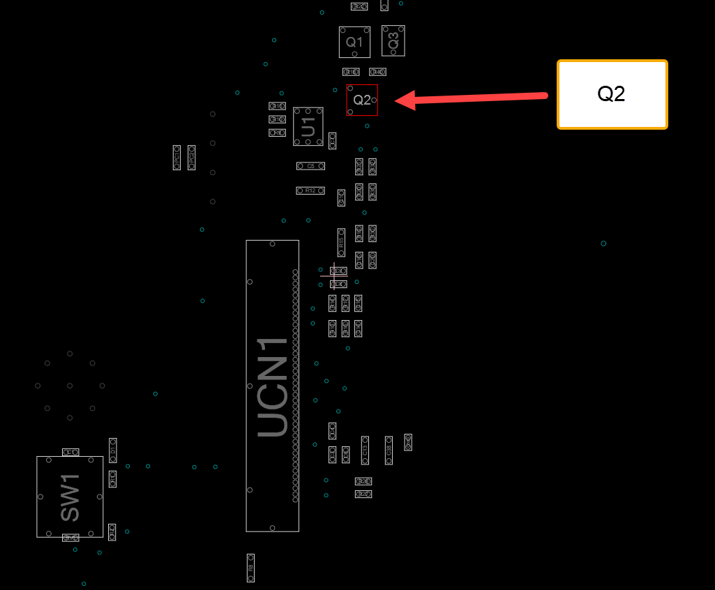

                      hi guys newbie here can u gave me a pic were Q2 located on board DAZQSAMB6E0 REV.E MODEL :ZQSA . I got a same problem like yours sir .
                      • mon2
                        • Dec 2019
                        • 14370

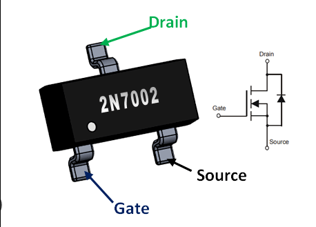

                        Hi. Personally have never seen the board and do not see a boardview file in my database.
                        Review the connector for the LCD display. This backlight circuit featuring Q2 should be nearby. The mosfet is very common and is a SOT23 package (3 legs) = 2N7002.
                        See attached as a reference for the component shape. Do not worry about the topside markings as your logic board may be fitted with a different version of the same part (many vendors build this part).
                        Post clear pics of the LCD connector and nearby parts for a review. About to enter my beauty sleep mode after a bit of Aliexpress shopping...

                          ZQSA Rev F boardview https://www.badcaps.net/forum/showthread.php?t=50906
                          • mon2
                            • Dec 2019
                            • 14370
                            Thanks @SMDFlea.
                            See attached.

                              Thnx.^^ guys i know where to look now.btw can i ask? i had old laptop that has q5 to q36 or bunch of it.can i used it to replaced dmg Q1 o Q2?

                                  On the laptop that is not working, measure the voltage to ground of each pin of Q2.
                                  Meter in dc volts, 50 volts or higher scale. Backlight is usually a higher voltage of 25-50 volts.
                                  Red meter probe to point to test.
                                  Black probe to ground.
                                  Post each measurement.
