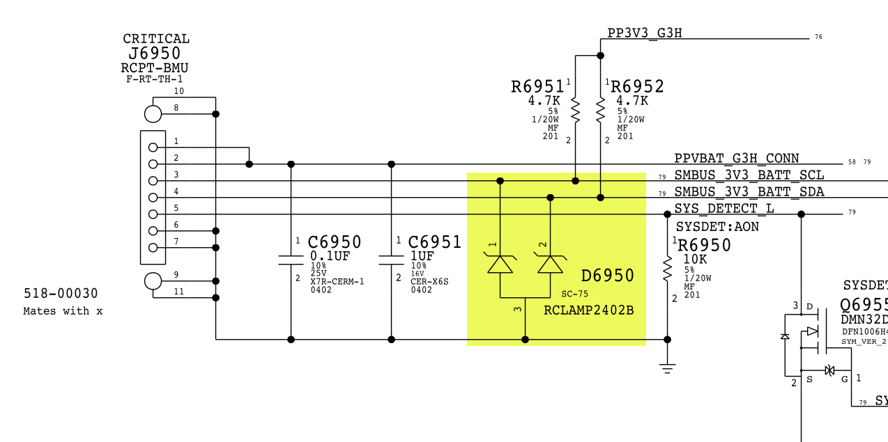

              Re: A1932 boot problem
              1) What is the history of the battery ? Is it a known good battery ?
              2) Is the logic board # 820-01521-a ?
              3) See attached.
              Remove all power - no battery / no adapter.
              Meter in resistance mode (start with the lowest scale).
              Check the resistance to GROUND -> pin # 3 to ground; pin # 4 to ground of the battery connector.
              We are checking for the status of the ESD diodes which are often used on the battery connector to protect the I2C / SMBUS communication lines. ESD transients often kill one or both of these diodes which will shunt the communication between the BMS module inside the battery back and the I2C / SMBUS bus master IC. Results in the battery not being detected.
              This is assuming the connector itself is not faulty.
                        1) nothing was attached.
                        2) measure and post the voltage values on D6950 with the battery connected. Also attach the power adapter.
