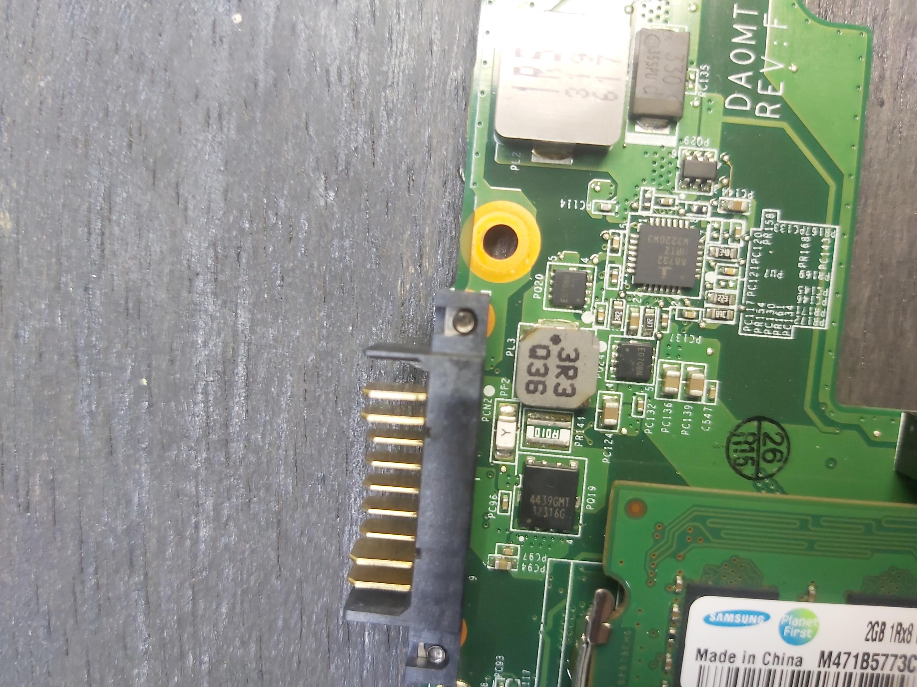

    Hi all my colleagues, today I want to ask you guys for help, maybe someone can take the time to help me with this toshiba C40-D mobo problem, the problem is, when using a new battery, it can't turn on even though I use a charger too and only lights the indicator flashes orange, I've swapped this new battery up to 3x but the result is still the same, and I can't find a schematic for this mobo, and this is the measurement for each pin on the ISL88732 charger ic when using a new battery (Without charger)
    PIN1(NC)= 0V
    PIN2(ACN)=0.23V
    PIN3(VREF)=0V
    PIN4(ICOMP)=0V
    PIN5(NC)=0V
    PIN6(VCOMP)=0V
    PIN7(NC)=0V
    PIN8(ICM)=0.10V
    PIN9(SDA)=3.29V
    PIN10(SCL)=3.29V
    PIN11(VDDSMB)=3.34V
    PIN12(GND)
    PIN13(ACOK)=0.01V
    PIN14(NC)=0V
    PIN15(VBF)=11.5V
    PIN16(NC)=0V
    PIN17(CSON)=11.5V
    PIN18(CSOP)=11.5V
    PIN19(PGND)
    PIN20(LGATE)=0V
    PIN21(VDDP)=0V
    PIN22(DCIN)=1.15V
    PIN23(PHASE)=11.5V
    PIN24(UGHATE)=11.5V
    PIN25(BOOT)=11.12V
    PIN26(VCC)=0V
    PIN27(CSSN)=11.01
    PIN28(CSSP)=11.01V
    below I attach the schematic of the toshiba C40-A which uses the same charger ic

    Does the laptop work to power on with the power adapter (remove the battery to test) ?

        Need to check the BATTERY mosfet.
        Locate the mosfet and then remove all power (no battery).
        Use meter in resistance mode (2k scale is ok).
        Check & post the resistance between:
        source (1-2-3) & drain (5-6-7-8)
        source (1-2-3) & gate (4)
        gate (4) & drain (5-6-7-8)
        Suspecting that you have a defective battery mosfet but it is only from the past reviews of similar cases.
        Once you find the battery mosfet, post a pic or at least the full markings on the component. Assuming that this will be a common 8 pin N-channel mosfet with 8 pins as per above labels.

          thanks for your help, this is for battery fet measurement with 2k mode
          s-d = 467 ohms
          s-g = not showing
          d-g = not showing
          I think there is no problem with this battery fet.
          I forgot to tell you, that this laptop can work when using the old battery but can't charge and must use an adapter
          • mon2
            • Dec 2019
            • 14666
            Re: TOSHIBA C40-D Cant use new battery
            s-d = 467 ohms
            is a low reading.
            reference - see the RESISTANCE chart for source-drain
            http://electronicsbeliever.com/how-t...-is-defective/
            Can be caused by this battery mosfet being defective.
            What are the markings on this mosfet ?
              Originally posted by mon2
              is a low reading.
              Reference - see the resistance chart for source-drain
              can be caused by this battery mosfet being defective.
              pq19 = 4439gmt
              • Yosua
                • Jun 2021
                • 221
                • Indonesia
                is a low reading.
                and this is the voltage measurement on pq19
                using a new battery (without adapter)
                pins 1,2,3= 11.12v
                pin 4= 2.64v
                pins 5,6,7,8=11.12v
                using new battery and plugged adapter
                pins 1,2,3= 19.12v
                pin 4= 18.81v
                pins 5,6,7,8=11.12v

                  Datasheet for the mosfet is attached.
                  It is a p-channel enhancement mosfet. So to turn this mosfet ON, the GATE must be more negative than the voltage on SOURCE / DRAIN.
                  reference:
                  http://www.learningaboutelectronics....hannel-MOSFETs
                  The gate voltage looks good to turn it ON.
                  Concern is if this mosfet is ALWAYS on due to damage since the resistance between source & drain is quite low for the mosfet.
                  I would consider to at least remove this mosfet -> measure the mosfet leads again when it is out of circuit but recommend to replace with a known good mosfet.
                  The laptop will have I2C (SMBUS) interface pins (SDA & SCL).
                  Without power & no battery, what are the resistance readings for these lines to ground ? Need to be sure that the battery gauge is working.
                  When you are using the laptop with the adapter AND the battery is connected, what does Windows report on the status of the mated battery ? Can Windows even find the battery ? What is the % charge reported by Windows ?
                    for the resistance of the SDA and SCL pins on the 632 ohm battery connector for these two pins.
                    and when using an old battery it can light up but can't charge but the battery can be detected

                      pq19 measurement when disconnected from mobo
                      s-d=497 ohms
                      s-g= not showing
                      d-g= not showing

                          Replace this mosfet and test again.

                            thank you sir for your advice, but i have replaced it and the result is still the same, does this have nothing to do with TEMP_BATT or pin ID on the battery connector?
                            • mon2
                              • Dec 2019
                              • 14666
                              What are the resistance readings for the replacement mosfets?
                              Which replacement mosfet was used for this repair?
                              Next, with the power on, what are the voltage readings for the I2C (smbus) lines. These should be ~3v3 for each.
                              With only the battery, what are voltage readings on the mosfet?
                              Post the above values.
