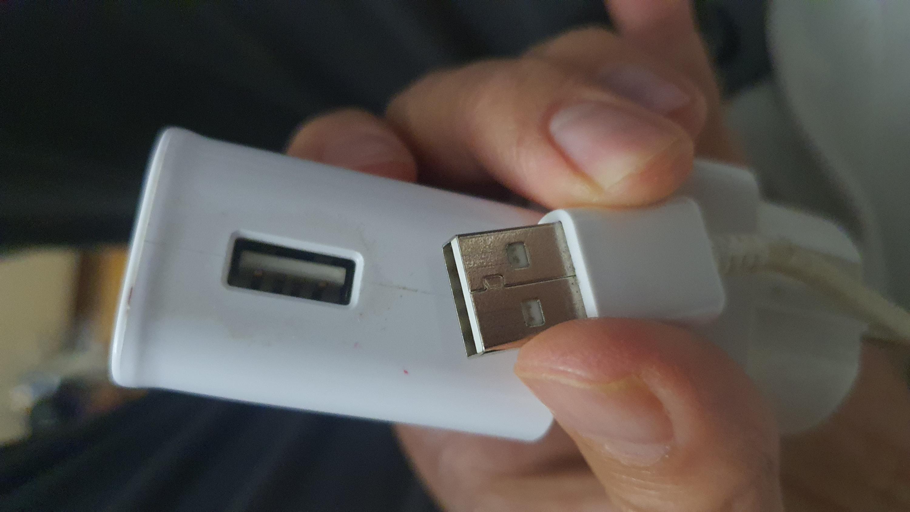

      Pics

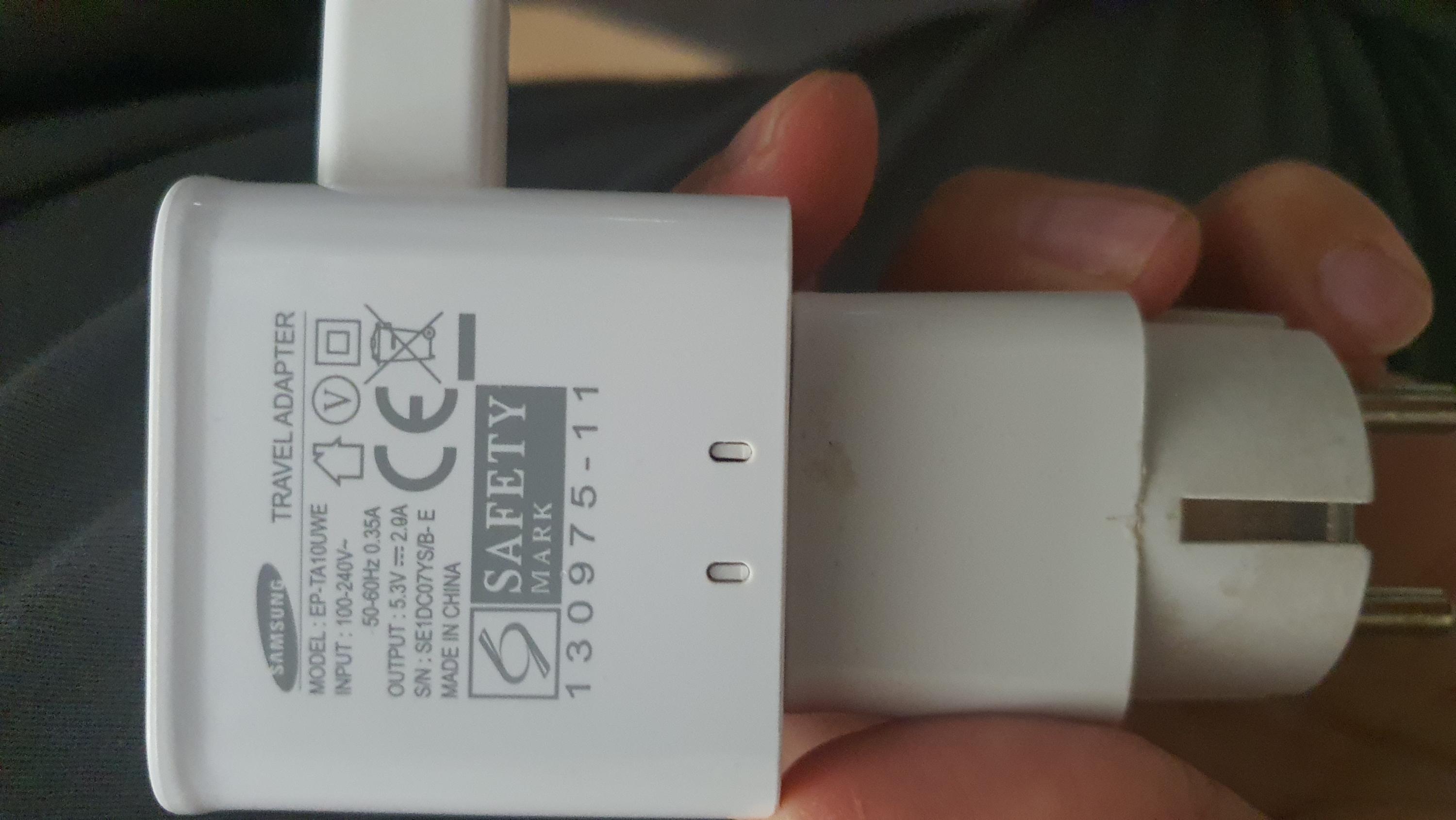

        Here is the charger I got with my Galaxy Note 2014 Edition (pics above).
        Can I use the same charger for SM P-900 but only interchange to micro-B USB 3.0 cable to use with the charger?
        Besides this charger is 2.9Amps not 2A required by P900.

          Re: SM P-900,what charger to use?
          Yes, you can use a higher current charger on a lower current load (your tablet). This just means you are able to supply higher current to the load but the load will only consume 2A.
          Be sure the connectors are the same for your tablet which appears to be a USB 3.0 - ironically repairing a logic board with the SAME connector right now - it is loose on the PCB.

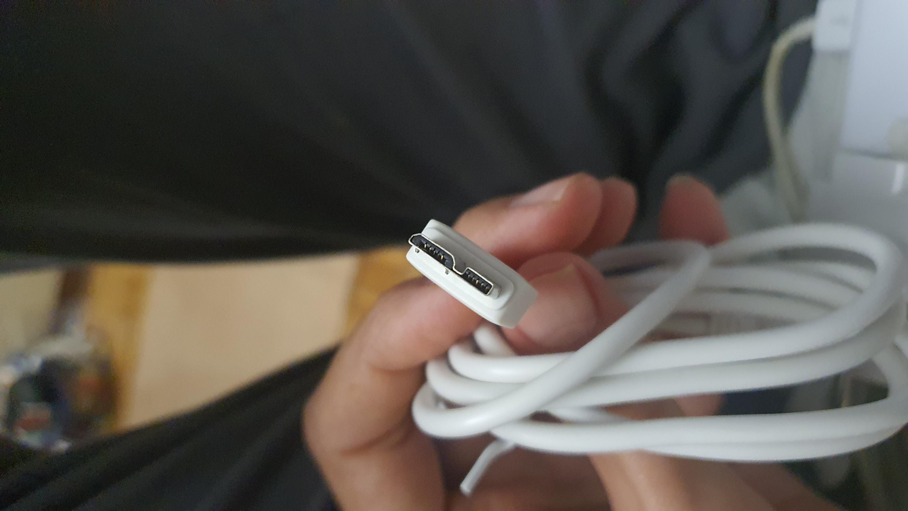

            Oh okay so regarding current I'm good to go,what about interchangeble cables.
            The one which came with charger is micro usb 2.0 and I'd need for P900 cable from picture which on the one side is usb 3.0 and other USB Micro-B type.
            Can I plug that cable without issues to to the charger and charge P900?
              I hope we don't missunderstanding each other.
              So for P900 I would need to use usb 3.0 cable,non genuine one (middle picture) and plug in the charger which was used for Galaxy Note 2014 edition (micro usb connector on one end,on other USB 2.0 not 3.0).

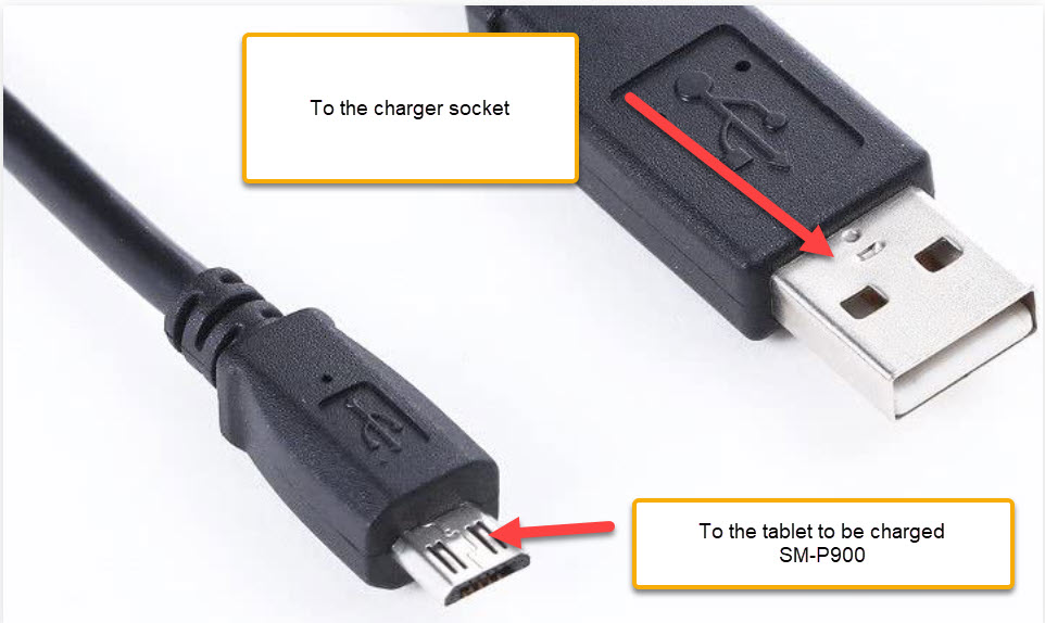

                See attached.
                1) You will need a new cable.
                Search for 'USB 2.0 A to micro B cable. Do note that the micro B connector is a keyed connector - it will only go in one way so be careful during this use.
                Amazon and your local cell phone shop will carry these.
                2) Attached is a screen pic of a cable that is used for your unit. Compare it against the connector on your tablet.
                3) This cable will work fine with the charger you already have to charge the tablet.
                    Yes, you can use the USB 3.0 Micro B cable on the USB 2.0 charger adapter.
                    From my internet search, your tablet is with a USB 2.0 micro B but you will know better since it is in your possession. If the USB 3.0 Micro B connector fits, you can use it.

                      Yep,but on the other end (which plugs to the charger) it's USB 3.0 not USB 2.0 (genuine adapter which came with Note 2014 edition).
                      But that doesn't matter,right?
                      • mon2
                        • Dec 2019
                        • 13969
                        Correct. Does not matter. You are not using this cable for data transfer and the adapter does not have such pins for the higher speed data transfer.
                        Only the Vbus & ground pins are being used for the USB 2.0 & USB 3.0 connector pins and this charger.
