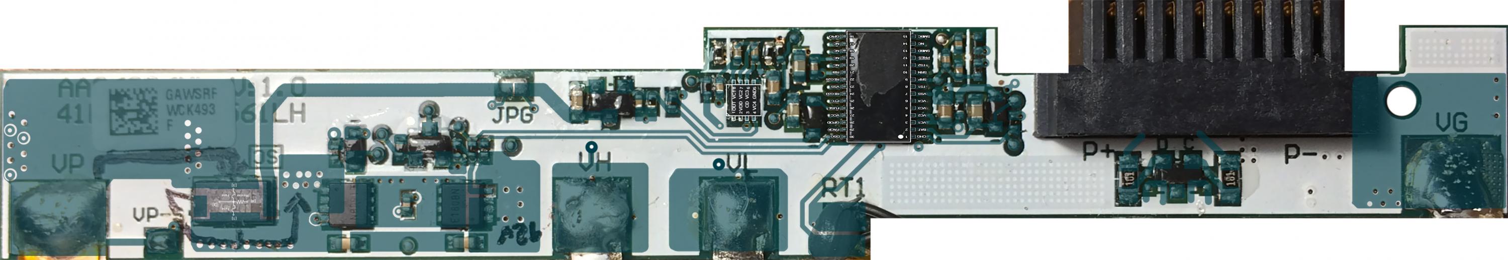

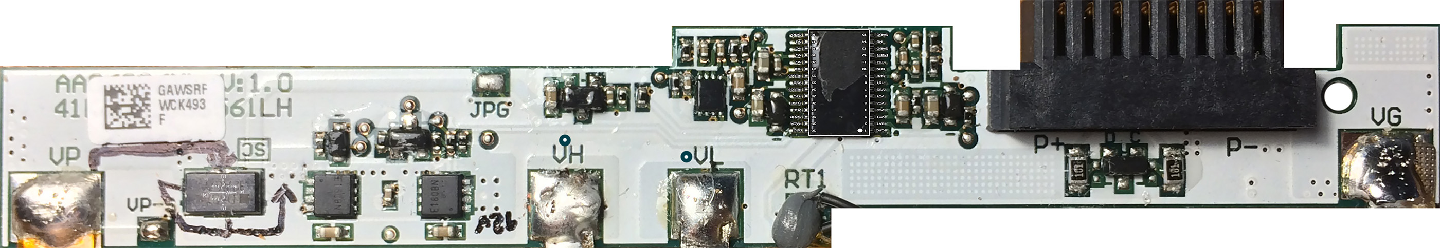

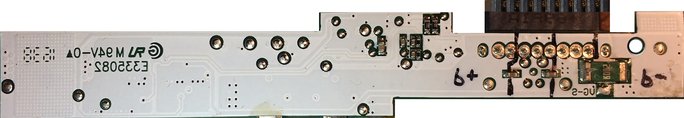

    AA06XL is based on BQ30Z55 controller with RQ3E180BN mosfet and D6SA sefuse
    Pre-Story: Battery was deep discharged (month attached to zbook with lowest charge) So cell voltage was 3.2V.
    ICP596080C (Capacity: 7860(x2 3930) mah, Nominal: 8420 (x2 4210) mah) cells was disassembled and charged with 500 (the best for discharged cells) mah chargers and placed back.
    But after fully charged, there is 0 voltage on connector. Mosfets are closed and fuse is closed. Fuse bypass didn't solved mosfets opening.
    What could be wrong, except fuse?

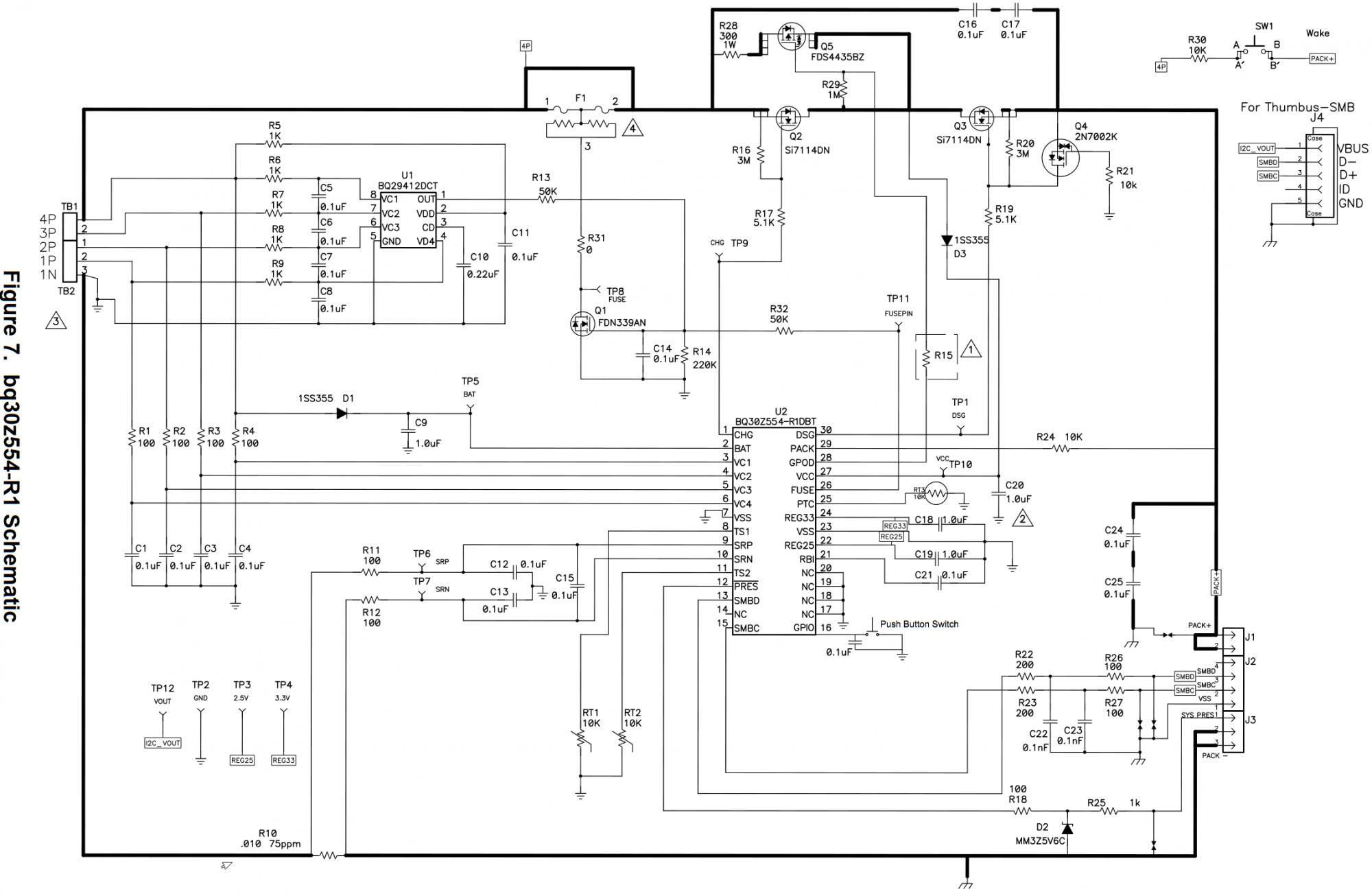

    BQ30Z55 reference schematic

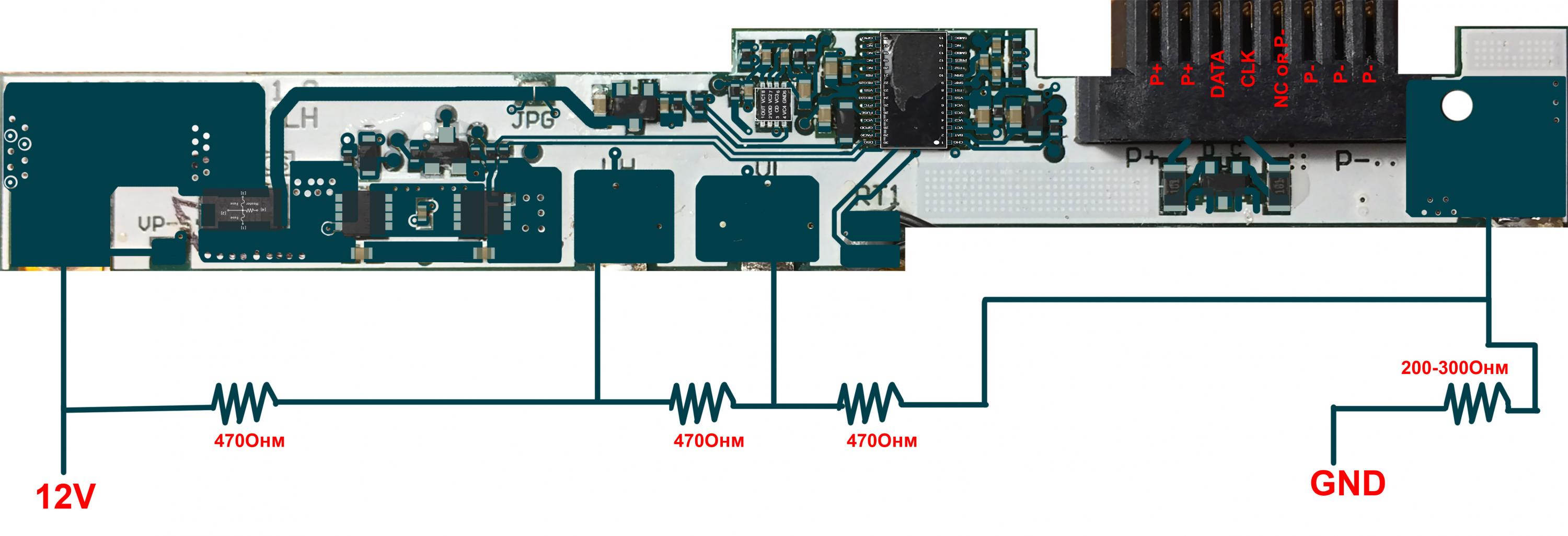

          After deeper research, results:
          Mosfet which is responsible for output partially opening when battery is connected to laptop.
          Initialization sequence I have:
          When ac connected, 3.3v on smbus arriving for few seconds. The heater in fuse receives 12 volts to burn it again. So controller is stuck at status to disconnect battery source. Maybe controller requires flashing or replacement

            The BMS circuit will be a design that only the vendor will know about. Doubt it that the firmware will be available to the public. For safety reasons, the entire battery pack should be replaced and sourced from a supplier that will take it back if the pack is garbage. Suggest to work with Amazon so that you will have some teeth to be able to return it just in case the pack does not hold up. Repairing battery packs is a serious fire hazard.
            • EdwardGeo
              • Mar 2020
              • 109
              • Ukraine
              Re: NEED HELP! Battery issue - AA06XL - HP ZBOOK 17 G4

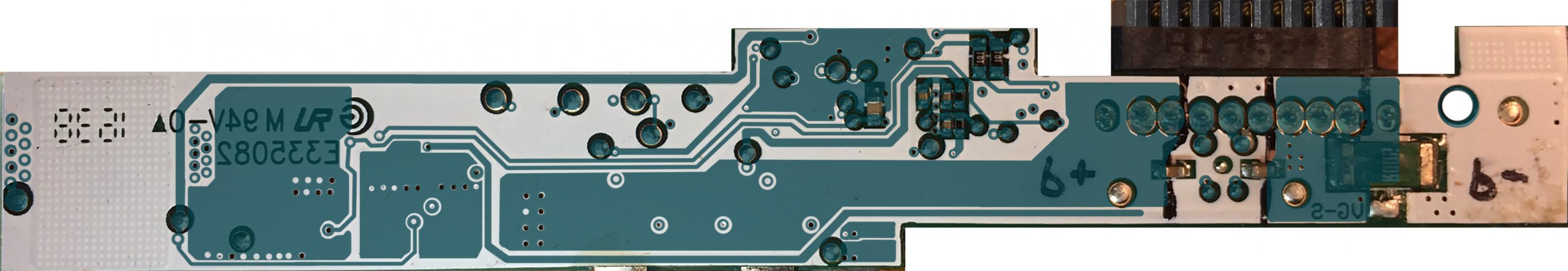

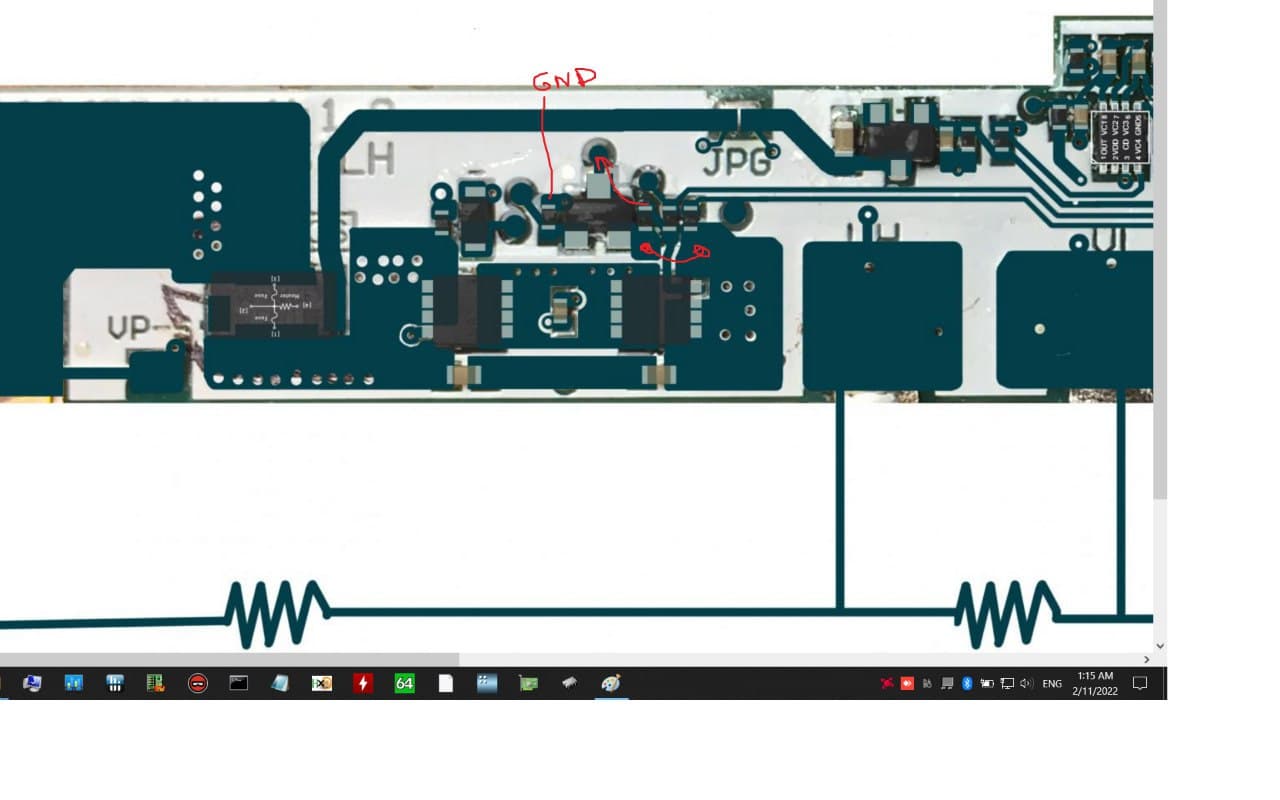

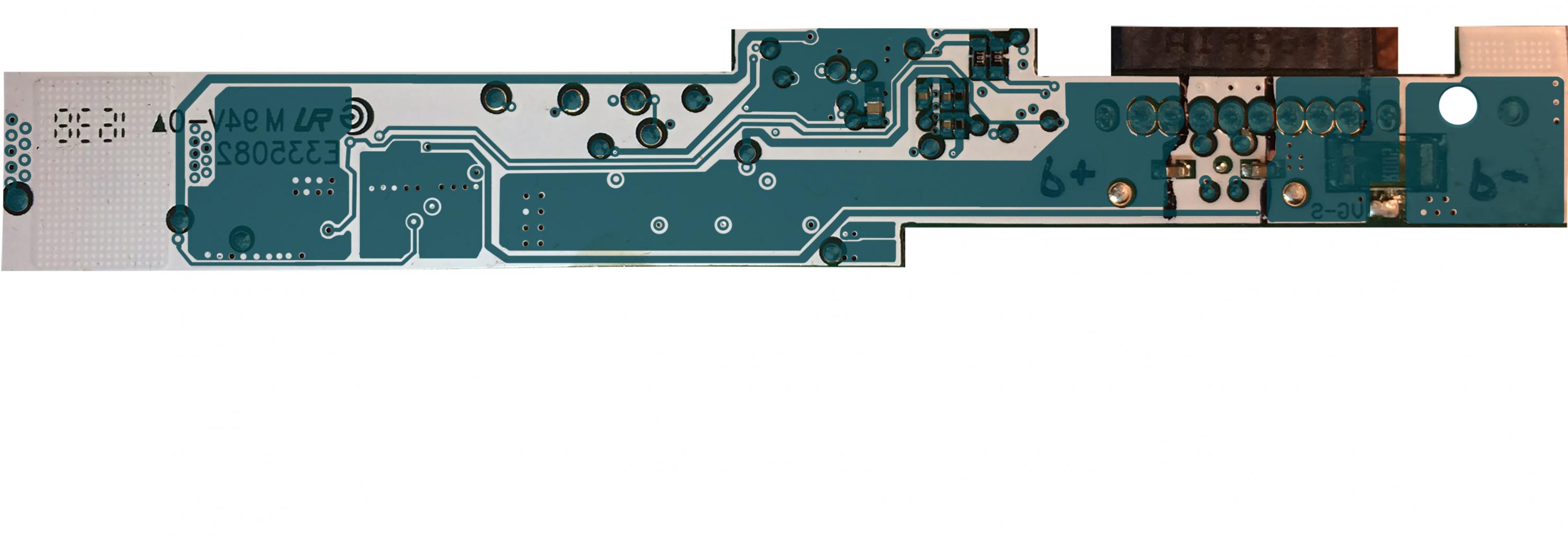

              The battery has only 6 charge cycles. So that's almost new. Ordered USB-to-SMBus CP2112, will try to restore Sealed status
              Not sure if that board mapping is good enough, as i have not tested all traces, but sharing as JPG.
              Later will report results

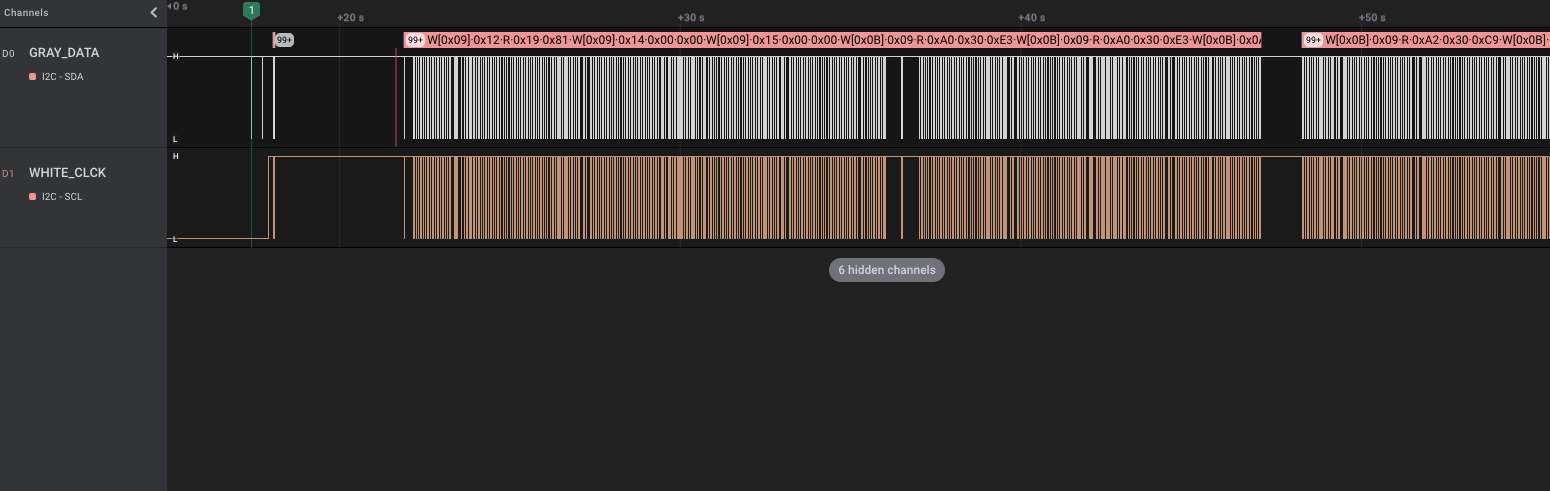

                SMBUS protocol logic analysis
                With Sealogic

                  also have found some new connections onboard. Also at last gate should be 21V to activate a battery. Fuses will arrive tommorow
