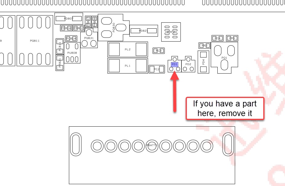

                  Re: Dell E7440 no signs of life
                  Code:
                  SCL resistance to GND 180 Ohm
                  This line is being pulled down and causing problems.

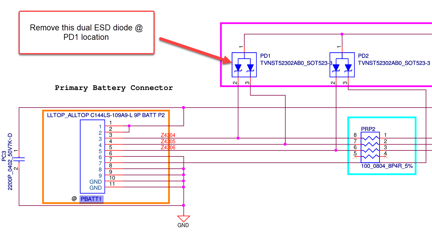

                  Locate the ESD tvs diodes that are often on these lines near the battery. When found, remove this part.
                  Then check the resistance again. If no longer a low reading, power up and test again.
                  Post the voltage on the SCL line without the tvs ESD dual diode on this line.

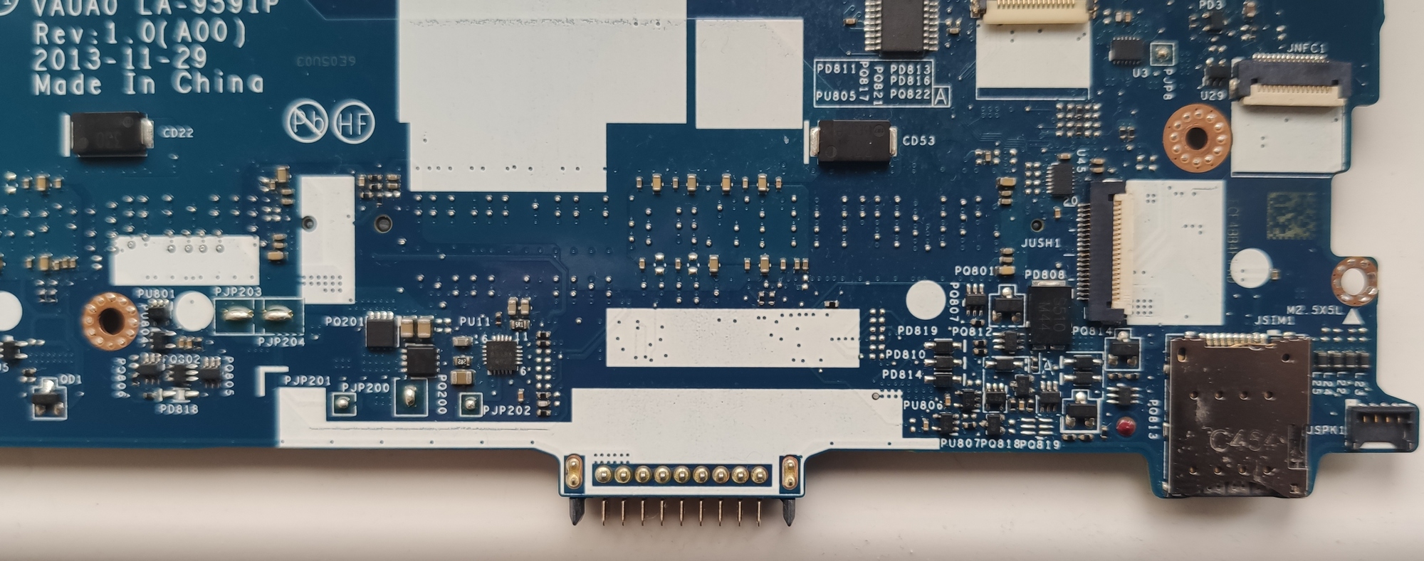

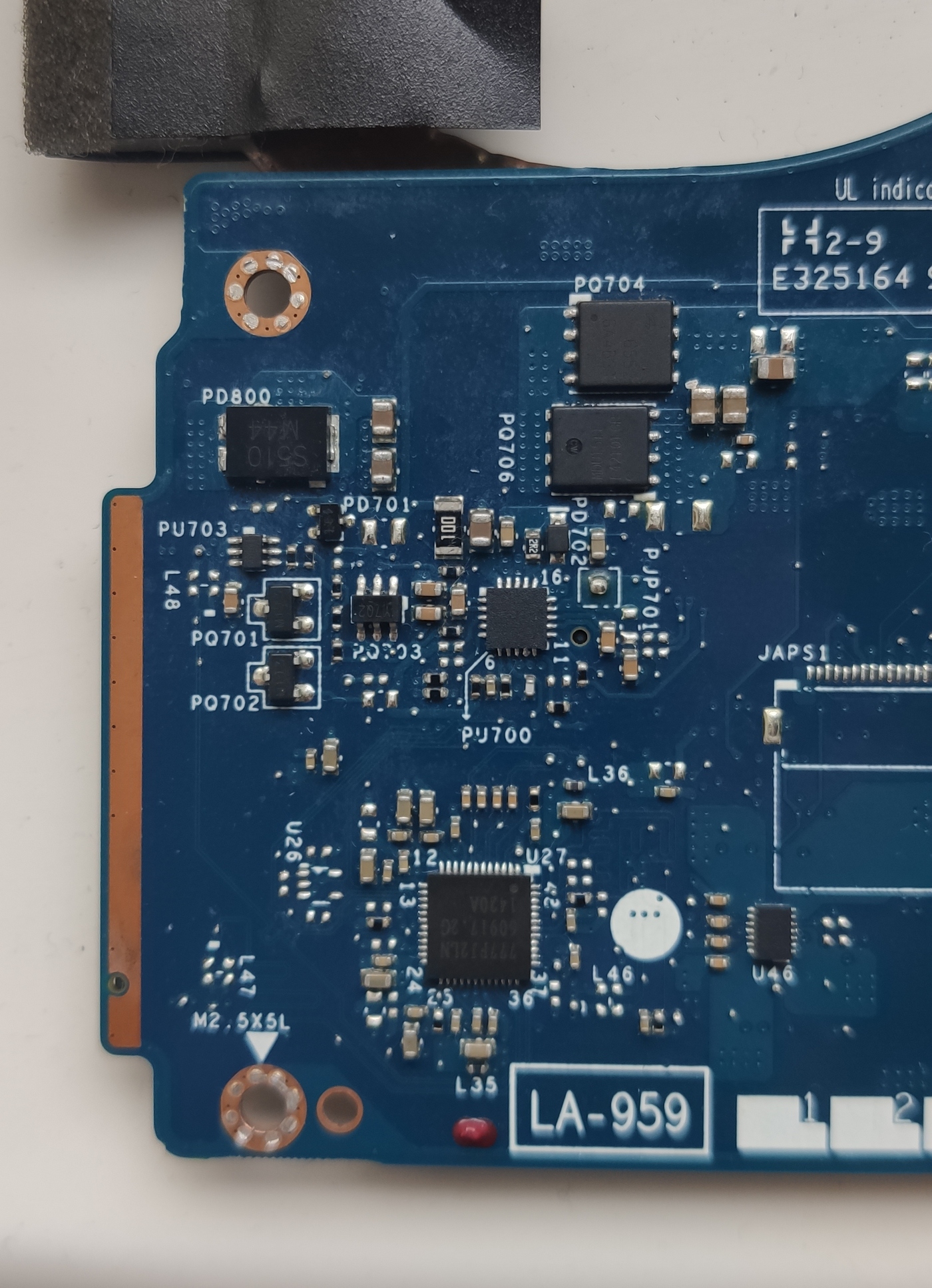

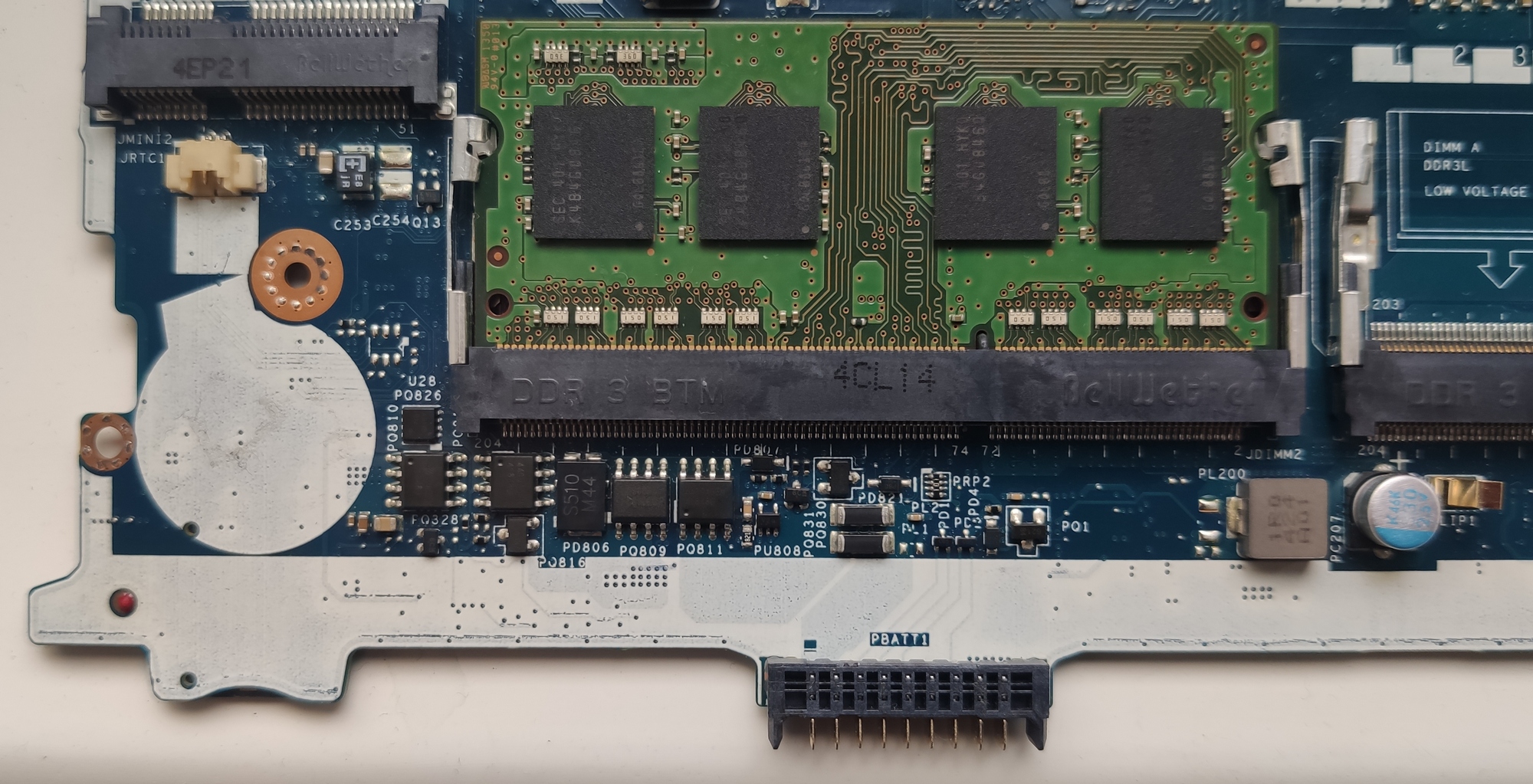

                    I'm not really sure where to look at. There is a diode "S510 M44" near PU700, or maybe something else?
                    Here are some pictures of the board from both sides.

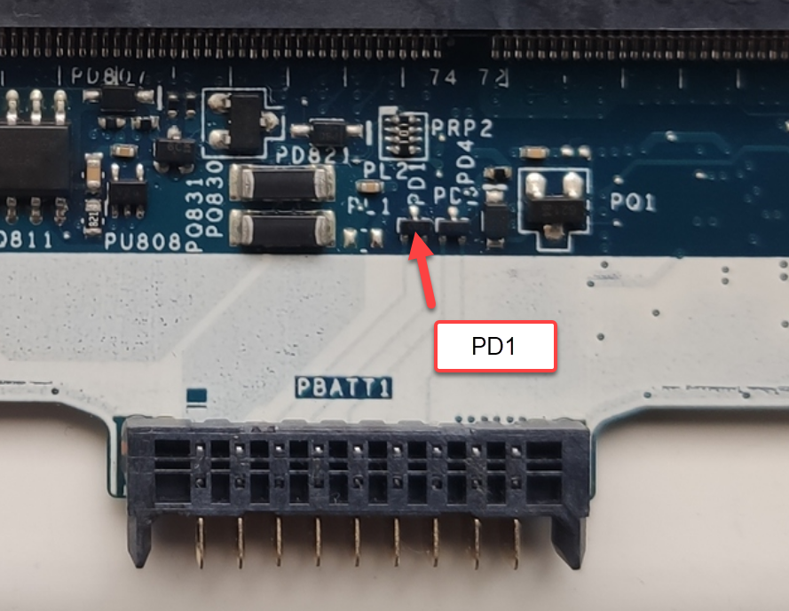

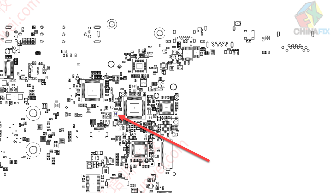

                      Look for a 3 pin part with label PD1. If not silk screened on the logic board, show some pics near the battery connector. It should be close by.
                      See attached.
                      Update - I think I found the location - see the area of the battery.
                        @mon2 I forgot to say, Thank you for all the effort
                        I found PD1 and removed it, but unfortunately no change, measurements are the same.

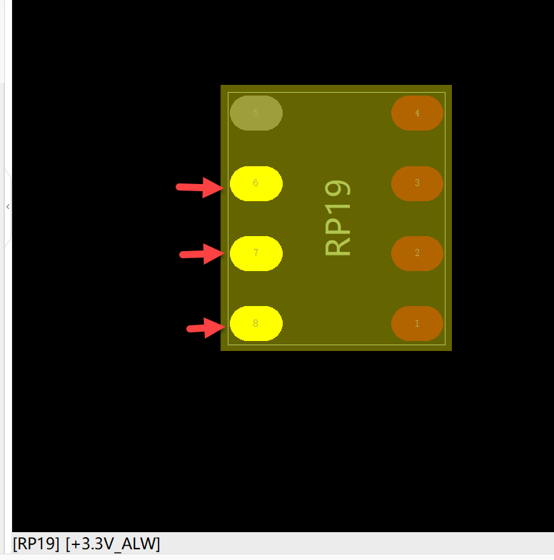

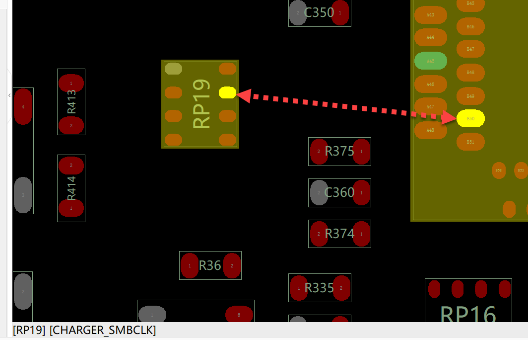

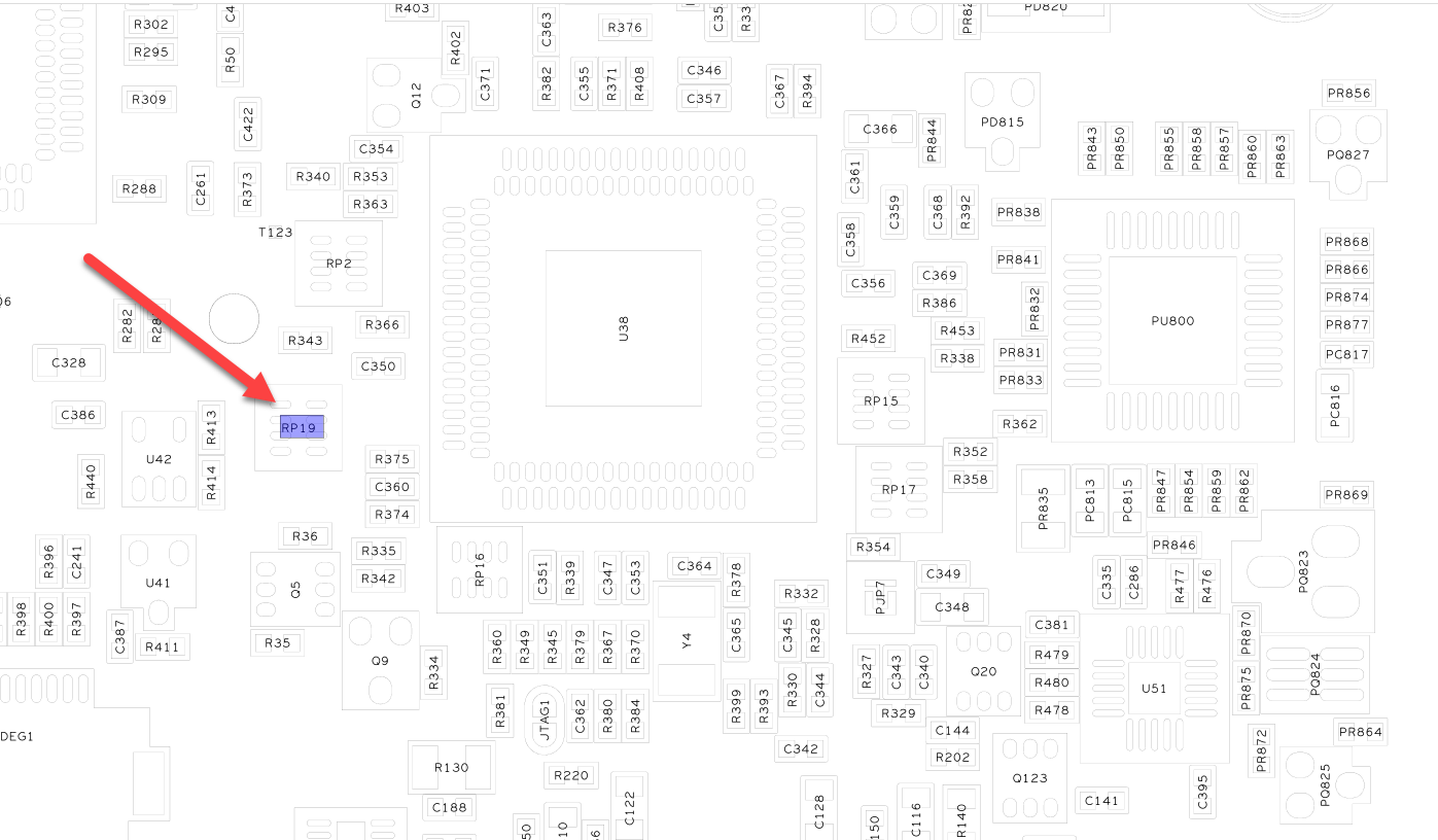

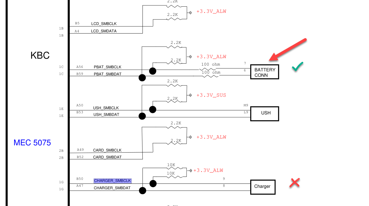

                          My bad...this logic board has multiple I2C (SMBUS) masters.
                          The charger bus master, CLK pin is at fault.
                          This could be:
                          1) due to a faulty KBC port pin that is responsible to drive the SCLK signal
                          or
                          2) the required pull-up resistor for the SCL line is missing (RP19) or corroded(?)

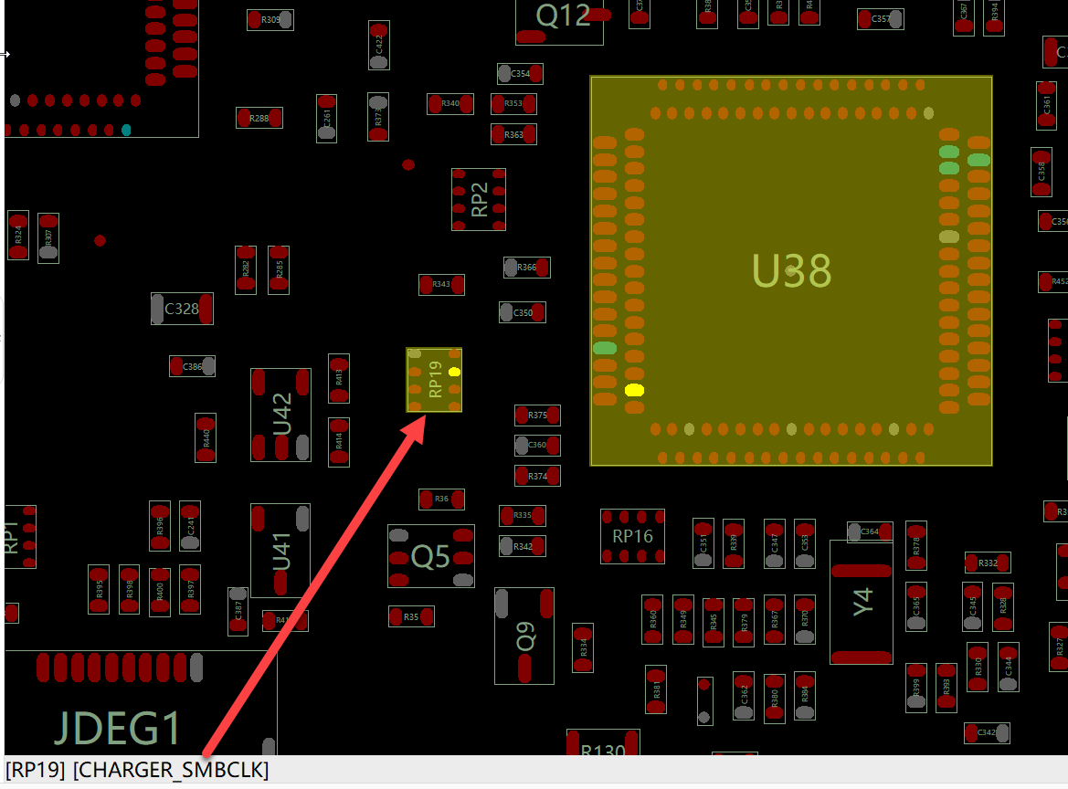

                          See attached. Inspect the resistor network @ RP19 which will be a 8 legged part (4 on each side). Does it look clean to you ?
                          If in doubt, apply flux and allow this part to 'dance' with the hot air so that the solder joints settle once again. Be careful to use low air pressure so that the part or neighbors do not go flying in the process.

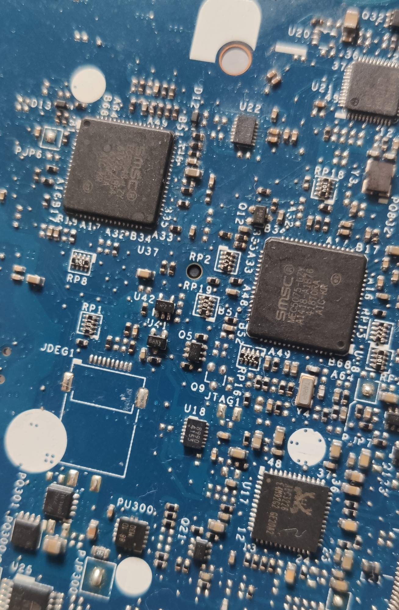

                            I think RP19 looks normal. I measured resistance between leg pairs and all are 10 kOhm, except third pair with 490 Ohm, not sure if that's relevant.
                            This is the part of the board where I found signs of flux (on two big chips), but it's cleaned now.
                            I don't have hot air station
                            • mon2
                              I think a hot air tool is mandatory for such repairs. The large chip may have corrosion underneath that is not visible. For such cases, apply flux on top and around the pins of this part and hot air away till the part starts to swim into the solder. Use tweezers to gently nudge it - make it 'dance' so that the joints settle again.
                              If that does not work then likely this large IC is defective - not sure if it is a programmable device. If it is, then the part needs to be programmed with the proper firmware. Check on the internet or wait on some feedback from others on this KBC.

                                I know it's basically mandatory, but I still don't have it or the skills to do such precision work (for now). My idea was to try, maybe if it was something simple, and also to learn some basics.
                                I measured yellow pin you marked on the RP19 and it has the same voltage as SCL 180 mV. Other pins have 3.3V. I suppose it comes from the chip, so it's probably defective or something.
                                  Confirm that the LEFT side of the RP19 pads are each @ +3v3.
                                  See attached.
                                  If yes, then it is all down to the large IC and its soldering.
                                  You can try to measure the DIODE MODE readings as follows:
                                  Meter in DIODE mode setting.
                                  Red meter (yes RED) probe to GROUND (shield is ok).
                                  Black meter probe to the SCL line on the RP19 that is showing the low voltage.
                                  What is the reading ?
                                  Then repeat for the SDA line on the RP19.
                                  As noted, you have a low resistance to ground on the SCL line and this is preventing the I2C (SMBUS) master (the large IC) from communicating with the other devices using this 2-wire communication interface.
                                  RP19 plays an important role and it must be pulled up to the ~3v3 value but we cannot see what is under the large IC so a reflow is recommended. If that fails to work, then the large IC must be replaced. At this time, I am not sure if this large IC is a programmable device or not. Sometimes such parts feature a small microcontroller (like 8051) inside the device and then will fetch firmware upon power up from a flash device. The flash device may be external to the KBC controller or could be internal - again, if at all programmable.
                                    Yes, all yellow marked pins are 3.3V
                                    Diode mode on SCL 0.13V (same on the RP19 pin)
                                    Diode mode on SDA 0.5V
