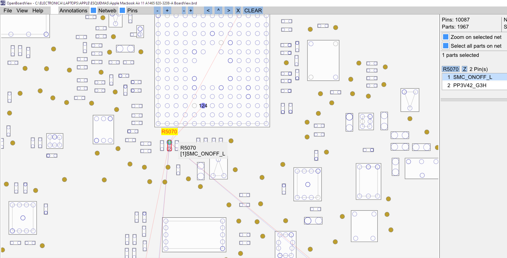

    I have a keyboard problem in this A1465 820-3208 year 2012, but only in power key... the rest of keys are fine... the mac starts to boot and turns itself off because the power button is almost all the time or intermitently pressed/stucked i think.... sometimes it ask you "are you sure you want to shut down /...." ... of course tested with external keyboard and is ok///
    question is, can I void/stop the power button operation? maybe at R5015 or R5016? avoid going GND.... and figure a way to turn on the mac through attaching the charger and auto start, and turning off via the system macos shutdown? thanks in advance!!

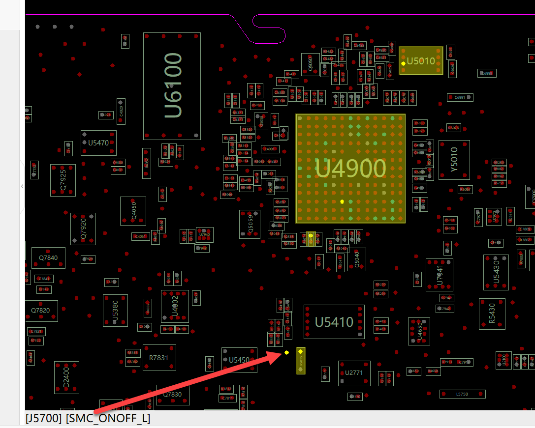

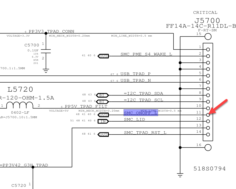

    1) See attached. Start with connecting the keyboard / trackpad.
    Meter in DC volts (20V scale is ok).
    Measure and post the voltage @ pin 11 of connector J5700.
    This is your ON/OFF switch from the keyboard.
    Is it stuck LOW ?
    Update:
    Remove all power. Remove battery connector. Remove the keyboard & trackpad cable. Then apply the adapter only and use tweezers to short the pads @ R5015. This will act like your ON/OFF switch. Does the logic board remain ON and stable ? If not, there is some other fault that needs to be reviewed.
    2) Check for any debris on J5700. Remove all power and use a Q-tip & alcohol (IPA) to clean up the solder contacts of J5700. Perhaps something else is causing this short condition.
    3) If pin # 11 of J5700 is indeed stuck to be always 'ON' = LOW condition due to a stuck key on the keyboard, then you will have to consider to cut the PCB trace from pin # 11 of J5700. If you decide to do this, consider to locate a part of the PCB trace where, if needed, you can fix this trace again in the future.
    Scrap off the black solder mask that Apple loves to use so you can see the copper trace -> measure the copper trace again to confirm you are dealing with the SAME trace as required.
    Only then, cut the trace and test again.
    With the trace being cut, there is a pull-up resistor @ R5070 & a capacitor @ C5734 that should act like a 'power on ON/OFF' switch. Not confirmed but you can test it and post your results.
    First start with the voltage on Pin # 11 of J5700.

      Thanks as always mon2, yes shorting pins turns on normally, ...ok measured pin 11 if lid is closed 0v but if open it is always at 3,4v, even if I press on/off KEY (which in fact turns on/off the macbook, the problem is those sporadic shutdowns ) ... so maybe Im not understanding the problem yet... no debris no water damage...
      so maybe yor 3rd option will have to be done? but no!! because pin 11 is always HIGH not low

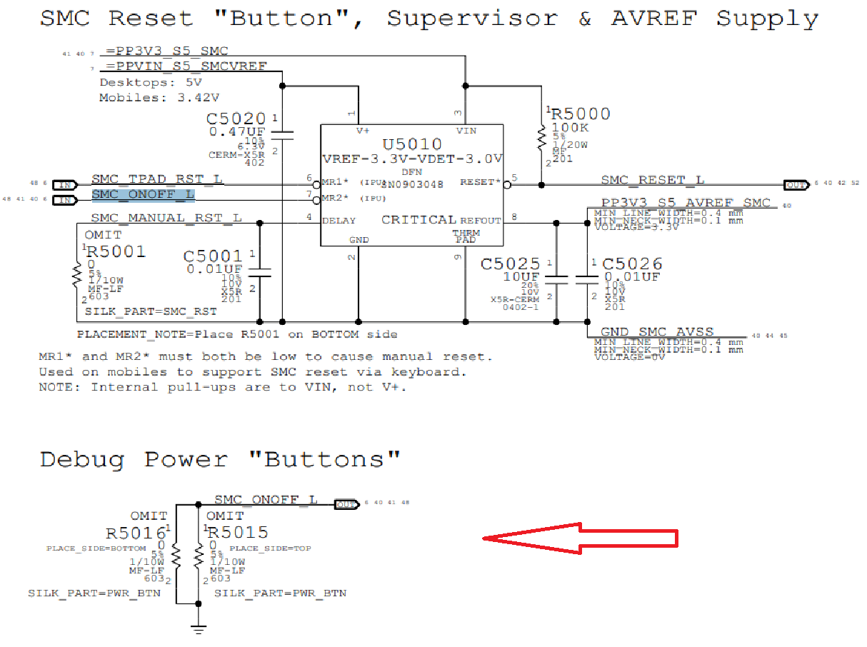

          This is a deja-vu. I recall a similar case and the way it was fixed was to apply ANOTHER resistor @ R5015. The trick is to find a value that will NOT turn it ON but if you close the KEYBOARD switch then, the resistance in the keyboard ON/OFF closure + the new resistor you will add @ R5015 will act together in parallel and perform the task.
          You can experiment and believe someone else in this forum did the same trick about a year ago.
          Google for it or just try 10k to ground on R5015 - for starters. Will see if I can find the same details...
          https://www.allaboutcircuits.com/too...ce-calculator/
          PS: Need to run out for a snow blower ... will check back later. Good luck, I think you are close. Just try different resistor values @ R5015. If the board turns ON with the new resistor, raise the resistor value.

            PD did you mean R5070? because R5015 and R5016 are not present in this board, they are OMIT and only pad pins...(power on pins) or you say to place on the pins?
            Marcelo J
              Re: A1465 Power Button *always on* how to bypass?
              Correct. On R5015 pads which should be blank.
              Start with a 10k resistor there and see if this makes a difference for your case. Experiment with higher values as needed.
                ok 10k did not do anything... button not operating any longer.... will try higher value.

                  8k 10k same result button not working, ......like button shorted to ground
                  12k 15k 20k 25k same symptoms it turns itself off... like button always pressed...
                  PDs
                  a) I did use R5016 pins instead because laptop is with mother, and R5015 is otherside..
                  b) Laptop turns on itslef as soon as I connect the battery and full fan speed and extremly slow keyboard behaviour.. unusable

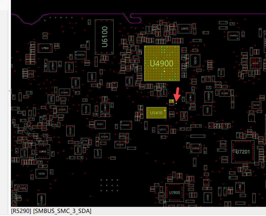

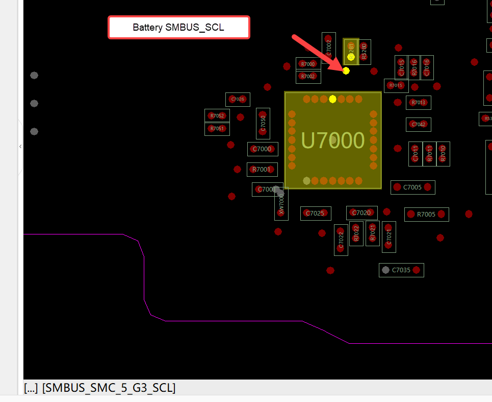

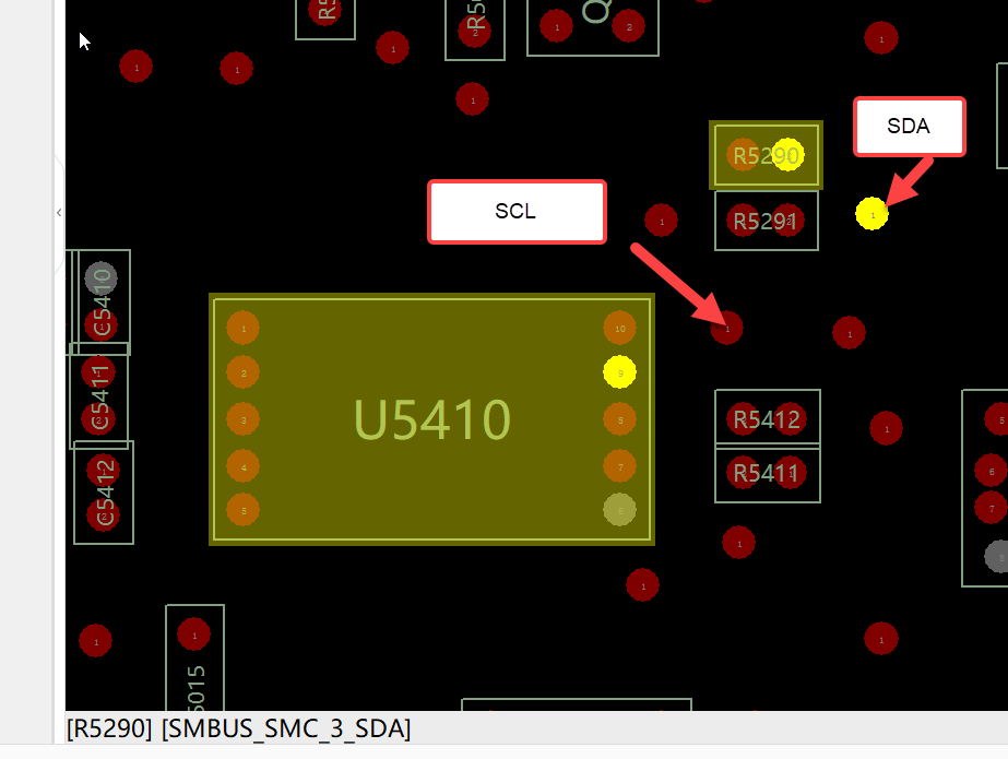

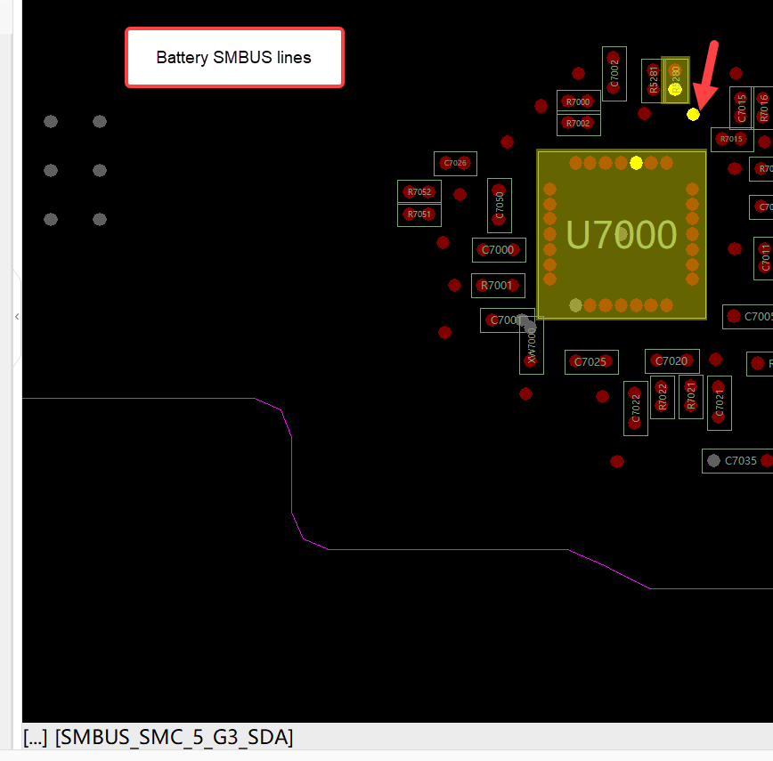

                    You have other issues. See here:
                    https://youtu.be/0oFgu5WwNDU
                    1) Remove all power. Meter in resistance mode (2k scale).

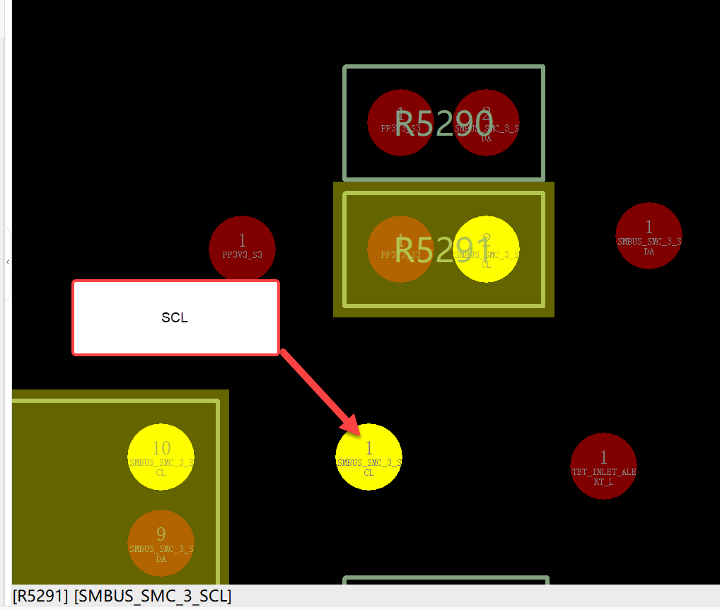

                    2) Measure & post the resistance to ground for the SMBUS_SDA & SMBUS_SCL lines. These lines are used to communicate with the trackpad / keyboard controller and other peripherals. See attached for test points.
                    Also report the measurements for the other SMBUS interconnect used by the battery and other functions.
                    On a good board, the voltage for each SMBUS line should be ~3v3 - ~3v42.
                    3) If the measurements are not of a low resistance to ground then move to the DC volts scale (20V) and measure the voltages on these same points; the SDA & SCL lines. Are they @ ~3v++ for each ?

                      Picture 1: (red probe on ground RES MODE)
                      BATTERY REMOVED: pin 5 of J6950 = your indicated test point, is 125Kohm
                      Picture 2: (red probe on ground RES MODE)
                      BATTERY REMOVED: pin 4 of J6950 = your indicated test point, is 130Kohm
                      Picture 3: (red probe on ground RES MODE)
                      BATTERY REMOVED: pin 9 SCL of J5700 = your indicated test point, is 0.300Mohm
                      Picture 4: (red probe on ground RES MODE)
                      BATTERY REMOVED: pin 8 SDA of J5700 = your indicated test point, is 183kohm
                      Picture 5: (red probe on ground RES MODE)
                      touchpad works fine, no water or damage on connectors not even trackpads or others... battery is brand new, still turning off itself unless external keyboard attached (disconecting kbd from trackpad)... slow to death....
                      Marcelo J
