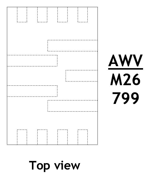

    Hi
    i have a DELL G3 3590 with a burn mark under this chip:
    AWV
    M26
    799
    I can't find exact chip type.
    Need your help
    Thx

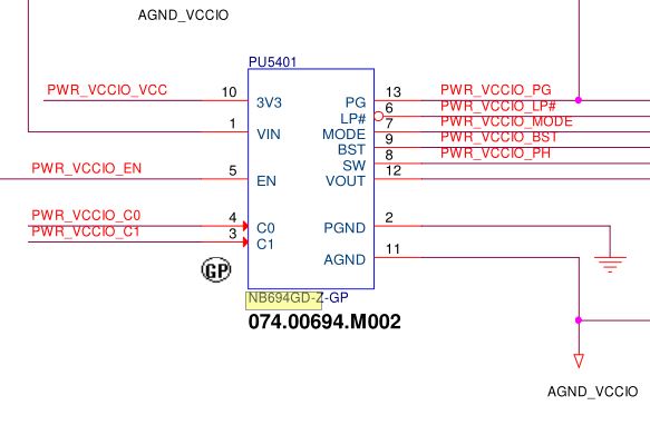

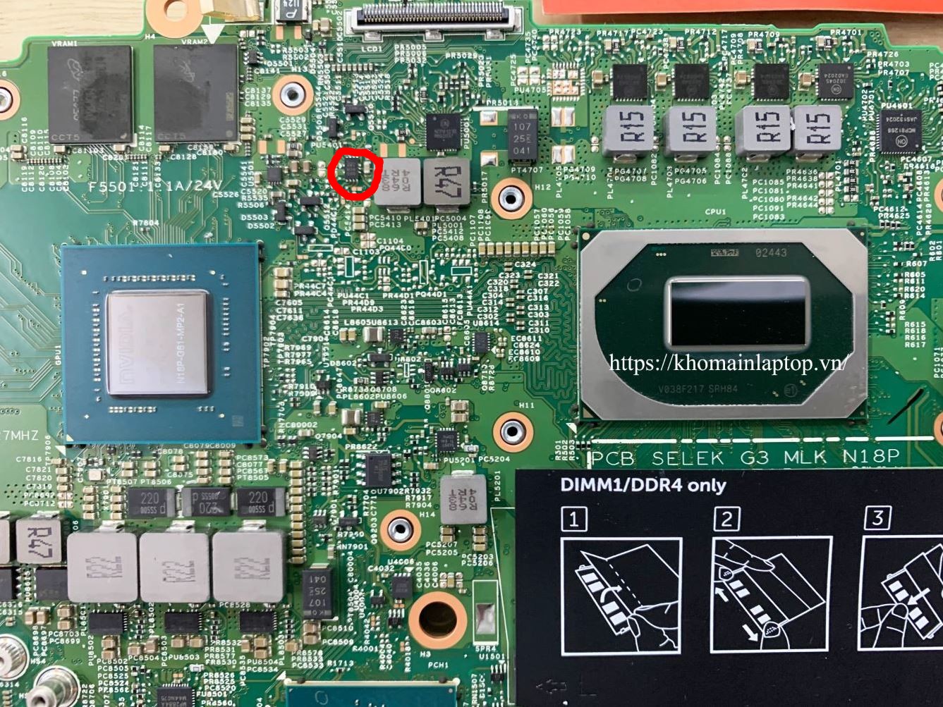

    Re: DELL G3 3590, AWV chip burned
    Sy8286brac
    Update - the chip used by Dell is the above. The 2nd pic in your post does not match what is likely on your burnt part.
    Have you removed the burnt part off the logic board ? When you have, show a pic of the bottom side.
    Fairly confident, you need to source the following part to replace:
    https://www.aliexpress.com/item/3284...rch-mainSearch
      • 21936
      Monolithic power NB694GD-Z
      G3 3590 Schematic https://drive.google.com/file/d/1O2F...8dRV1CQ7O/view

        OMG - both of these vendors have the same markings ??

          Yeah ,it can be very confusing. Usually parts with an horizontal line above the marking code are monolithic power https://www.badcaps.net/forum/showpo...85&postcount=3
